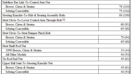

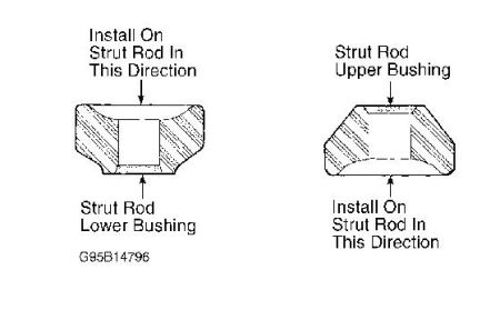

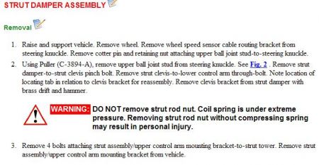

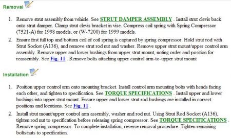

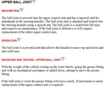

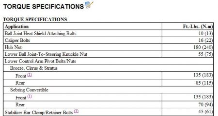

BLUELIGHTNIN6
  • 16,542 POSTS
https://www.2carpros.com/forum/automotive_pictures/261618_Noname_59.jpg
https://www.2carpros.com/forum/automotive_pictures/261618_Noname_58.jpg
https://www.2carpros.com/forum/automotive_pictures/261618_strut_1.jpg
FIGURE 2
https://www.2carpros.com/forum/automotive_pictures/261618_fig2_1.jpg
FIGURE 11
https://www.2carpros.com/forum/automotive_pictures/261618_fig11_1.jpg
https://www.2carpros.com/forum/automotive_pictures/261618_Noname2_22.jpg
https://www.2carpros.com/forum/automotive_pictures/261618_Noname3_12.jpg
https://www.2carpros.com/forum/automotive_pictures/261618_Noname4_5.jpg
Hope this helps..
