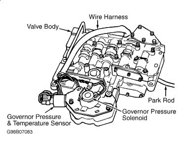

My truck is a V8 four wheel drive with an automatic transmission. Where is the shift solenoid relay located? The truck will not shift into fourth nor first gear. Only has second and third. The code it is throwing is p0753 and the mechanic that pulled the code said the computer said shift solenoid relay which I have found out is aka the governor solenoid. A tech at Aamco transmissions told me the same today. And also said he thinks it is in the transmission pan. Thank you.

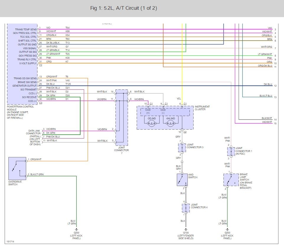

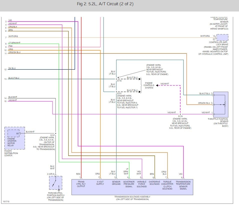

Yes, P0753 is an open or short in governor solenoid/relay. See diagram it is located on valve body. Check wiring and connector for corrosion at the connector. .
https://images.2carpros.com/forum/automotive_pictures/198357_Graphic_427.jpg

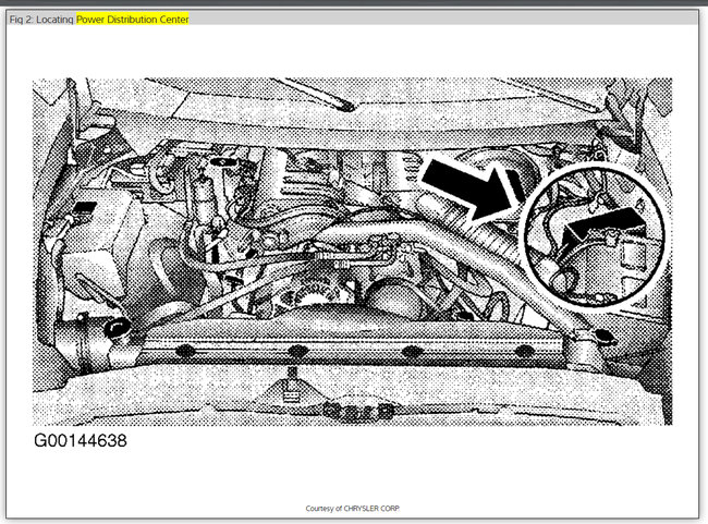

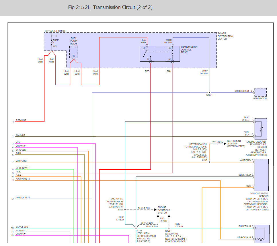

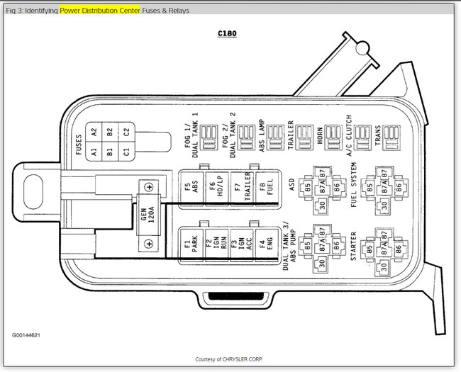

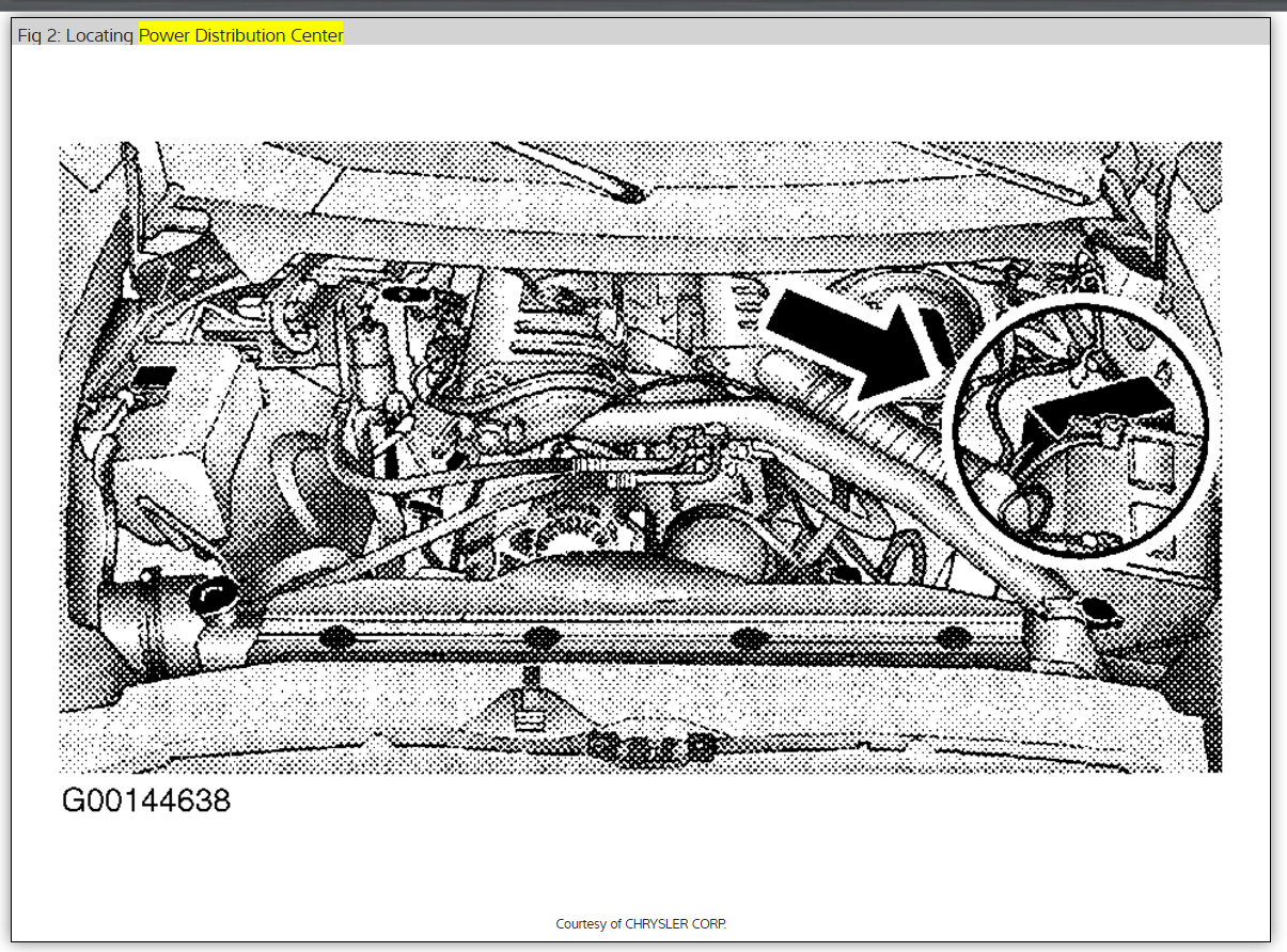

You will need to drop the pan as well. https://www.2carpros.com/articles/how-to-service-an-automatic-transmission There is also a transmission control relay that can cause the transmission not to work right. https://www.2carpros.com/articles/how-to-check-an-electrical-relay-and-wiring-control-circuit Here is a transmission wiring diagram to help you see what you are doing. Please let us know what you find. Cheers

Was there clutch material in the pan, dark pieces or sludge? Any bronze or silver particles in pan? Check brown wire on solenoid plug for voltage, the fuse might be blown.

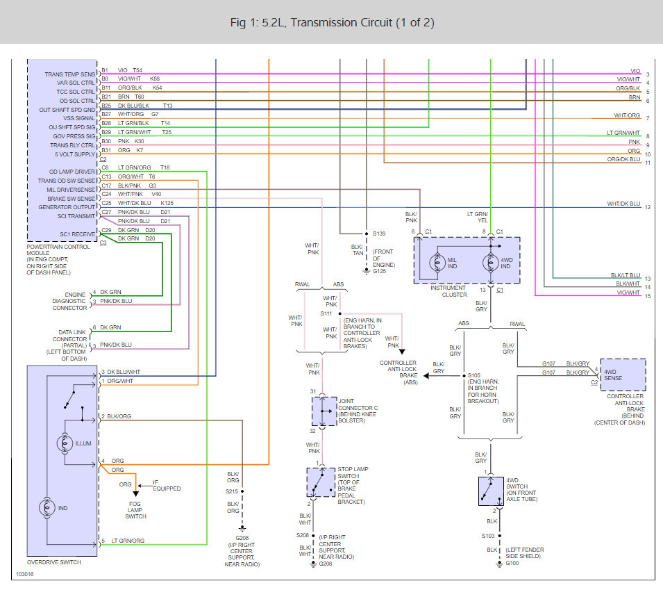

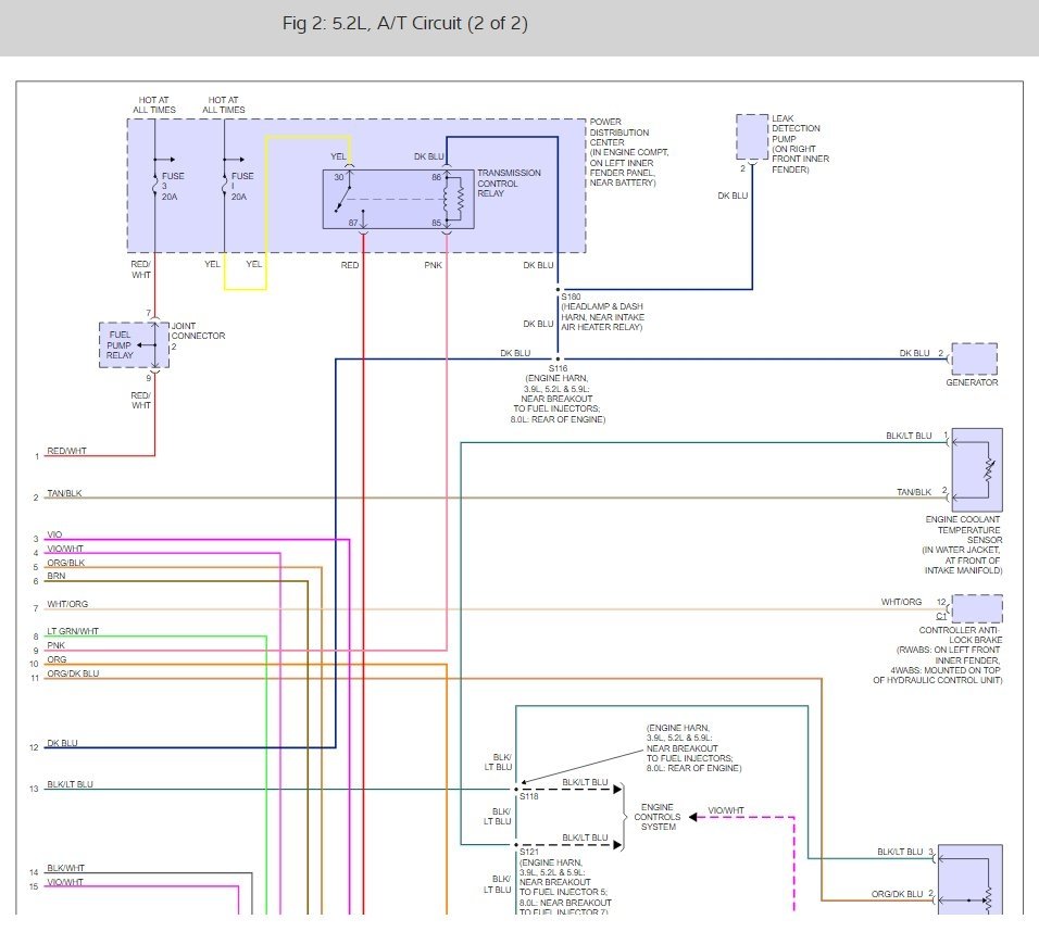

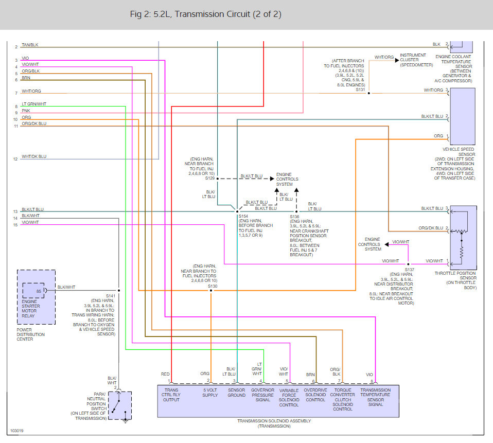

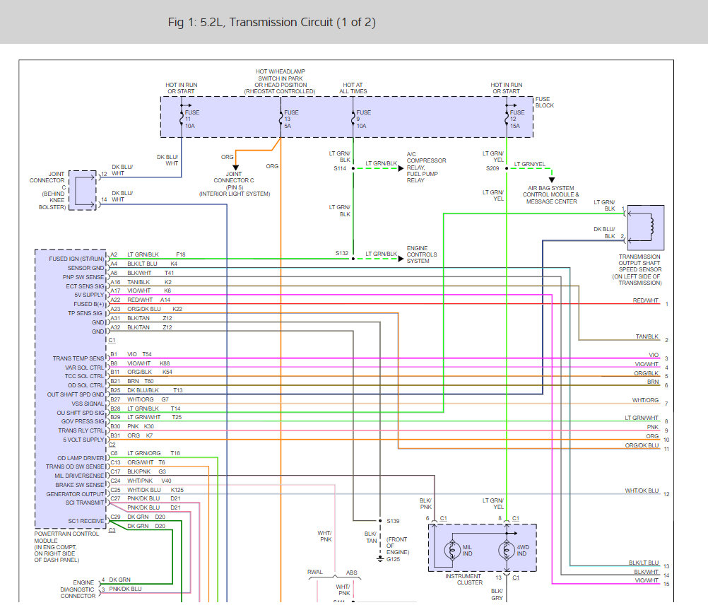

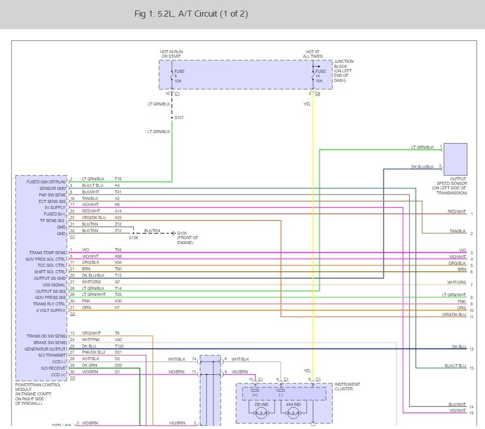

It sounds like you have a shift solenoid that has gone out. Here is a transmission wiring diagram so you can do some testing. Check each solenoid to see if one is way different that will be the bad one.
You also have some fuses and a relay that need to be checked as well
and
Please run some tests and get back to us so we can continue helping you.
