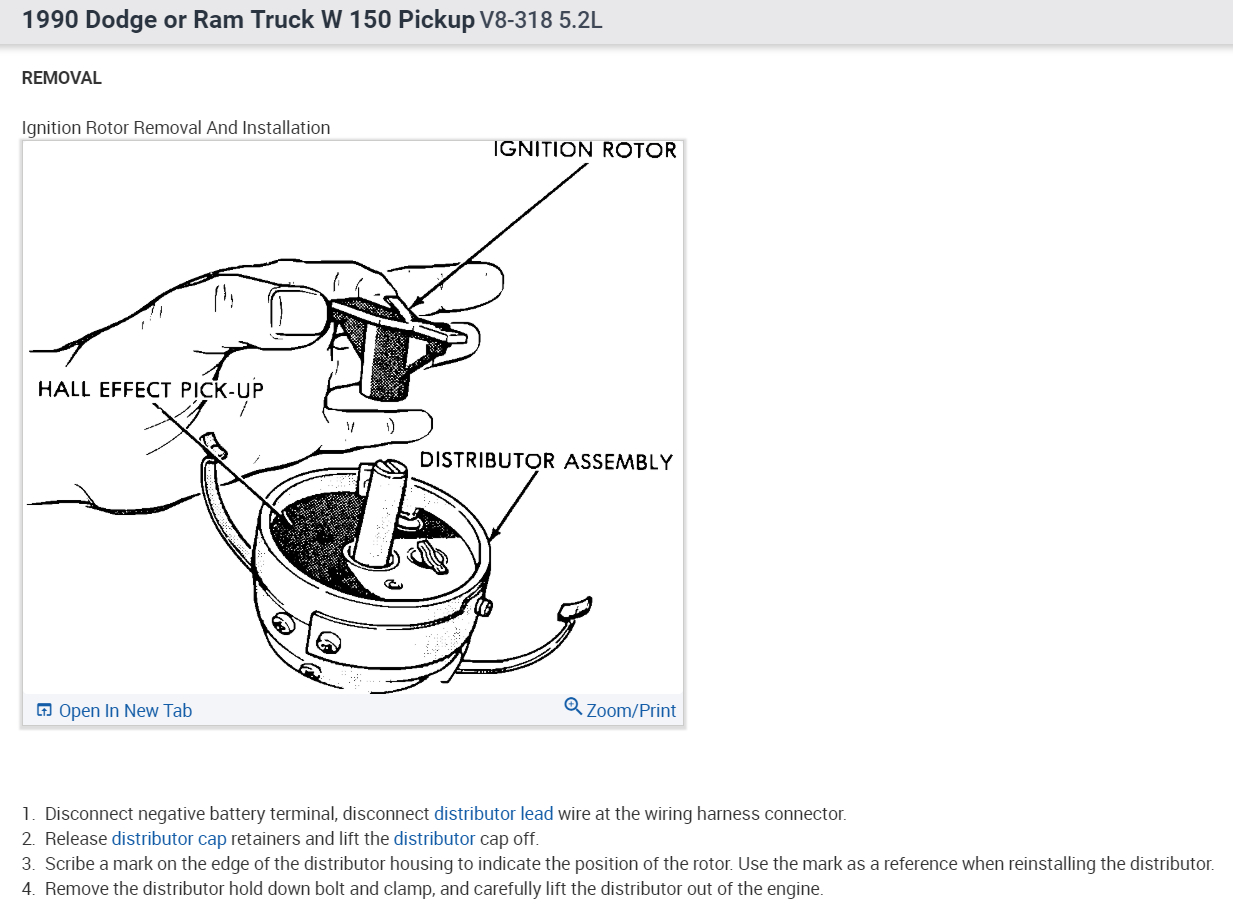

My truck wont start it was running fine with no problems I went out to start it and all it did was crank over but never did fire. I checked for spark at the distributor by pulling the coil wire and cranking the engine over and got no spark. I replaced the coil with a new one but still no spark. Its not even trying to fire I poured gas direct in the carb still no start it has to be electrical but where do I go from here its hard to believe something just quit with no sign of going bad it has never not started for me. I am a car guy from way back but dont do well with trying to find electrical problems can you give me some direction of where to look and what to replace.

This sounds like the crankshaft position sensor (hall effect) when out they do out all the time in these trucks but to be sure run down this guide and check out the diagrams below.
Check out the diagrams (Below). Please let us know what you find. We are interested to see what it is.

Thank you for this post I got a new distributor from Rockauto cost me $76.00 runs like a champ! I love this site.
