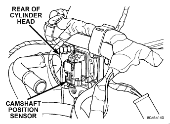

Where is the cam shaft censor on this car and how would I replace it?

Camshaft Position Sensor
https://www.2carpros.com/forum/automotive_pictures/12900_cm_1.gif
The camshaft position sensor is mounted to the rear of the cylinder head.
1.Remove brake booster hose and electrical connector from holders on end of cylinder head cover and reposition.
2.Disconnect electrical connectors from camshaft position sensor.
3.Remove camshaft position sensor mounting screws. 4.Remove sensor.
5.Loosen screw attaching target magnet to rear of camshaft.
INSTALLATI0N
The target magnet has two locating dowels that fit into machined locating holes in end of the camshaft.
1.Install target magnet in end of camshaft. Tighten mounting screw to 3.4 Nm (30 in. lbs.) torque. Over torquing could cause cracks in magnet. If magnet cracks replace it.
2.Install camshaft position sensor. Tighten sensor mounting screws to 9 Nm (80 in. lbs. ) torque.
3.Place brake booster hose and electrical harness in holders on end of valve cover.
4.Attach electrical connectors to camshaft position sensor.

Where does the camshaft position sensor go on the car.

Back of the engine Check out the diagrams (Below). Please let us know if you need anything else to get the problem fixed.
