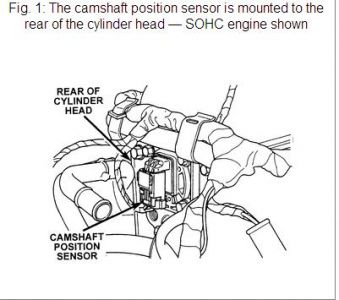

I need to know how easy it is to fix a camshaft position sensor, and where it is located in the car?

Hello, should be located on the rear of cylinder head. The code doesn't tell you what to replace, only that the computer thinks there is a problem on that circuit. I have heard of the crank or cam sensor causing a code to set for the other sensor. You probably need to check both.

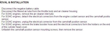

https://www.2carpros.com/forum/automotive_pictures/170934_neon_camshaft_sensor_1.jpg
https://www.2carpros.com/forum/automotive_pictures/170934_neon_cam_sensor_11_1.jpg
Doesn't look too hard to me.
