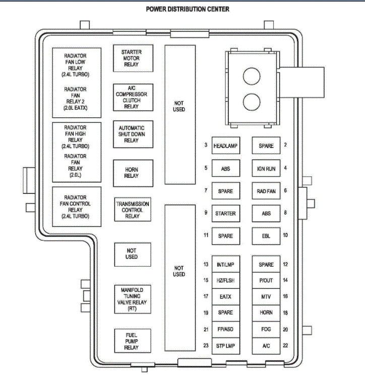

Where are the fuses and panels for my car? I have a HVAC problem I am trying to solve.

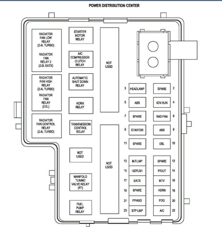

If you look at the attachment below, it provides the fuse box orientation and what each fuse is for. The fuse box is under the hood on the left side of the engine compartment.
In addition to just checking a fuse, make sure there is power to it. A fuse may be good and not be receiving power.
