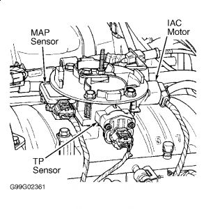

Get a couple feet of small dia. tubing. Place one end to ear the other at throttle body is whistle comming from plate area or in IAC opening? see diagram

The sound seems more like it is coming from the outside around the throttle body not from the iac. I took the car to the shop they stated they will have to change the throttle body. I am a little weary of spending any extra money even if it is just for the part.

See the four bolts remove pull up throttle and see if gasket is broken

Could not remove the throttle body, it seems like it has been glued down with some black rubber like substance. Is this normal? I believe the shop may have done this.

No not normal is it like RTV? Can you get a putty blade into it?

I did manage to lift it, and the gasket is not broken.

Clean surfaces install new gasket torque to 17 ft. Lbs. In an X pattern
