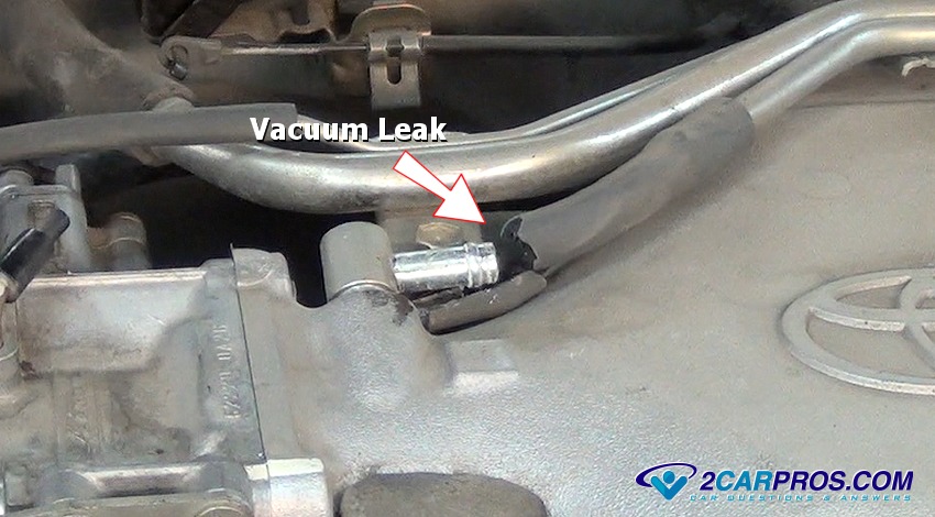

Vacuum is present when the engine is running and is at its strongest point when the engine is idling. This will generate various whistling noise pitches as the engine changes rotational speed. Lift the hood to inspect the engine vacuum line routing hoses to the different accessories such as the brake booster and EVAP system. Repair the vacuum leak as needed.
vacuum leak

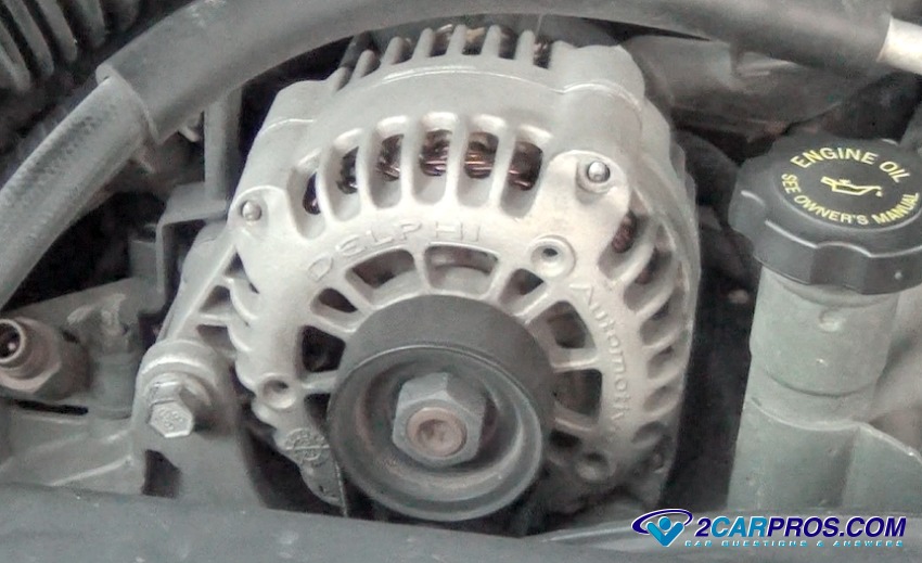

The alternator is designed to recharge the battery and keep electrical power supplied to the vehicle when in operation. If the alternator is starting to go out or if it is being overworked by high resistance caused by dirty battery cables or a bad battery it can create whistling noise. To repair this issue start by cleaning the cables and checking the battery. If everything checks out, replace the alternator.
alternator whistle

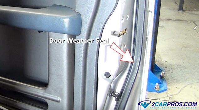

When a door or window seal fails it can create a whistling noise as air enters and passes through the passenger compartment, it helps to have someone in the car with you to help find the origin of the noise, inspect the door or window seal in that area and replace or repair as needed.
door weather seal

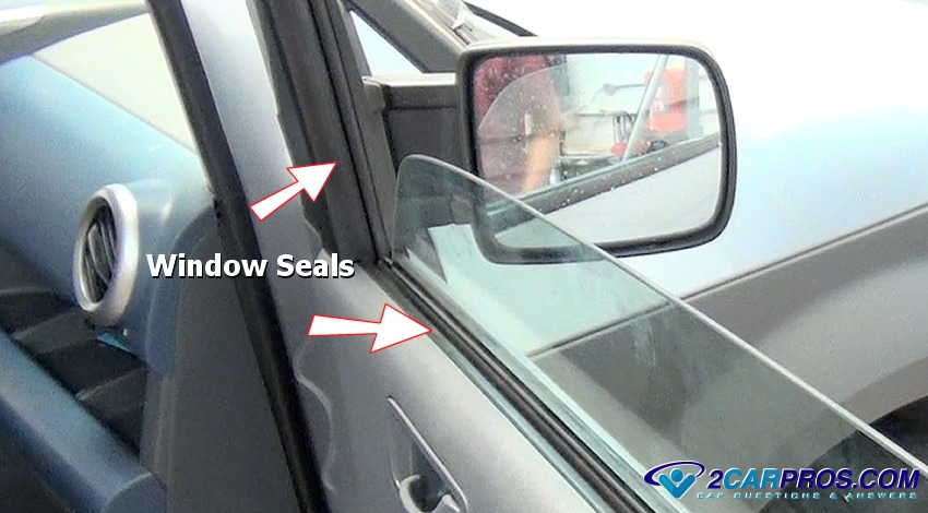

A window seal has a top, bottom, front and rear sealing points, while traveling and the noise is being generated use your fingers against the seal to try and stop the noise this will let you know the location of the defect. In most cases the window seal will need to be replaced.
window seal
