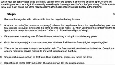

last week took it to work, was starting fine, went to leave work and the battery was dead, had the battery checked it tested fine, cleaned the battery terminals. After charging the battery, and letting it sit overnite the battery is dead again.

Do a battery drain test-see parastic draw below:
https://www.2carpros.com/forum/automotive_pictures/12900_battery_drain_test_1.jpg

Thnx for the info I found the problem, the back window wiper was stuck 1/4 of the way up and wasn't disengaging from the battery and draining it overnite
