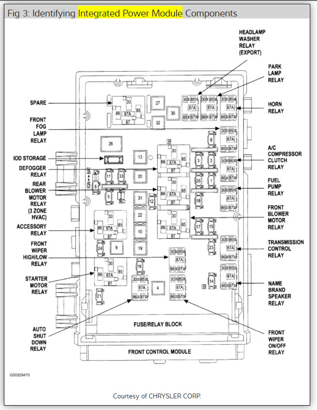

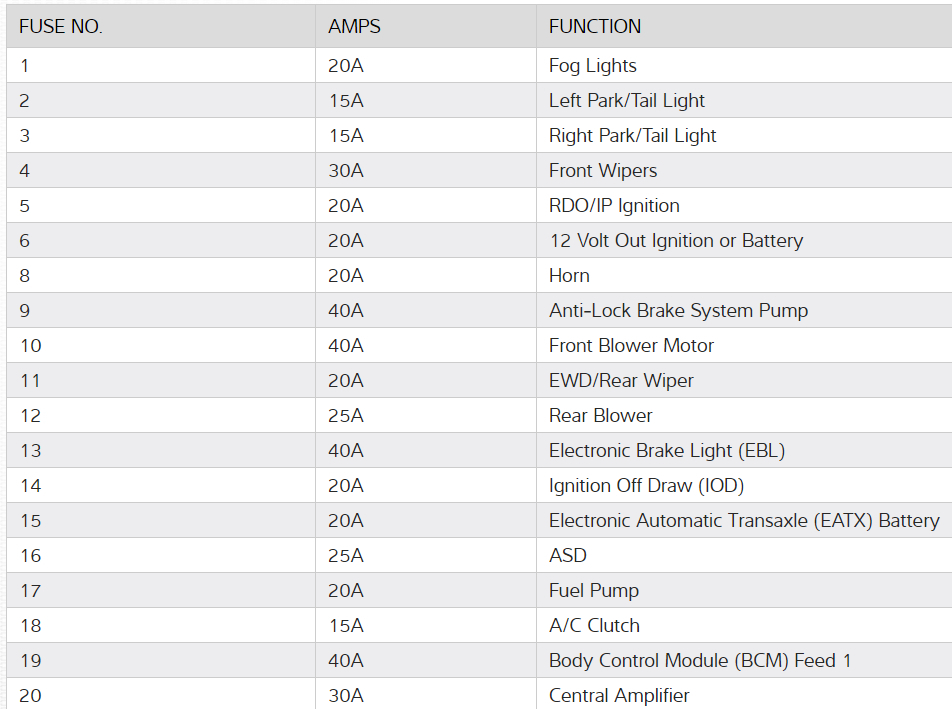

I have been unable to locate the interior fuse panel. The one under the hood doesn't have what i'm looking for. One of the power side doors is not working and I wanted to check the fuse but was unable to locate the panel. Can you tell me where it is located?
Saturday, November 8th, 2008 AT 11:34 AM
15 Replies
KEN L
  • MASTER CERTIFIED MECHANIC
  • 55,469 POSTS

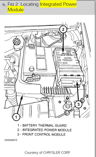

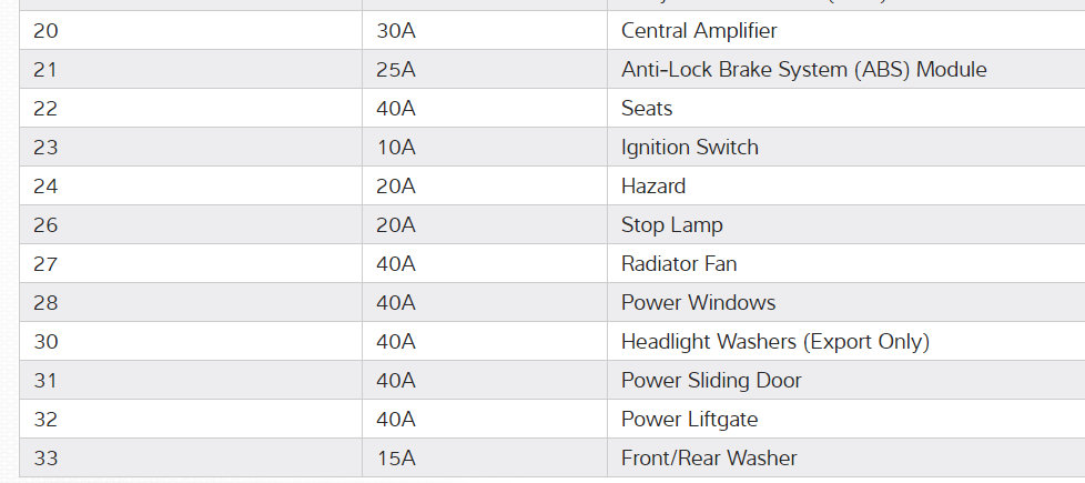

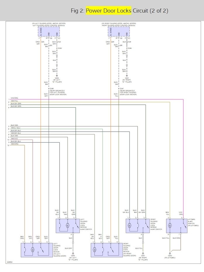

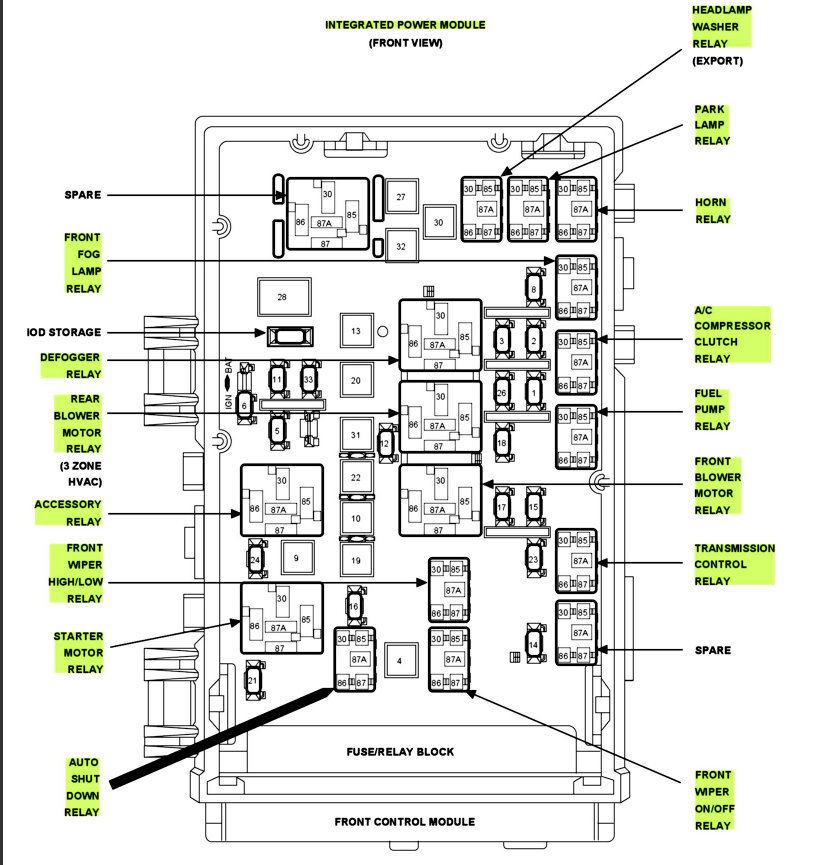

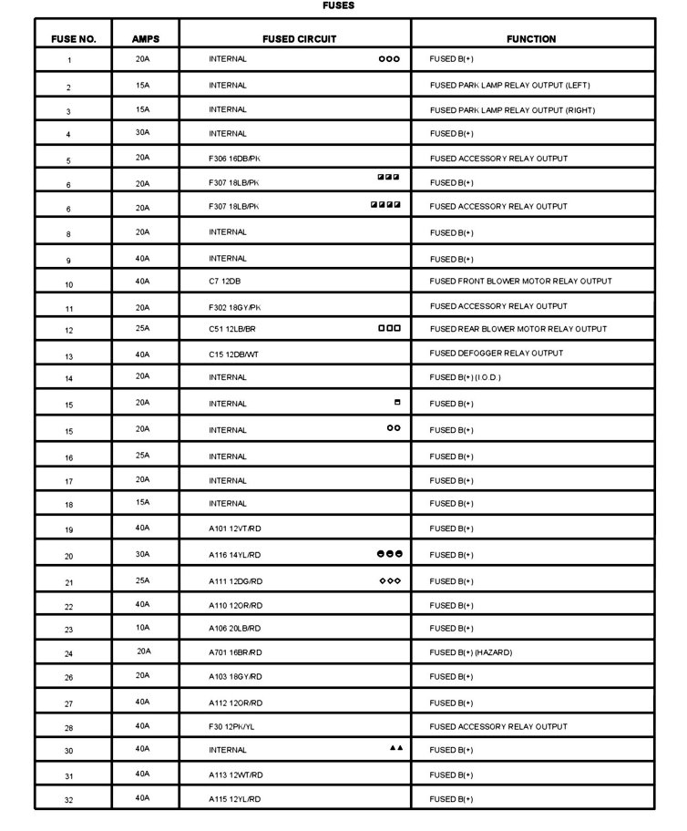

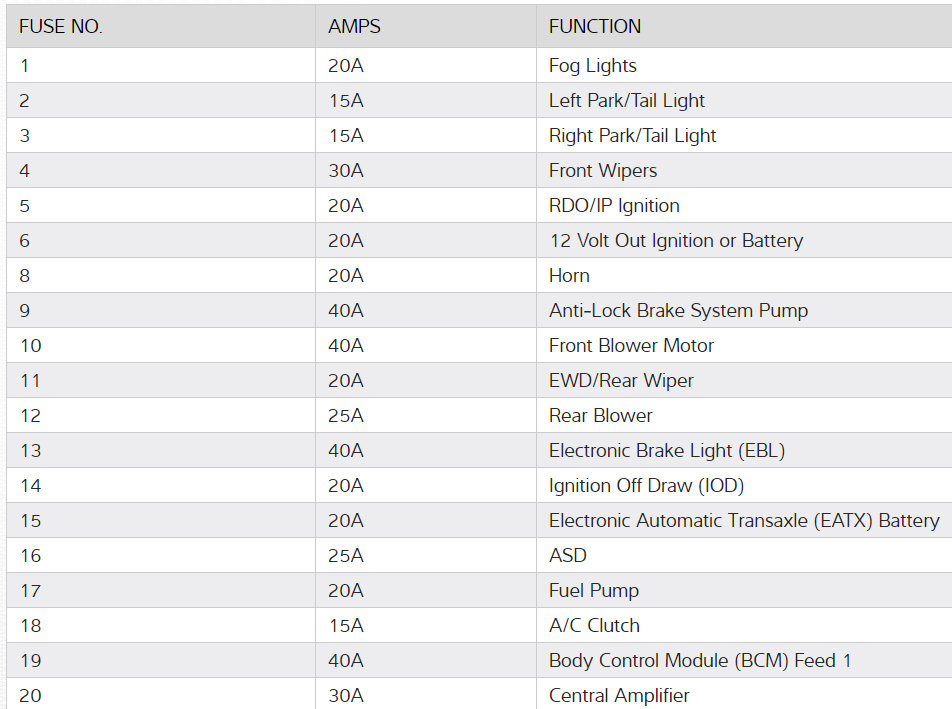

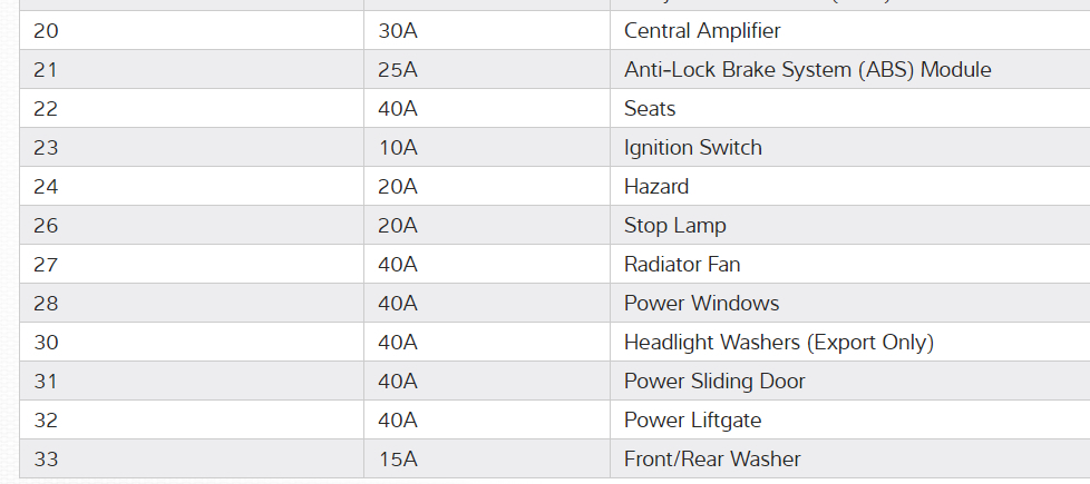

Hello again, It looks like the sliding door is powered by the BCM which has its fuses under the hood, I found these diagrams for you, please get back to me so it will help others.
But if just one door is not working it is the fault of the door motor or switch not the power system.
1 20A Fog Lights
2 15A Left Park/Tail Light
3 15A Right Park/Tail Light
4 30A Front Wipers
5 20A RDO/IP Ignition
6 20A 12 Volt Out Ignition or Battery
8 20A Horn
9 40A Anti-Lock Brake System Pump
10 40A Front Blower Motor
11 20A EWD/Rear Wiper
12 25A Rear Blower
13 40A Electronic Brake Light (EBL)
14 20A Ignition Off Draw (IOD)
15 20A Electronic Automatic Transaxle (EATX) Battery
15 25A ASD
17 20A Fuel Pump
18 15A A/C Clutch
19 40A Body Control Module (BCM) Feed 1
20 30A Central Amplifier
21 25A Anti-Lock Brake System (ABS) Module
22 40A Seats
23 10A Ignition Switch
24 20A Hazard
26 20A Stop Lamp
27 40A Radiator Fan
28 40A Power Windows
30 40A Headlight Washers (Export Only)
31 40A Power Sliding Door
32 40A Power Liftgate
33 15A Front/Rear Washer

Here is a guide and the fuse panel diagram below.
What does it do when it wont start? Does it crank? or it does nothing? Try self diagnostic and post any codes it displays. turn ign off , hold trip reset button and turn key on. after five seconds remove key and continue to hold reset button for five seconds. after five seconds release button and self diagnosis will start.
2. After DTC display ends, instrument cluster will go into each of the following tests in order: dim test, calibration test, odometer segment test, and electronic transmission range indicator segment test. Go to DIM TEST
Saturday, September 19th, 2020 AT 5:48 PM (Merged)
MERLIN2021
  • 17,250 POSTS

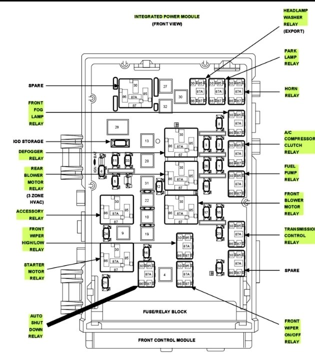

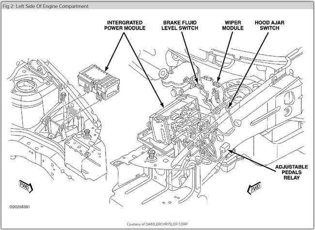

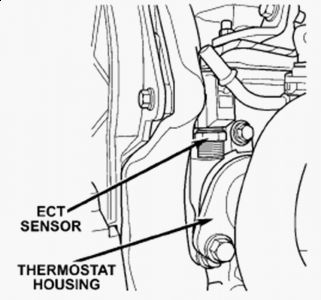

So it does nothing correct? Did you try the self test? Check ASD relay in the integrated power module. Swap it for a known good relay. Power mod is on the left side of the engine bay. Also can be crank sensor signal is lost. This is on the tranny bell housing, you need to remove shift cable to access it. Check out the diagrams (Below). Please let us know what you find.
BUTCHERBAY
Ran diag check. Eroor code 50f 8.2 or Sof 8.2(not sure) displayed. Swapped ASD and starter relay.

OK thats showing the software version, if it can be driven, get the codes read by a code reader, Autozone reads them for free. Post what they find, but a hit or miss might be the ECT.

I can't find the fuse box. My cigarette lighter outlets are not working.
-1
WRENCHTECH
  • 20,761 POSTS
They are powered by fuses 5 and 6 in the under hood fuse box.

Electrical problem 6 cyl Two Wheel Drive Automatic 100000 miles
radio and lighter does not work? Replace fuse and radio still didn’t work. The lighter works and the time will come on and then goes off. Is another fuse that can cause problems or a relay or a fusible link?
-1
Saturday, September 19th, 2020 AT 5:49 PM (Merged)
KEN L
  • 55,469 POSTS
Look inside the integrated power module, under the hood. Fuse 5--20amp, also check that the fuse circuit is hot. The lid may have the fuse labels on it. RDO/IP IG

Where is the fuse box for the radio ect. Found the one under the hood.
Monday, September 21st, 2020 AT 10:21 AM (Merged)
KEN L
  • 55,469 POSTS

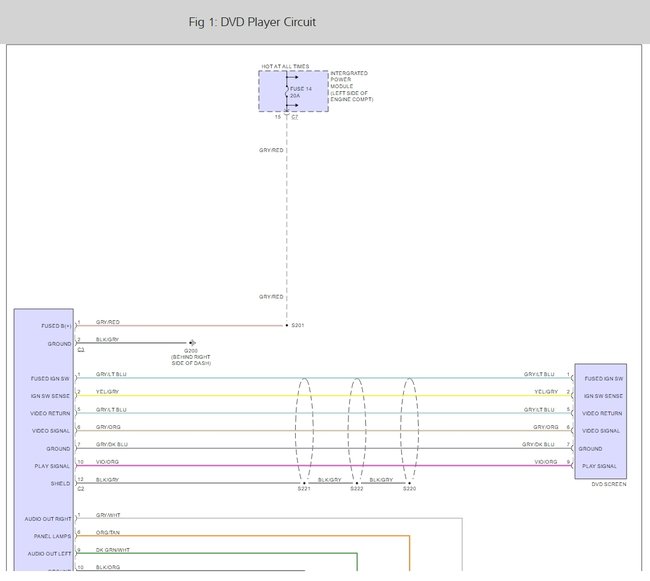

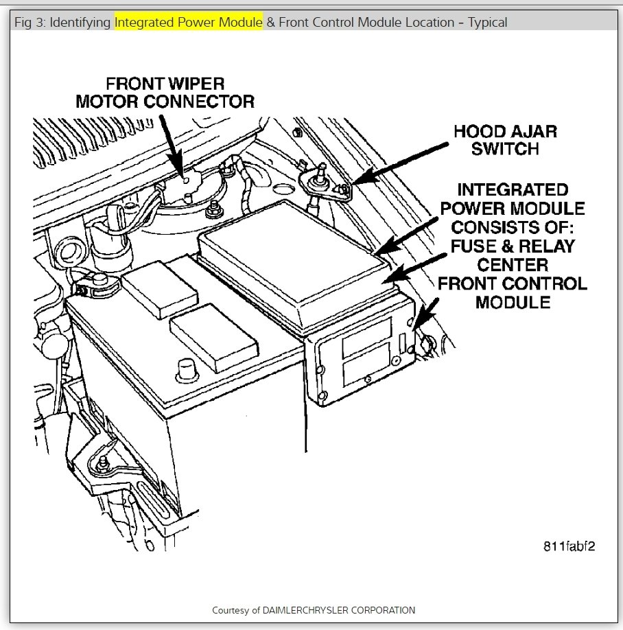

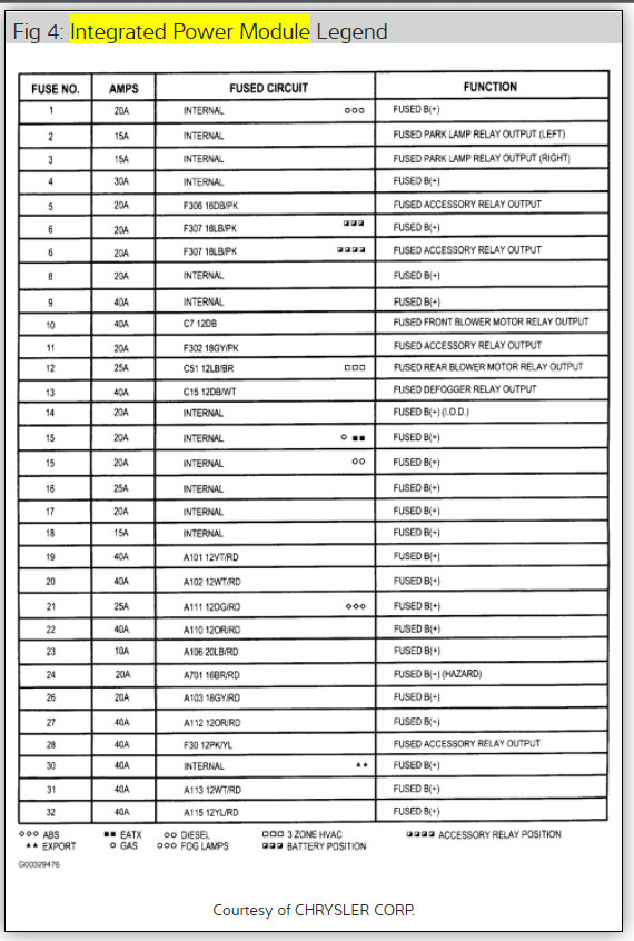

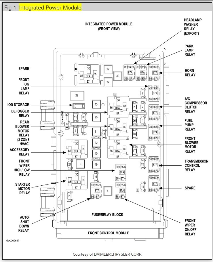

Hi Everyone!
Yes I have found this diagram for you that shows the only fuse panel being under the hood. The radio fuse is number #14 in the right lower comer of the fuse box
Here is the wiring diagram for you so it can help with the repair you can SEE it is #14 in the under hood fuse box.
Let us know if you need anything else, we are here to help at 2CarPros
Best, Ken
check the images below!

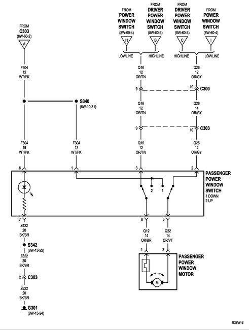

J'ai un dodge caravan se 2003 et je cherche la boite à fuse intérieur pas elle qui est dans le hood je cherche les fuse pour les fenà tre.
I have a Caravan dDodge 2003 and I am looking for the box fuse inside her not in the hood I am looking for fuse for the window.
Monday, September 21st, 2020 AT 10:22 AM (Merged)

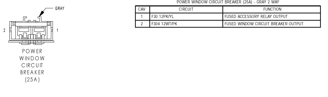

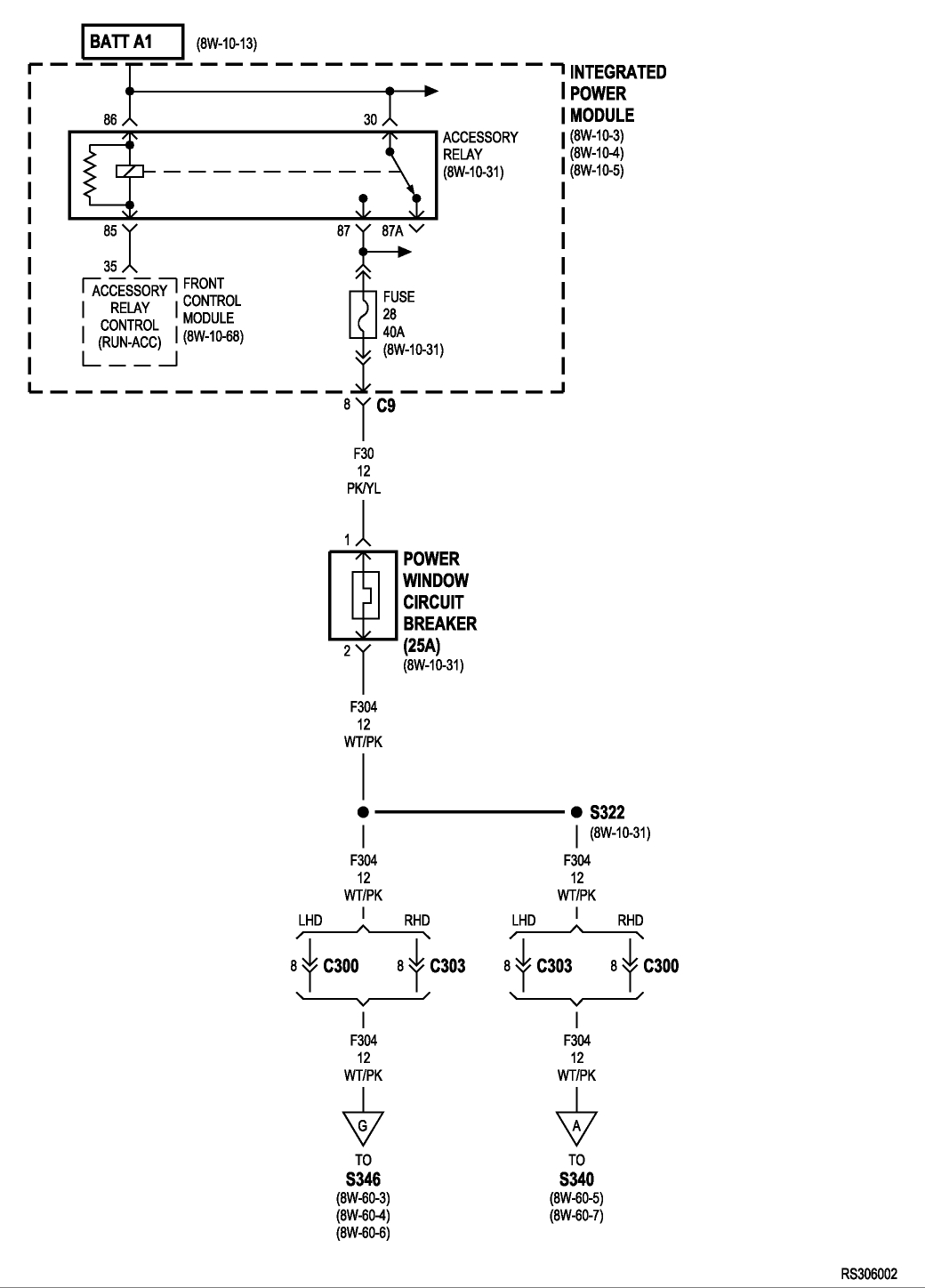

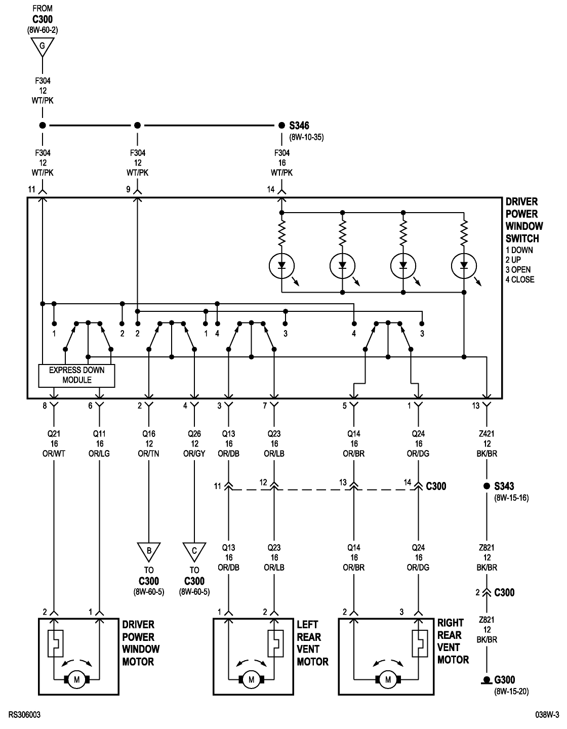

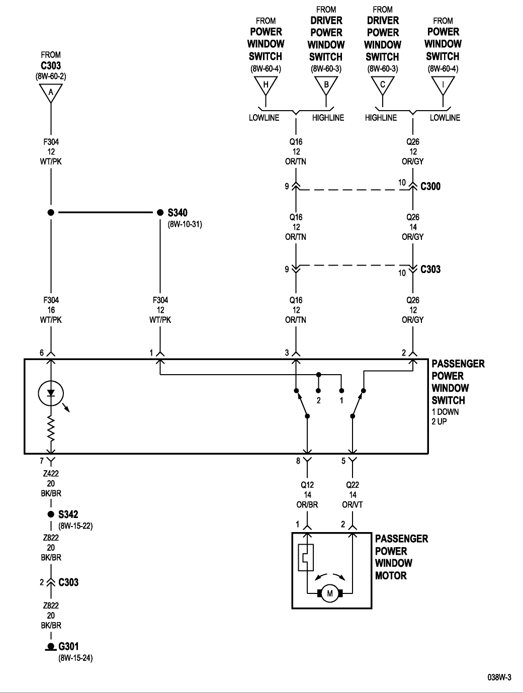

STEVE W.
  • 15,694 POSTS

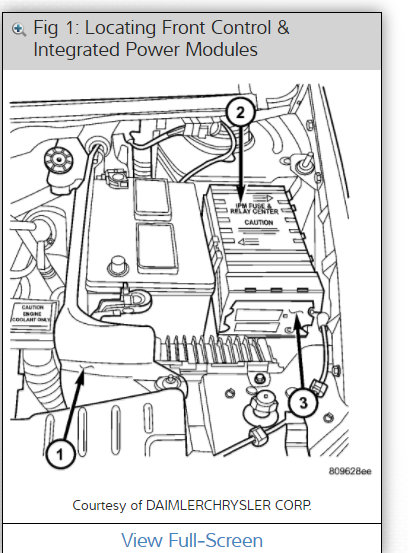

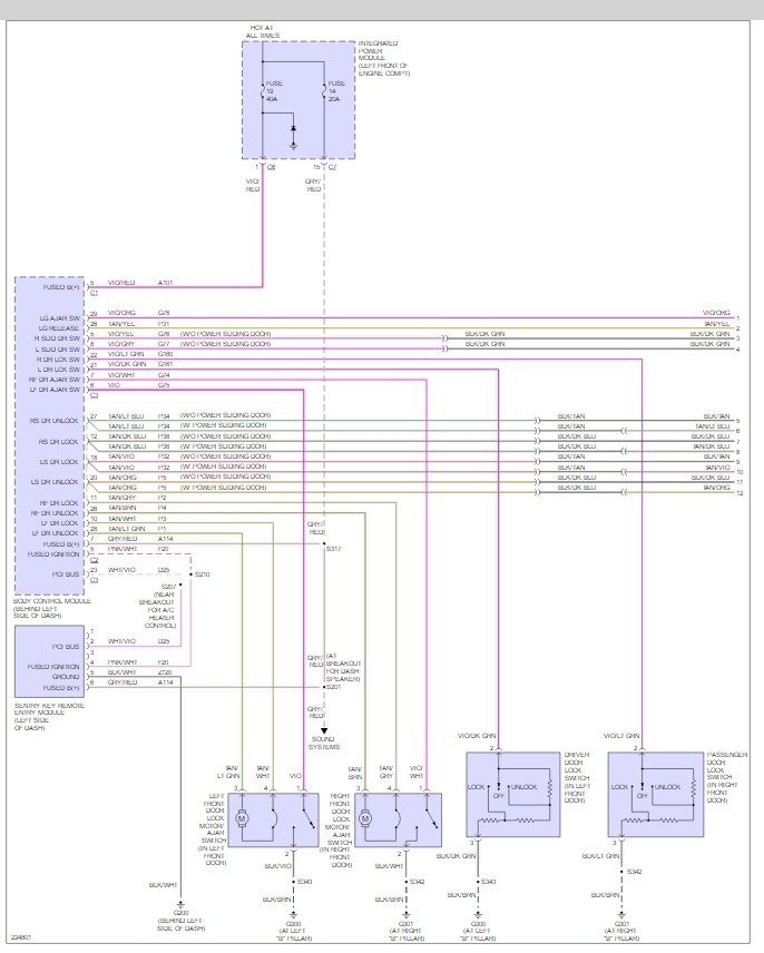

There is a 40 amp fuse in the under hood box #28. That feeds a self resetting 25 amp circuit breaker. Which then feeds the window switches. The main power relay is part of the IPM and not replaceable. The circuit breaker is under the dash near the steering column.
There are no other fuse boxes than the front IPM located under the hood.
Il y a un fusible de 40 amperes dans la boite sous le capot # 28. Cela alimente un disjoncteur a rearmement automatique de 25 amperes. Qui alimente ensuite les commutateurs de fenetre. Le relais d'alimentation principal fait partie de l'IPM et n'est pas remplacable. Le disjoncteur est sous le tableau de bord pres de la colonne de direction.
Il n'y a pas d'autres boites a fusibles que l'IPM avant situe sous le capot.
