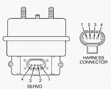

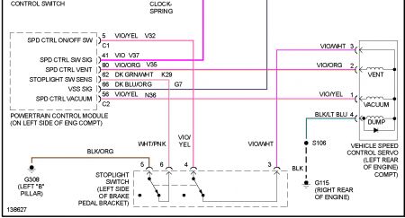

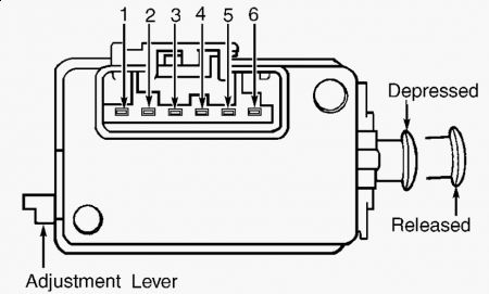

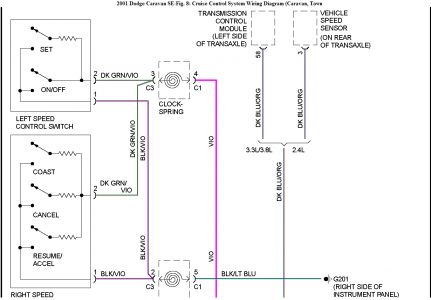

JOJO1447
  • 2001 DODGE CARAVAN
  • 6 CYL
  • 2WD
  • 163,000 MILES
I have a 2001 dodge caravan 3.3 g-flex. Recently I've been having a hard time starting the van. I will have to push down on the pedal for a few seconds until it starts then runs fine. I smell gas coming out the tailpipe, and am going through the gas mileage. My obd 2 code says a speed control circuit. My uncle said it probably is the Idle control valve. I would like your opinion if you don't mind!
Friday, November 22nd, 2019 AT 7:06 PM (Merged)
MERLIN2021
  • 17,250 POSTS
What code is it giving you? Speed control circuit is the idle air control circuit, A bad IAC will give hard starting problem, but so will an out of range TPS(throttle possition sensor).
-1
JOJO1447
Its giving me a P1595 code. I did put a brand new TPS in just two days ago, I forgot to mention that, Sorry! No change.
