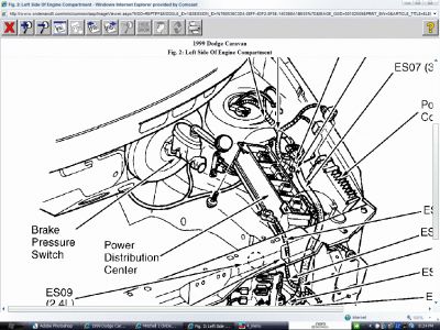

1999 Dodge Caravan V6 Automatic 150000 miles
Horn won't honk. Fuses okay.
Dec 8, 2007 at 6:42 PM
MERLIN2021
  • CAR REPAIR CONTRIBUTOR
  • 17,250 POSTS
check the relay in the power ditribution center under the hood on drivers side. also if you have a test light hook it up to the horn lead, press the horn, does it light? if yes the horn needs to be changed...check horn fuse in the car...
https://images.2carpros.com/forum/automotive_pictures/62217_pdc_1.jpg
Dec 8, 2007 at 7:27 PM
BIGEEE
99 Dodge Caravan, 172000 miles, 2.4L - 4 cyl
I have checked the horn switch & it indicates working. Switched horn relay with adjacent relay, no horn. Checked fuses, no bad fuses. Pulled horn, horn works. No power to horn. Any ideas?

IF YOU SCAN THE VAN FOR AIR BAG CODES YOU WILL DISCOVER THAT THE CODES WILL HELP YOU WITH THE HORN .
ON THEM DODGES THE PROBLEM IS ONE
CLOCKSPRING UNDER THE AIR BAG
GOOD LUCK
LET US KNOW
