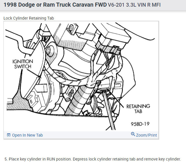

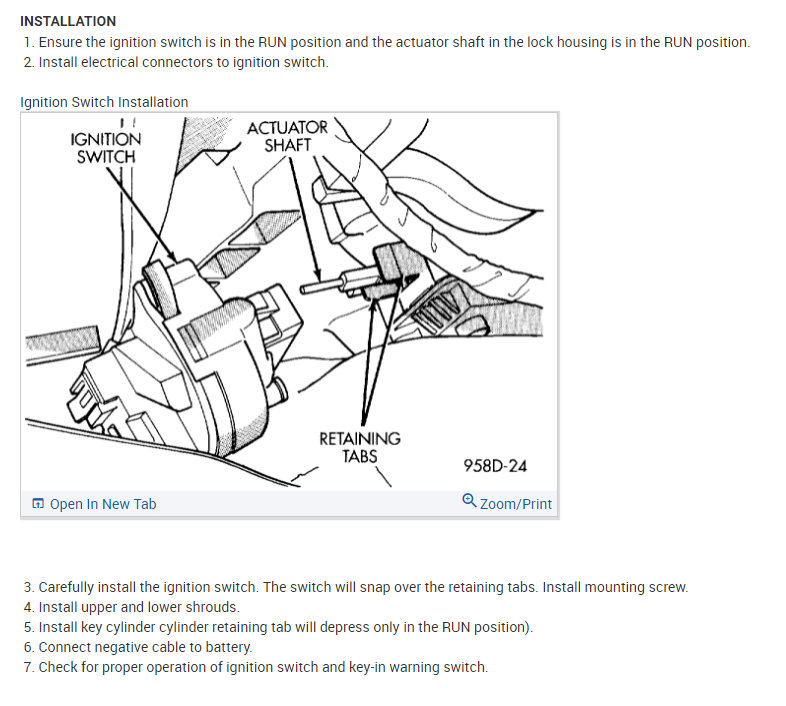

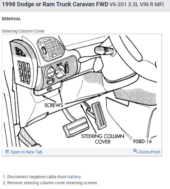

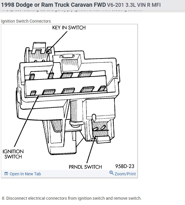

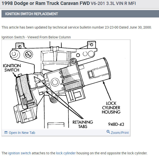

This issue you are motioning sounds like faulty ignition switch. However since you have already have that replaced, it could a issue with the wiring for the ignition switch.

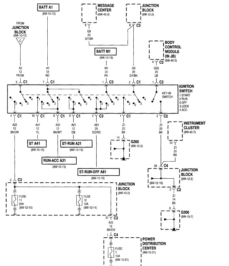

As you also experience the dash gauge outage it points to a wiring issue.
You will have to trace the wires to find the issue. It could be weak ground or a wire that could be corroded.
Here is a helpful article on how to check wiring:
I have included the wiring schematics for your reference.
