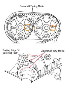

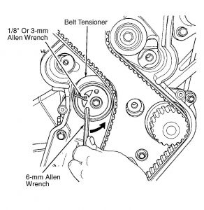

How do you remove a timing belt, and reassemble?
Friday, February 29th, 2008 AT 12:58 PM
BMRFIXIT
MECHANIC
19,053 POSTS
Raise and support the van
remove and or disconnect
front right wheel
inner splash panel
accessory belts
crankshaft pulley
alternator idler pulley
lower timing cover
upper belt cover
purge duty solenoid
right motor mount
