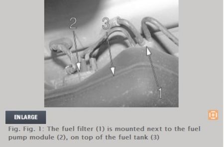

i need a picture of the gas tank of a 97 dodge caravan.
looking for the fuel filter.

Hello, three different sources gave me different locations for that filter. The picture came from the autozone site. The online partsbook shows the lines come with the new filter, you don't take the lines loose from the filter, take loose from the other end. Make sure there is no pressure on the system, before taking anything loose.
