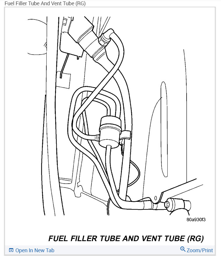

I keep getting a back pressure overflow when putting in gas. I can run a line all the way down the neck so I know thats not clogged. I had some sputtering when started a few weeks ago and then all of a sudden the problem stopped and was able to fill tank with no problems. Now today it sputtered again when starting and I could only get 1.5 gallons in without it spitting out.
Saturday, January 3rd, 2009 AT 11:44 AM
18 Replies
  • 110,182 POSTS

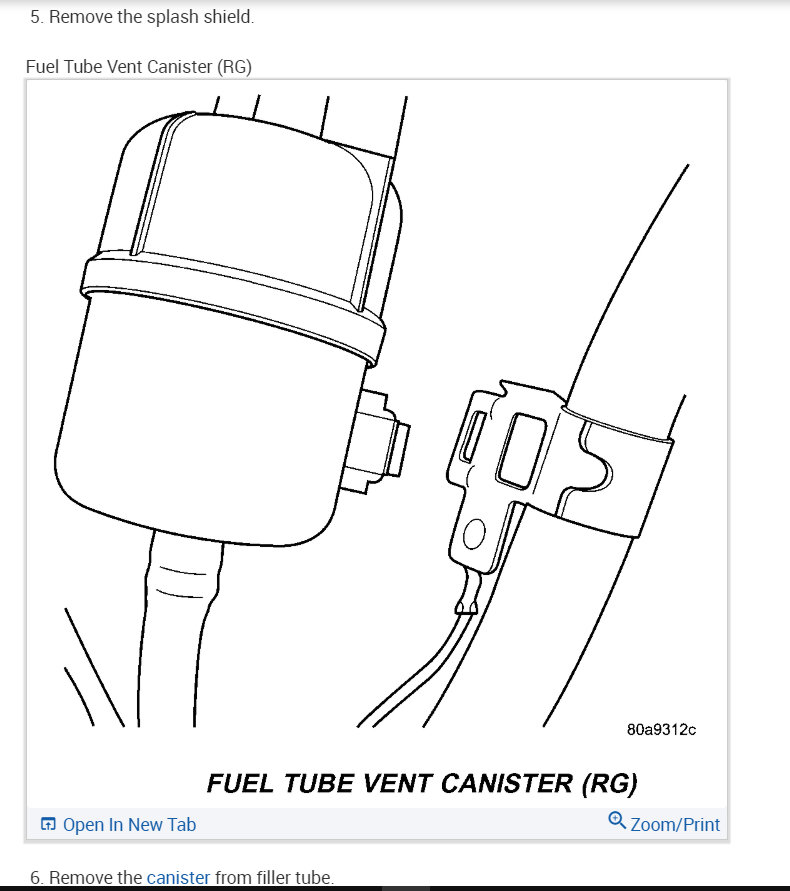

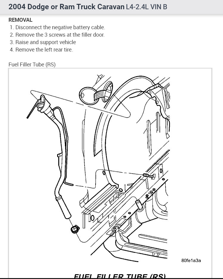

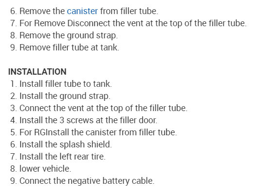

Hi:
This happens when the filler neck needs to be replaced because the vent tube is collapsed inside the filler. Here are instructions in the diagrams below to help you fix the problem. Check out the diagrams (Below). Please let us know what happens.

No that big rubber neck is fine as I replaced as I thought that was the original problem a few weeks ago when it started. I dont know what ball type filler there is as I can shove a 1/4 hose all the way into the tank. The check engine light came on 25 Dec when I started it up (that was the initial studdering) on the way home from church is when I got fuel and it let me fill with no problems. Now the same spudder this morning and again cant put fuel in without it taking me very slowly 10+min. When I do put it in real fast its like a vacumn and it shoots back out with pressure. My brother in law looked the code up and its a air leak code

There is a leak somewhere in the evap system. It could be as simple as a fuel cap or you could look for days trying to find it. They can really be a pain. Check the fuel filler steel down tube for rust problems. If no luck, take it to a shop and have the the system fogged. The fog will leak from the problem area so you can find it. Otherwise, you could be looking for some time. It could even be above the fuel tank which requires you to remove the tank to check.
If it isn't something obvesious, the fog will be the best money you ever spent.
Sunday, January 4th, 2009 AT 12:12 PM
SJJANSEN
Thanks, I got the filler neck part and installed it all fixed! Thanks for the suggestion you guys are the best!

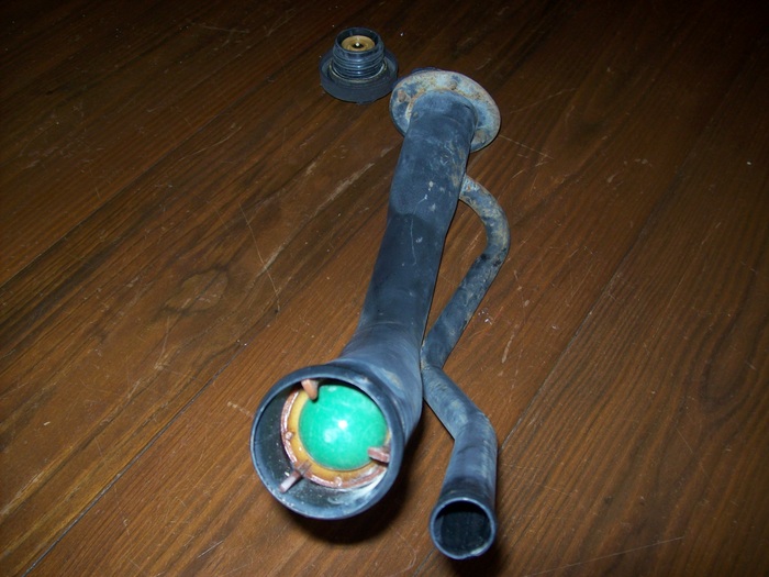

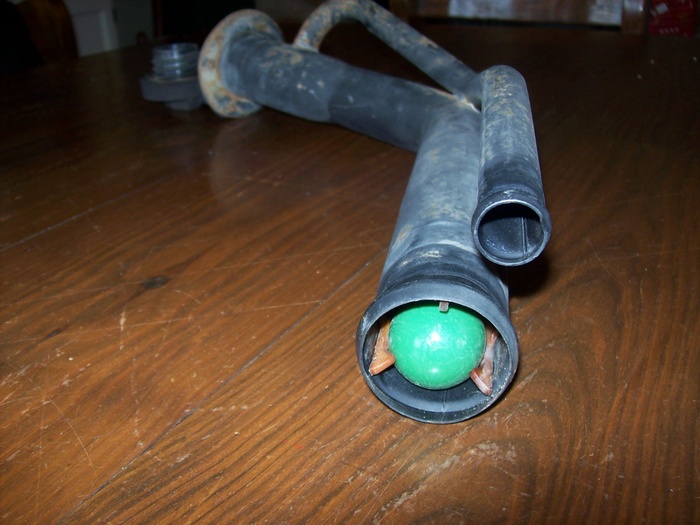

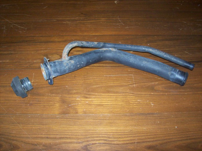

I'm not real sure how yours is
i need a filler to modify and put on a old willys jeep fuel tank
this one just so happened to be laying in the bed of dodge ram pickup truck (whether it went to the truck, I do nt know)
yours may be sorta like this--upon looking thru "mitchell i" I could not find a diagram of your system
with my super engineering skills, I think the only real reason for a check ball is for "anti slosh" and might also prevent gas from coming out of the gas cap if the vehicle turned over.
I have seen them broken and floating around somewhere in the tank---and no repercussions occurred, still drove fine, with other vehicles
these too might also prevent a "novice siphon-er" from stealing your fuel. But someone could ezily punch this thing on, into your tank. Its sorda a fragile cage around the ball.
What possibly could happen to one like in my pics, is a small hose, stick or foreign object get inserted into it, and broke off when it was snatched out or was small and wedged itself between the ball and the cage
it's also possible that the "seat" or portion of the cage the ball rests in, when fuel pushes it upward after you are finished installing fuel. This part may be worn from the ball bouncing on it over the years, and the ball simply just sticks or lodges into the seat.
If yours is like this, 1st investigate at an auto parts store, can you get just the plastic "check valve assembly" or must you buy the whole filler assembly (napa, autozone, advance auto are some to check out)or is this strictly a stealership item?
The auto salvage yard is yet another option, and I go there often myself
after exploring what you can do or can get and where it's available.I would remove yours and try to determine if you can simply remove missing action figure "darth vader's light saber" from the assembly and all be like new. Or does it need new parts?
As far as the fuel sender, it is most likely unrelated (but you never know)
if you can live with it. Wait until you have fuel pump problems and the tank must come out anyway to replace the pump and the faulty sender
i'm a great example for you (probably not practical for you) I never worry about running out of fuel on either of my two jeeps, my civilian '77 cj 5, as well as my '46 willys army jeep, both have 5 gallon cans on the back, mostly for me. But have helped those stranded too!
Let me know what you find, I hope it's ez!
