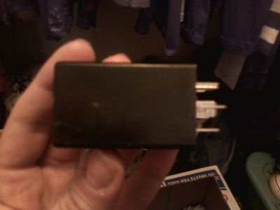

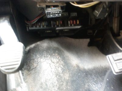

That doesn't sound good. I can't be much help with the cruise control since I don't have that on my '96 Caravan, but the wiper problem I share that, and I don't even know what to do about it but that doesn't really bother me. I used to have the same problem with the turn signals. The problem for me wasn't the fuses, it was the relay. Look here underneath the instrument panel on the driver's side, see where all those fuses are under there? Just get down on the floor and look up, and towards the very top of this fuse box you'll see a large relay, and that controls the turn signals and would probably need to be replaced.
https://www.2carpros.com/forum/automotive_pictures/409514_floor_1.jpg
https://www.2carpros.com/forum/automotive_pictures/409514_relay_1.jpg
That second picture is what the relay itself looks like. Sorry that's all I can help ya with. =/
