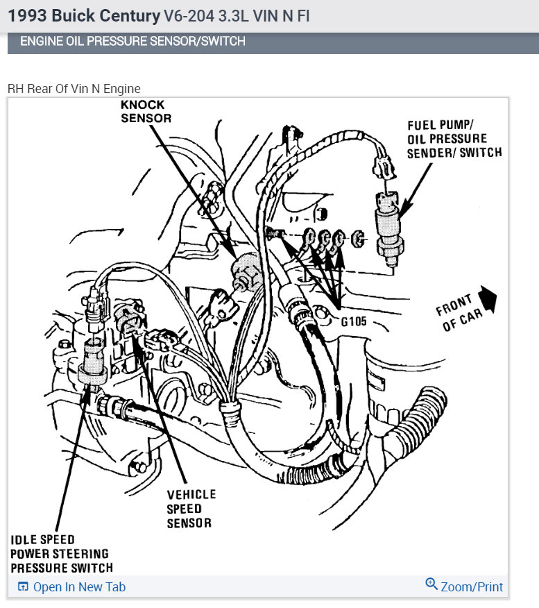

When switch is turned to on the oil light is the only one that is on and the car will not start. What all could cause that?

The oil pressure switch is set up the cut the engine when pressure is low or nonexistent. Can you check the oil level please? If the oil level is okay here is where the sensor is so you can replace it. Check out the diagrams (below). Please let us know what you find. We are interested to see what it is. Cheers, Ken

Question may have been misunderstood when I turn the ignition switch to on oil light is the only one to come on. Shouldn't the other warning lights come on until the car is started?
