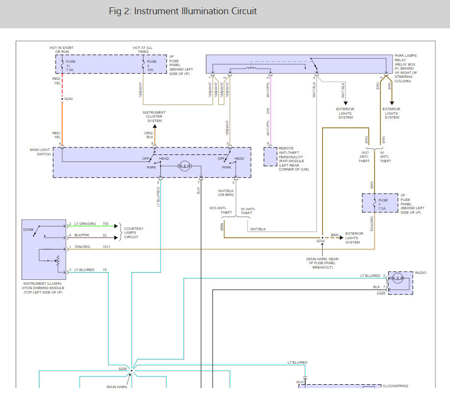

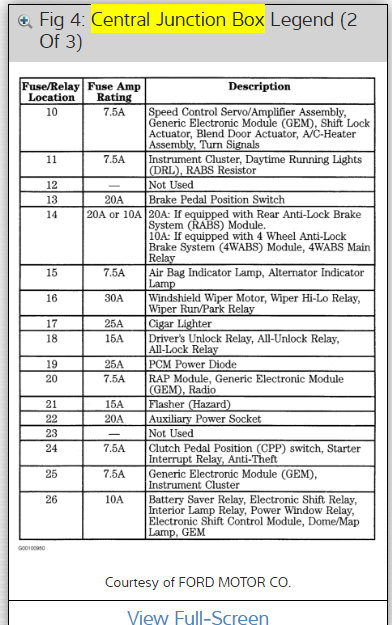

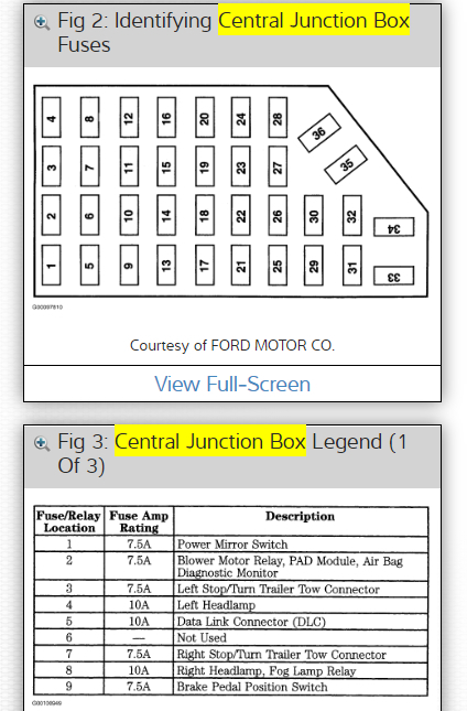

At night when I turn on my lights, I turn the switch and the head lights come on but the dash lights and radio cluster lights will not turn on. This just happened last night and I need some answers.
Wednesday, August 22nd, 2018 AT 11:07 AM
17 Replies
KEN L
  • MASTER CERTIFIED MECHANIC
  • 55,481 POSTS

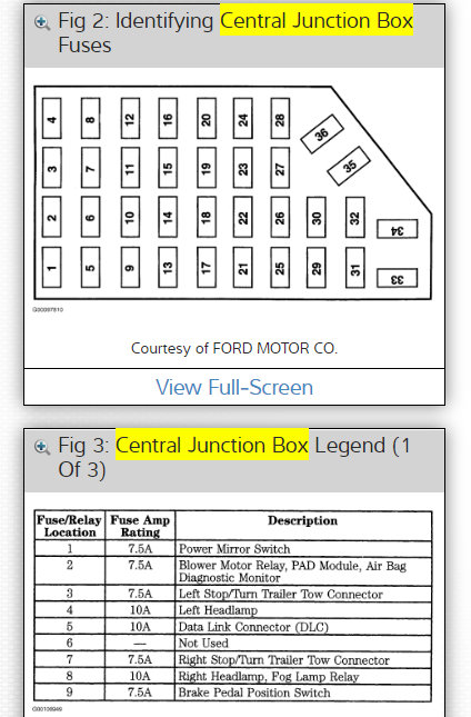

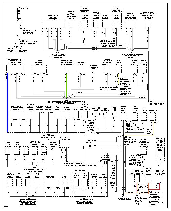

I would check fuse #11 7.5 amp. Here is a wiring diagram of the dash lights so you can see how the system works and a guide to help you check the fuse and the fuse location:

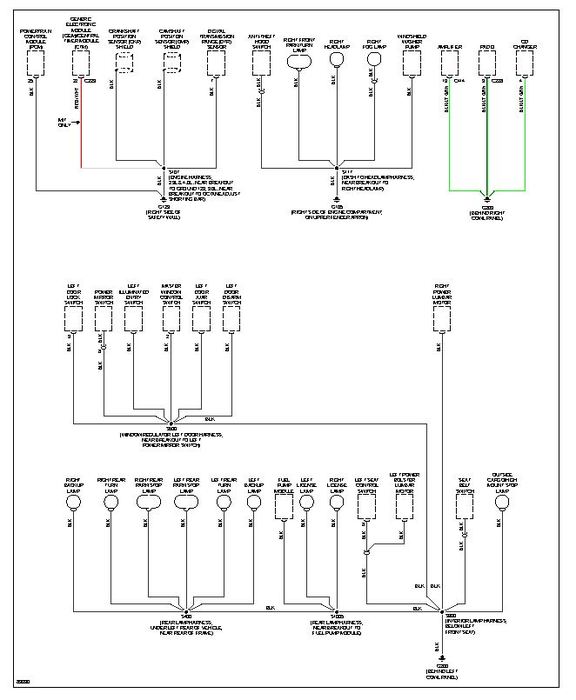

I turn on my left blinker my dash light start flashing
Thursday, November 26th, 2020 AT 8:54 AM (Merged)
DRCRANKNWRENCH
  • 3,380 POSTS

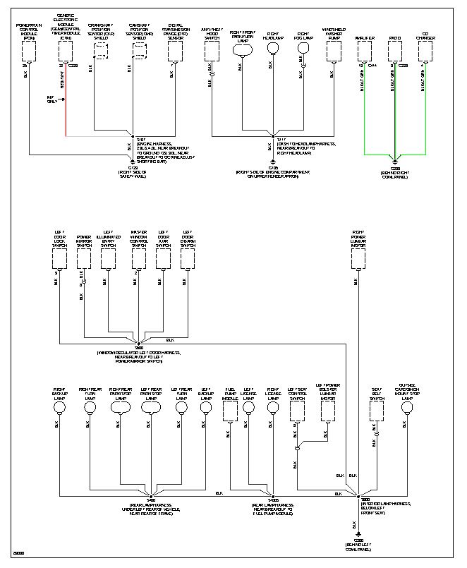

You probably have a ground problem near the blinker. I am attaching grounding points for you to check to make sure they make a solid metal to metal contact.
The other possibility is the multifunction switch but you should check the grounds first. The, "1of2" goes on the left of the complete diagram and you line them up by the numbers next to the wires.

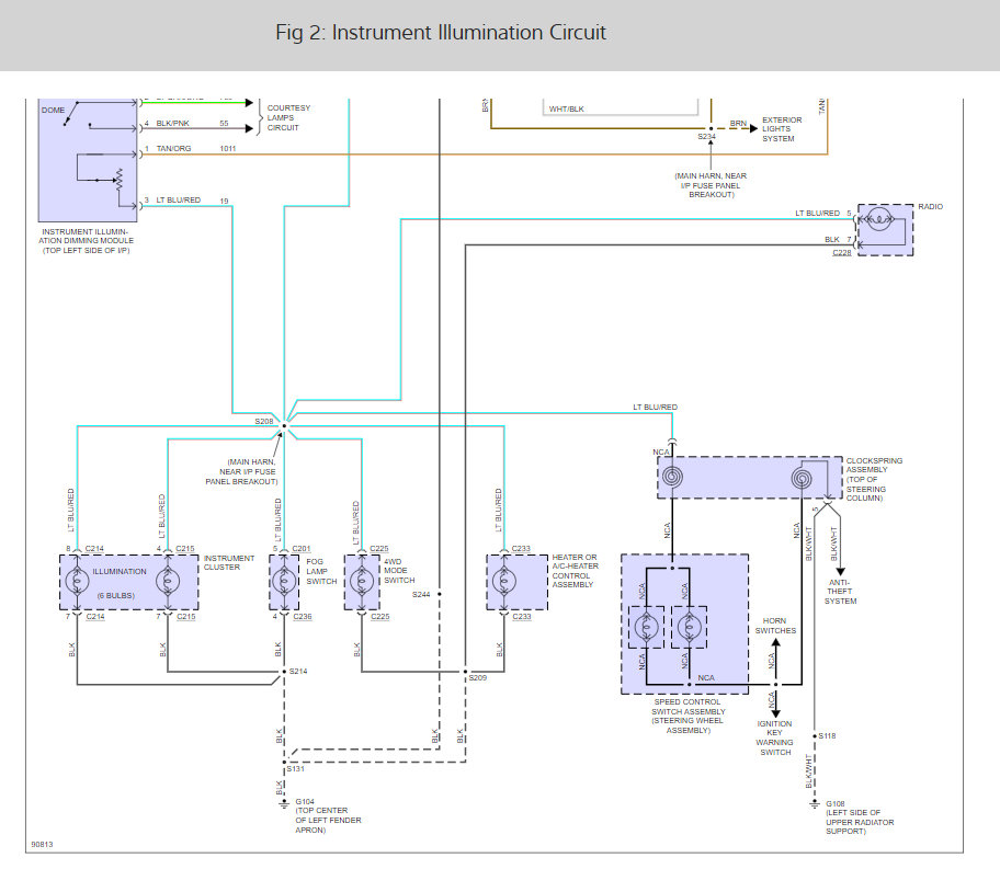

I have replaced the bulbs, fuses appear good. I have no dash lights, headlight switch lights or heater/c back lights.
Thursday, November 26th, 2020 AT 8:55 AM (Merged)
KEN L
  • 55,481 POSTS

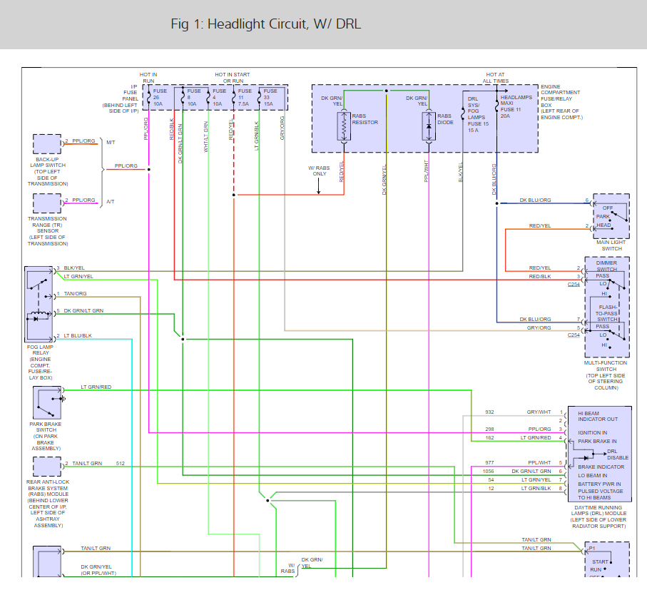

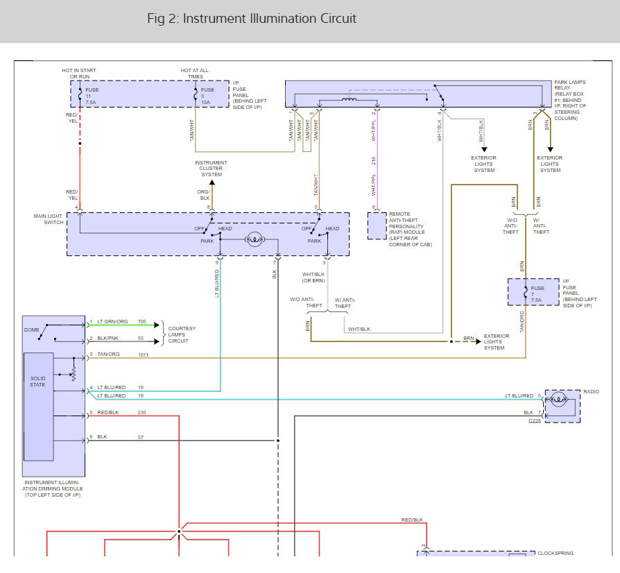

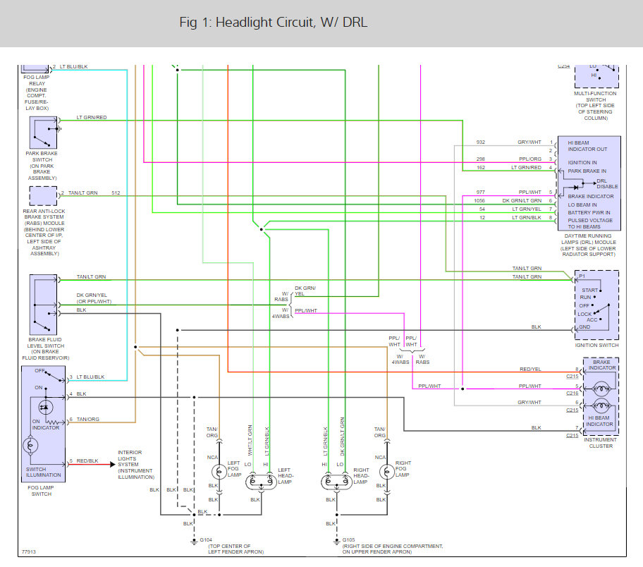

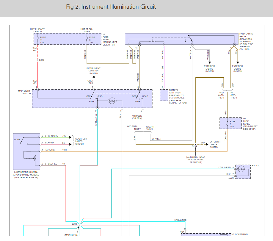

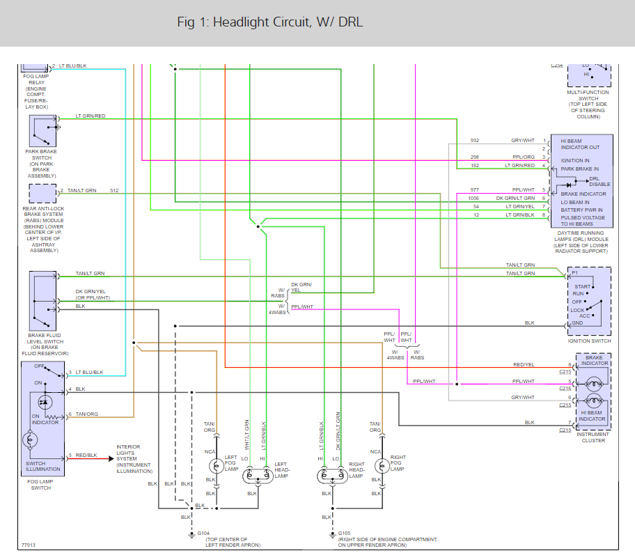

You must be losing power somewhere it sounds like a headlight switch but to be sure here is a guide and the headlight and dash light wiring diagrams to help us see whats going on.:
CWZRD1
  • 10 POSTS

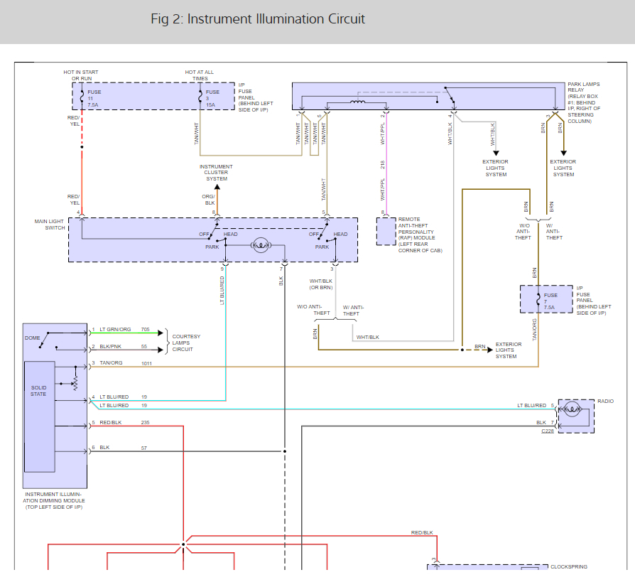

I got and replaced the headlight switch on Saturday, running and headlights work just no dash. I was thinking it was the dimmer switch module (with the circuit card) but I have to find one with six pins 95-97. All I can find so far are four pin.
KEN L
  • 55,481 POSTS

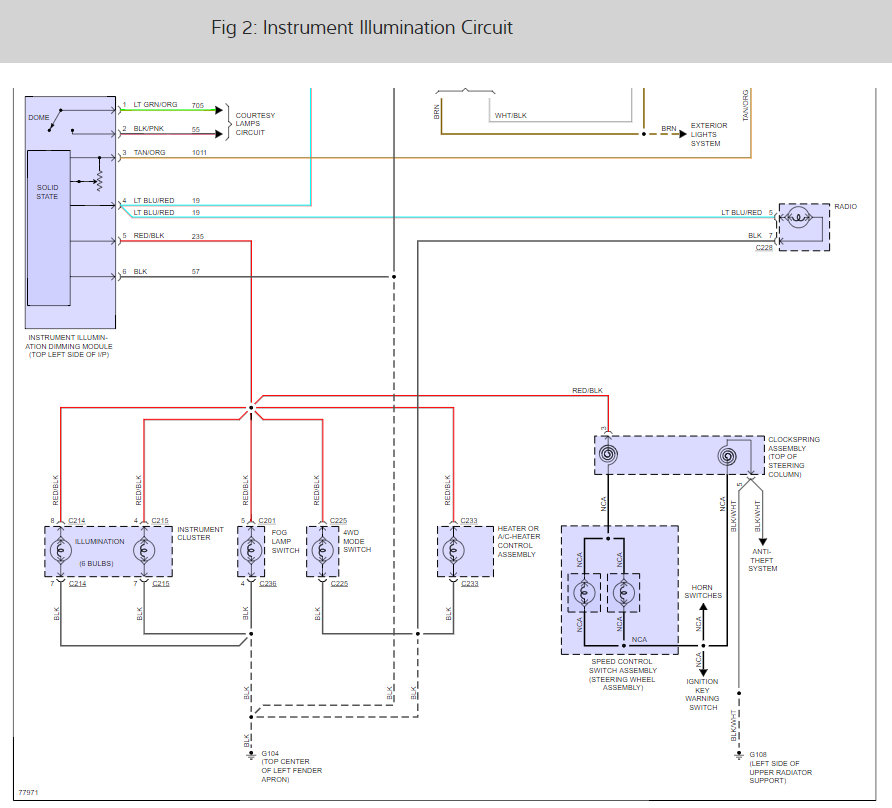

Do you have power at the light blue and red wiring headed to the cluster when the lights are on?
CWZRD1
  • 10 POSTS
I will take it back apart as soon as I get home from work and test. Thank you very much and I will get back to you Sir!
CWZRD1
  • 10 POSTS
I tested and I do have power on the light blue and red wiring headed to cluster. I jumped out between light blue and red to red/black and now I have dash lights, headlight back light and AC/heater lights. I know this is temporary, I believe it is the instrument dimming module giving me the trouble. Is that your conclusion? A new one is $164.00 and I wanted to be sure.
KEN L
  • 55,481 POSTS
Yep you found the problem. Let me know what happens.
+1
CWZRD1
  • 10 POSTS
Thank you for your courteous help and schematics! Will do!
CWZRD1
  • 10 POSTS
I got a used switch and installed for $25. Good to go! Thanks Again for your help!
