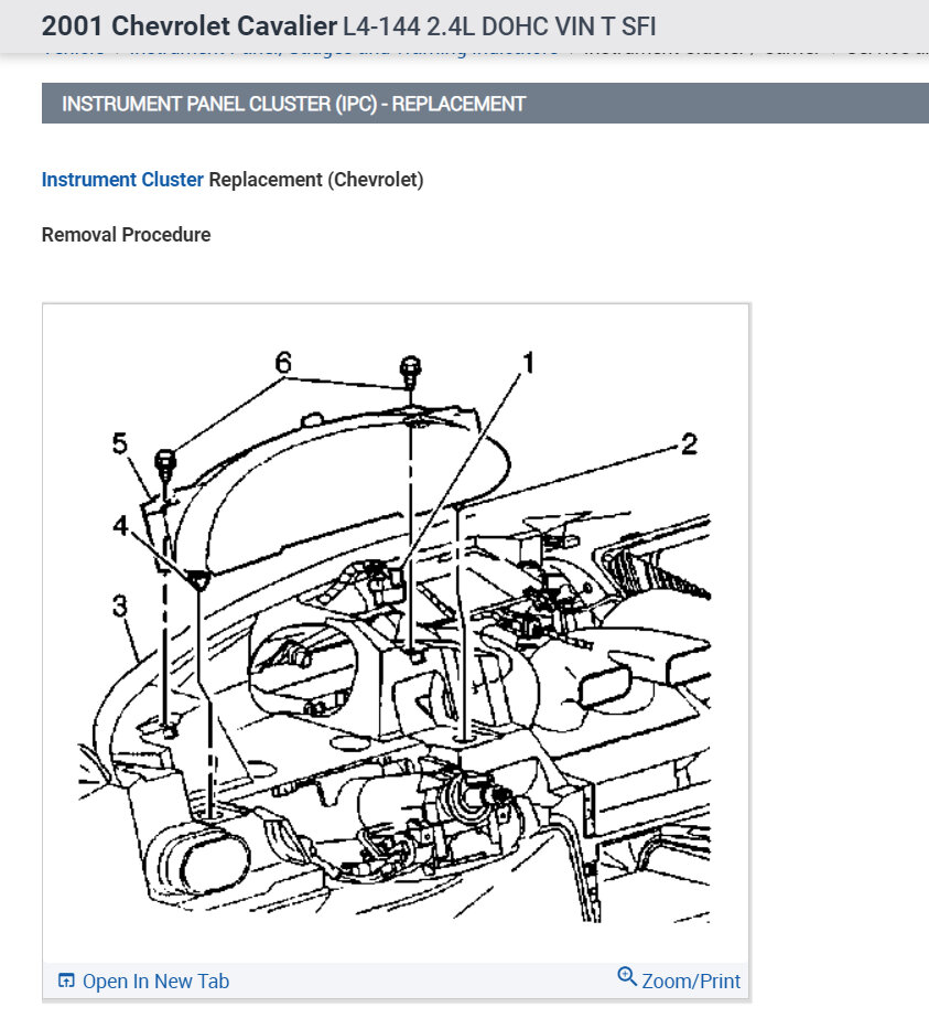

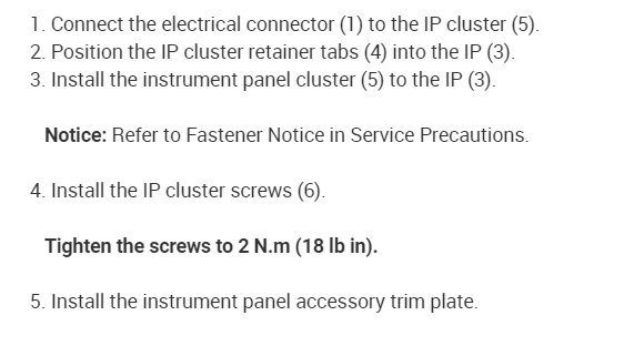

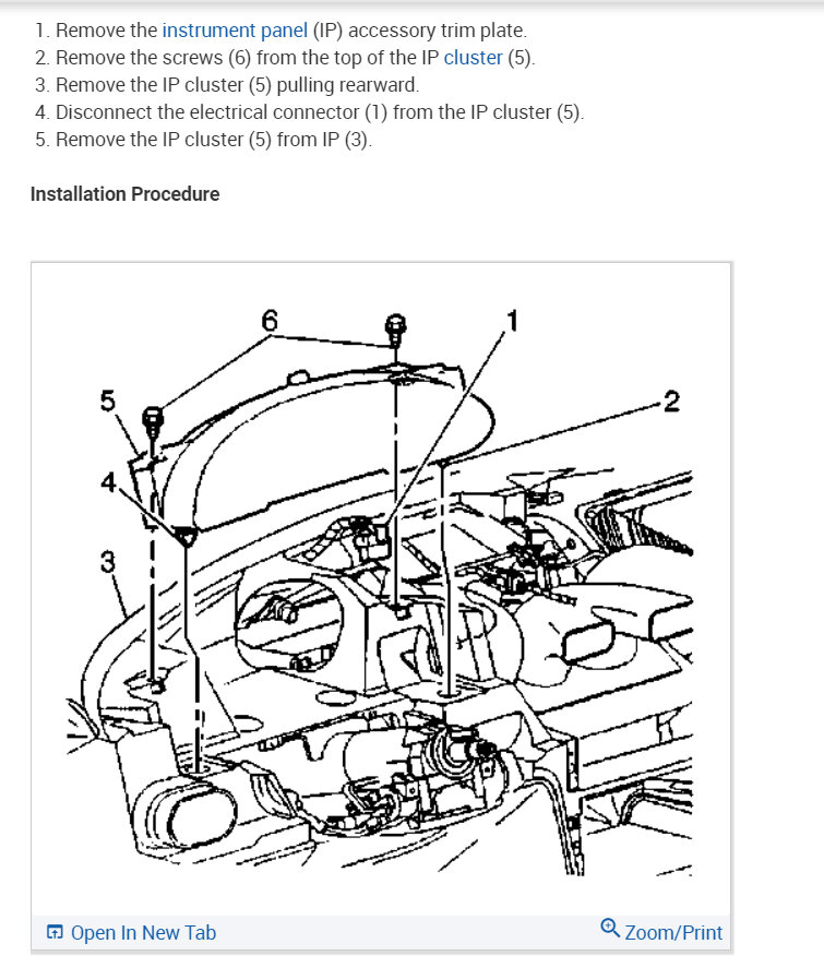

It sounds like the instrument cluster is shorting out, but we should check the ground # g129 (blk/wht) wire at the front of the transaxle. If that is okay, I would get a rebuilt cluster by searching google or eBay, here is how to change the cluster out in the images below. This video shows the job being done in a similar vehicle:
https://youtu.be/_HEC44xENxw
Check out the images (below). Please let us know what you find.
