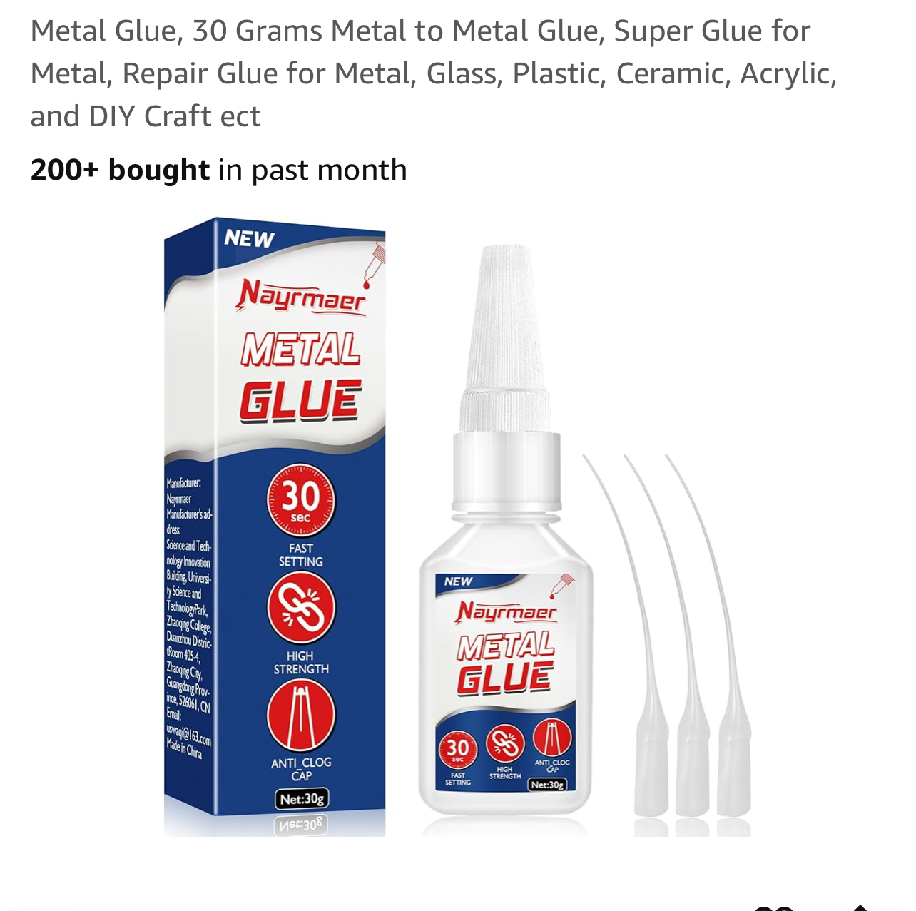

So far so good its holding and am surprised as am only able to put few drops by wiping method on the edges because there is no room. I used both Loctite and the used this here. So far it didn't come off. I am just scared of what would happen if it does come out?

That bearing is mainly for support. There shouldn't be a lot of lateral force on it so it should stay put.
