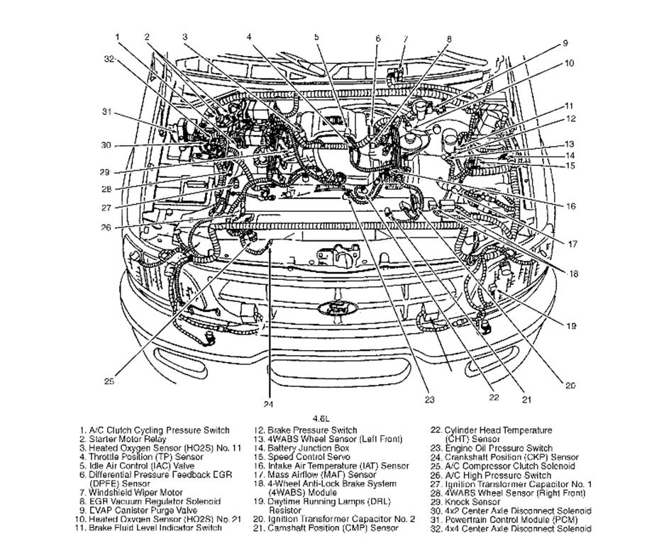

Hmac 300, hello, well the truck is an 02 ford f150, 4.6 lt. With 269530 miles. I did see that the anti-theft runs several things. But a mechanic told us that the problem was the censor, I hope that's all. Now to see if I can change it myself. Thanks
Monday, August 3rd, 2020 AT 12:11 PM (Merged)
HMAC300
  • 48,601 POSTS
See pic for location

Hello again, we have changed the crank position censor as the old one looked burnt. But now everything is back together and it acts like it isn't getting gas
we have checked to see if everything is getting power and checked fuses as well, don't know what to do. We really need help. Sandra

Do what I said in the very first reply the pic I sent should point out the coils reset your anti theft like I said as well if no manual look online check all fuses underhood as well as fuel pump relay. You can switch another realy that has the same configuration as the fuel pump one.
