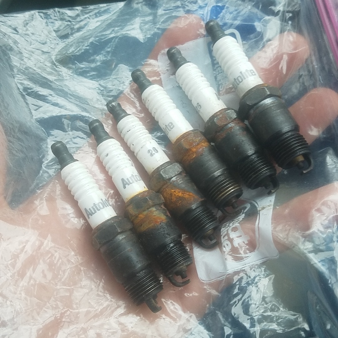

So I checked the spark plugs and they look new. Checked over the distributor and everything lines up and is plugged in the correct firing order. I took the old fuel filter out and found out that gas in in fact getting through the fuel filter meaning the pump must be working. Went out to the car yesterday and it almost started for the first time but then it immediately died out. Changing the filter tomorrow. New one should be in by 5pm today. Anymore suggestions?

SCOTTIE JOHNSON
  • 11 POSTS
Those were the plugs. Rusted and burnt. Replaced them but still didnt fix the problem. Im leaning towards clogged injectors cause itll fire up for a split second when starter fluid is sprayed in the choke but wont get fuel to it on its own. How would I go about getting to the injectors to clean them?
