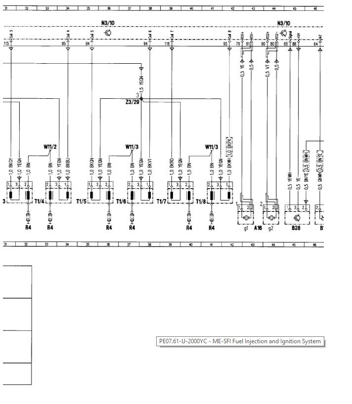

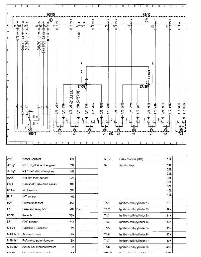

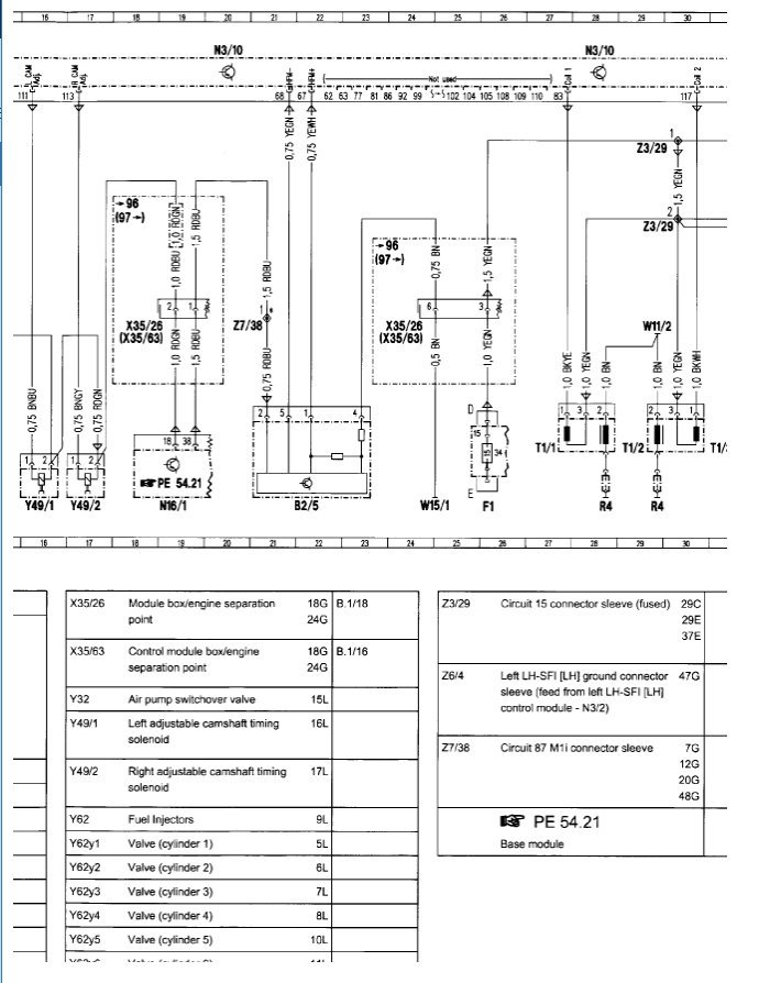

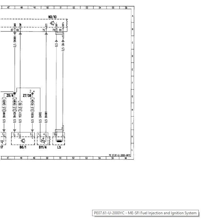

I looked at the wiring diagrams and the #19 fuse goes to the #2 ignition coil, please disconnect it to see if the fuse blows still.
Monday, June 5th, 2017 AT 12:02 PM
ANTONIORRR
  • 5 POSTS
Still pops
Monday, June 5th, 2017 AT 12:05 PM
KEN L
  • MASTER CERTIFIED MECHANIC
  • 55,077 POSTS
Okay, here is the engine wiring diagrams and a guide to help you troubleshoot the wiring. Use the voltmeter to check for any resistance to ground.
Diagrams (below)
Please run some tests and get back to us so we can continue helping you.
