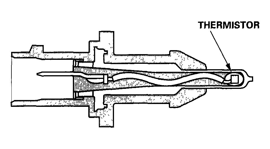

Thanks for replying.I have a dtc P0113 intake air temp sensor circuit high. What your saying is. The ecu, immobilizer and my key need to bind to each other.
Wednesday, January 6th, 2021 AT 2:50 PM
STEVE W.
  • 15,698 POSTS
P0113 intake air temp sensor circuit high - Check the wiring from the IAT to see if it is broken. The picture shows the sensor. It's a simple heat detecting resistor. They do fail but the wiring is the more common issue.
