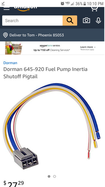

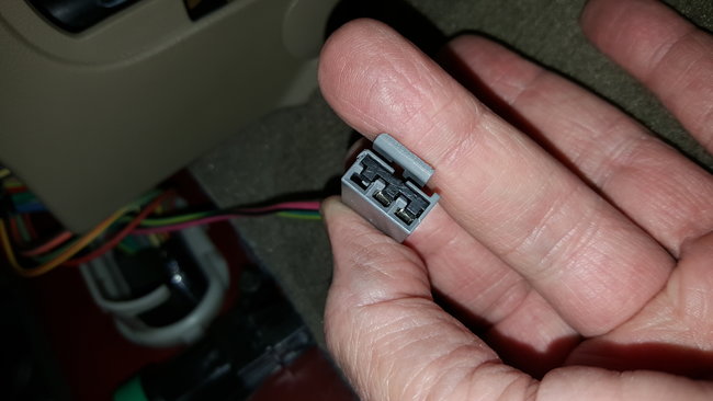

The connector is under dash so hard to see good Took pics of to find one and the female end is all black. Does not look good. That is the bad connection. Must of not been tight, overheated and carboned up. Located a Dorman at Amazon, same at Autozone and O'Reilly but $10 cheaper. Cutting off old connector. Tie those 2 wires plus one for my light so I can drive and monitor. Want to be sure it is fixed before I put switch back into circuit. Then will connect new connector and put all back normal. Thank you for all your help Roy! I appreciate your responses and guidance.

TOMDERWOODS
  • 29 POSTS
And to help, here are pics.

  • 52,797 POSTS
That is the correct pigtail. I would replace the inertia switch as well.
