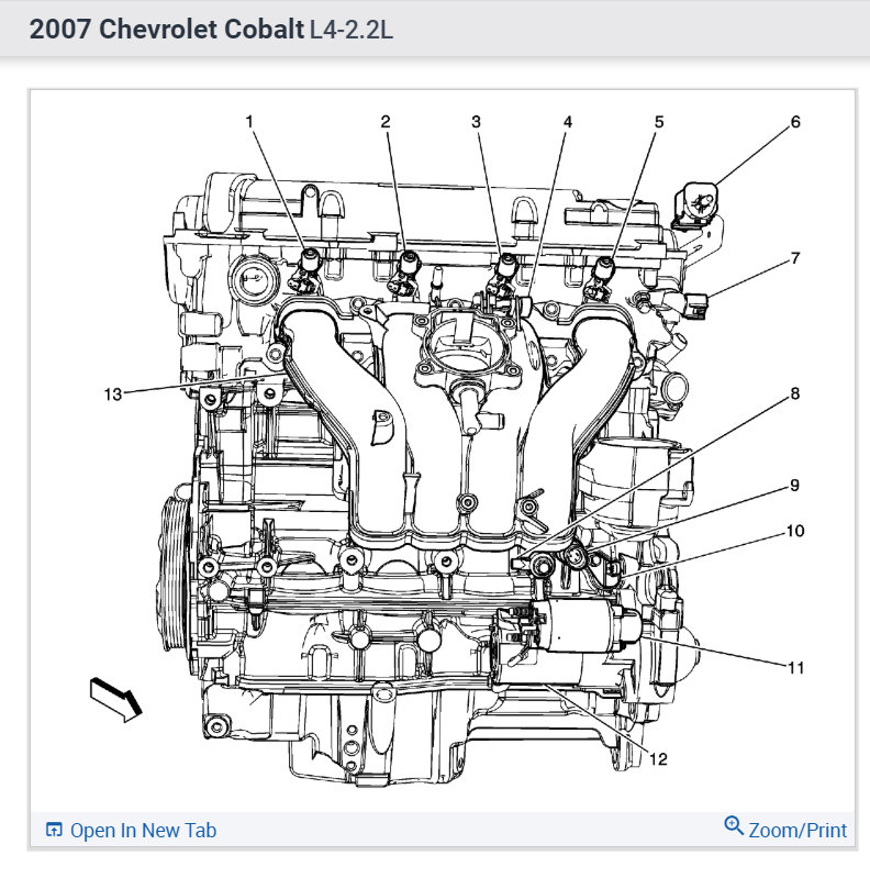

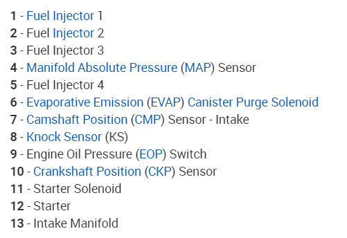

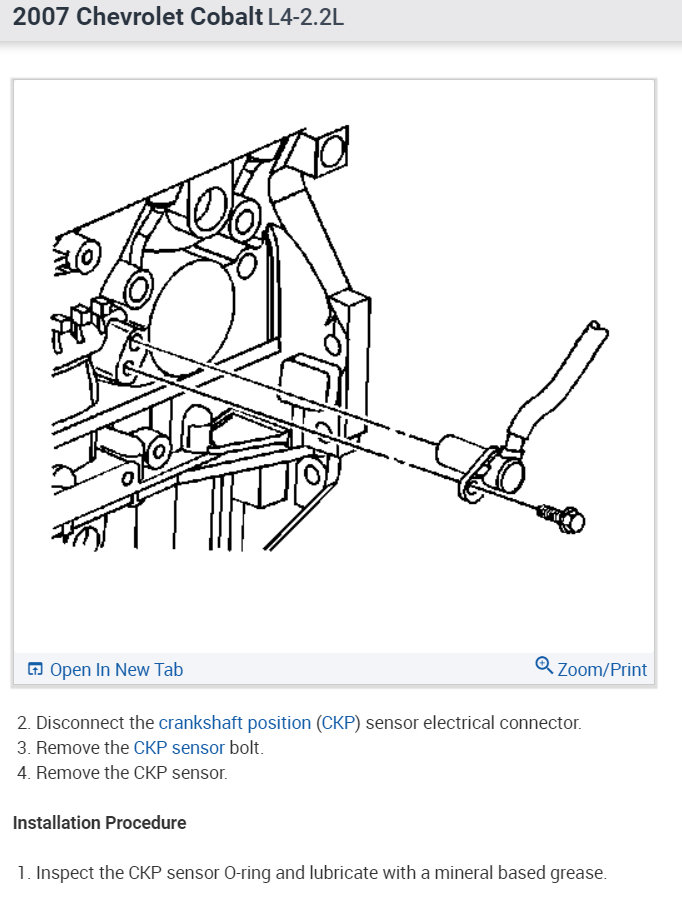

This sounds like the crankshaft angle sensor went out. To confirm lets check the ignition system for spark. This guide will help us with diagrams below to show you where the sensor is and how to replace it:

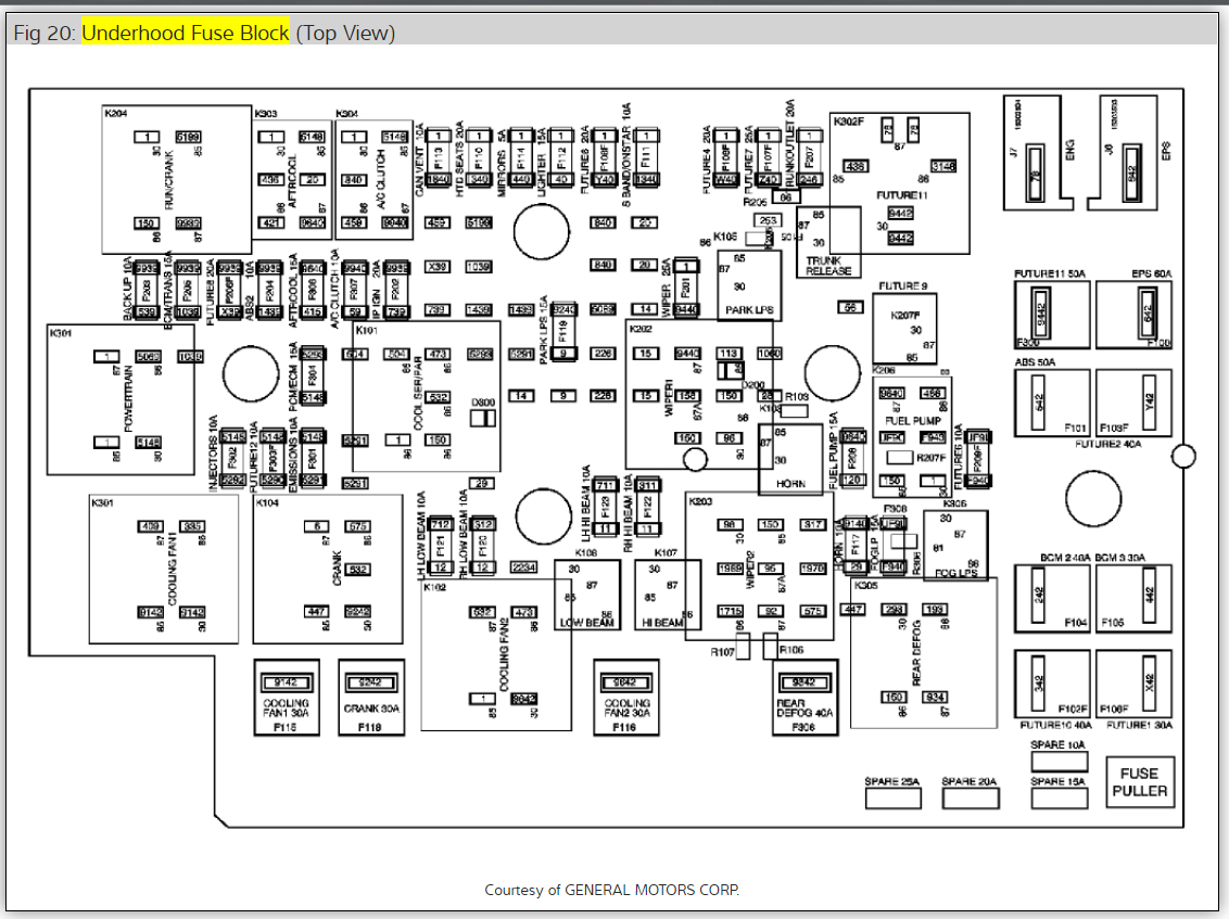

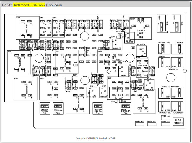

Okay, with the key on do you have power at the ECM fuse #41 and INJ fuse #45? This guide will help with the fuse location below:
Wednesday, July 29th, 2020 AT 12:07 PM
JOHN CAREY2
  • 5 POSTS
I have power on both, however determined that the fuse for the fuel pump has no power going to it, and now it will start for a second and stall consistently.

The fuel pump fuse should have power when cranked over. If not we need to test the fuel pump relay. here is a guide and the relay location is in the fuse panel featured above:
Please run down this guide and report back. No security light flashing correct?

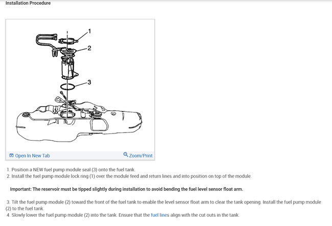

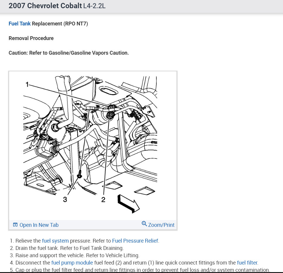

I checked and established there isn't noise coming from the fuel pump, it was coming from something else, and there is power going to the fuse when turning over. I also took out the fuel pump, the tank looks almost spotless inside, however the fuel pump looks nothing like any of the aftermarket ones that I see.

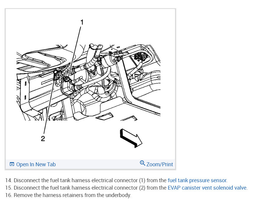

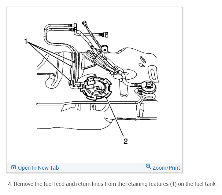

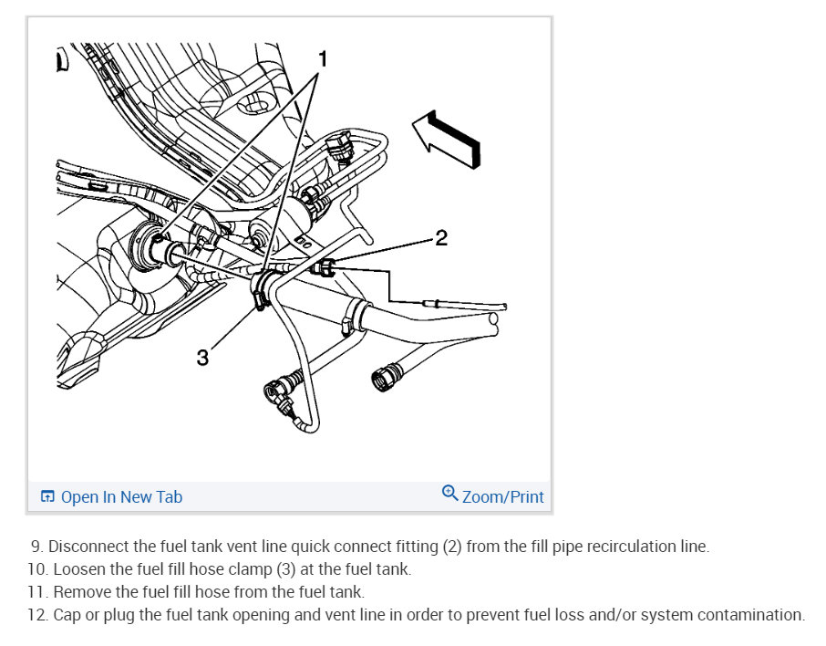

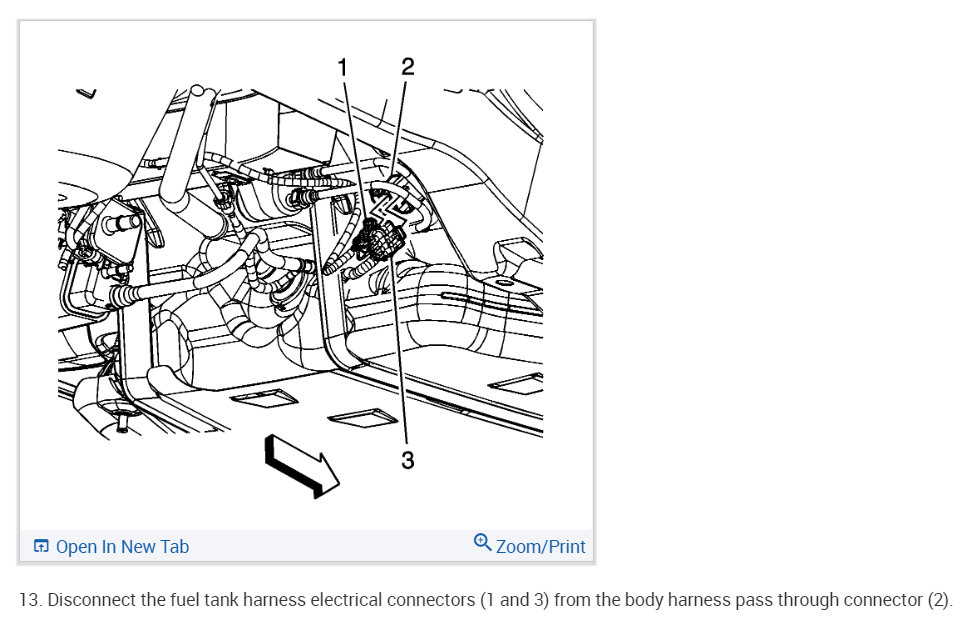

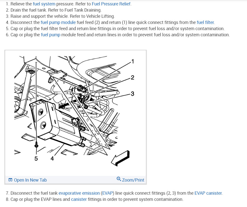

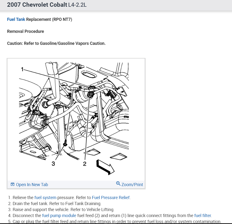

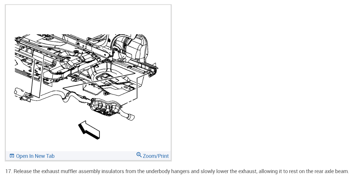

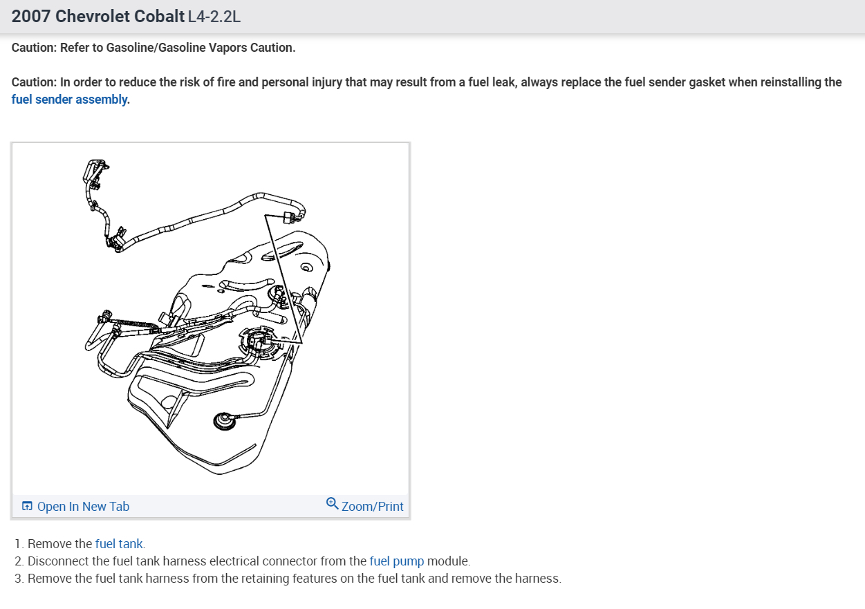

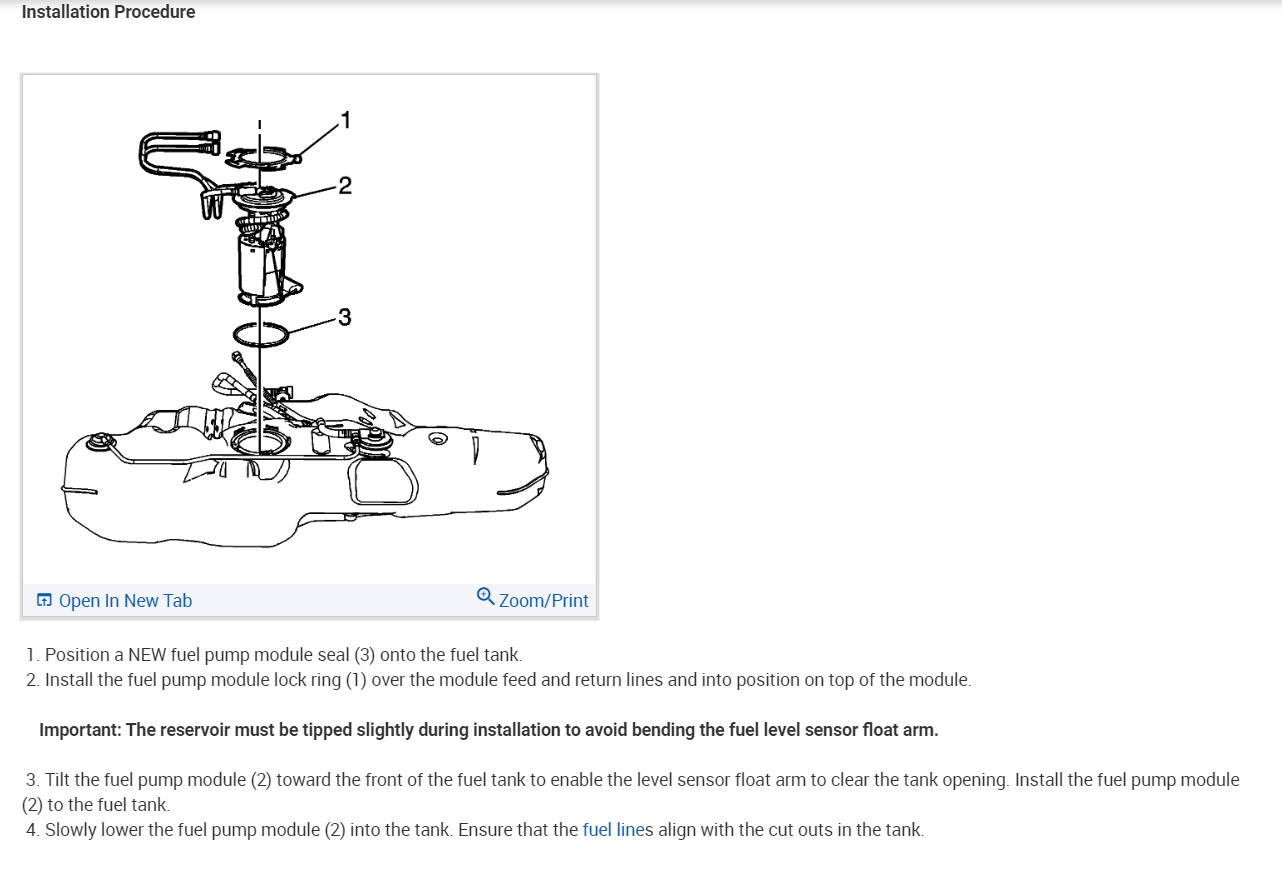

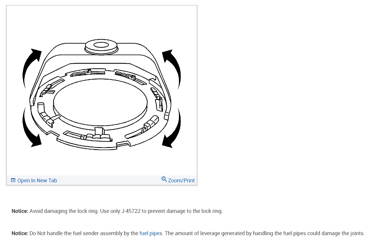

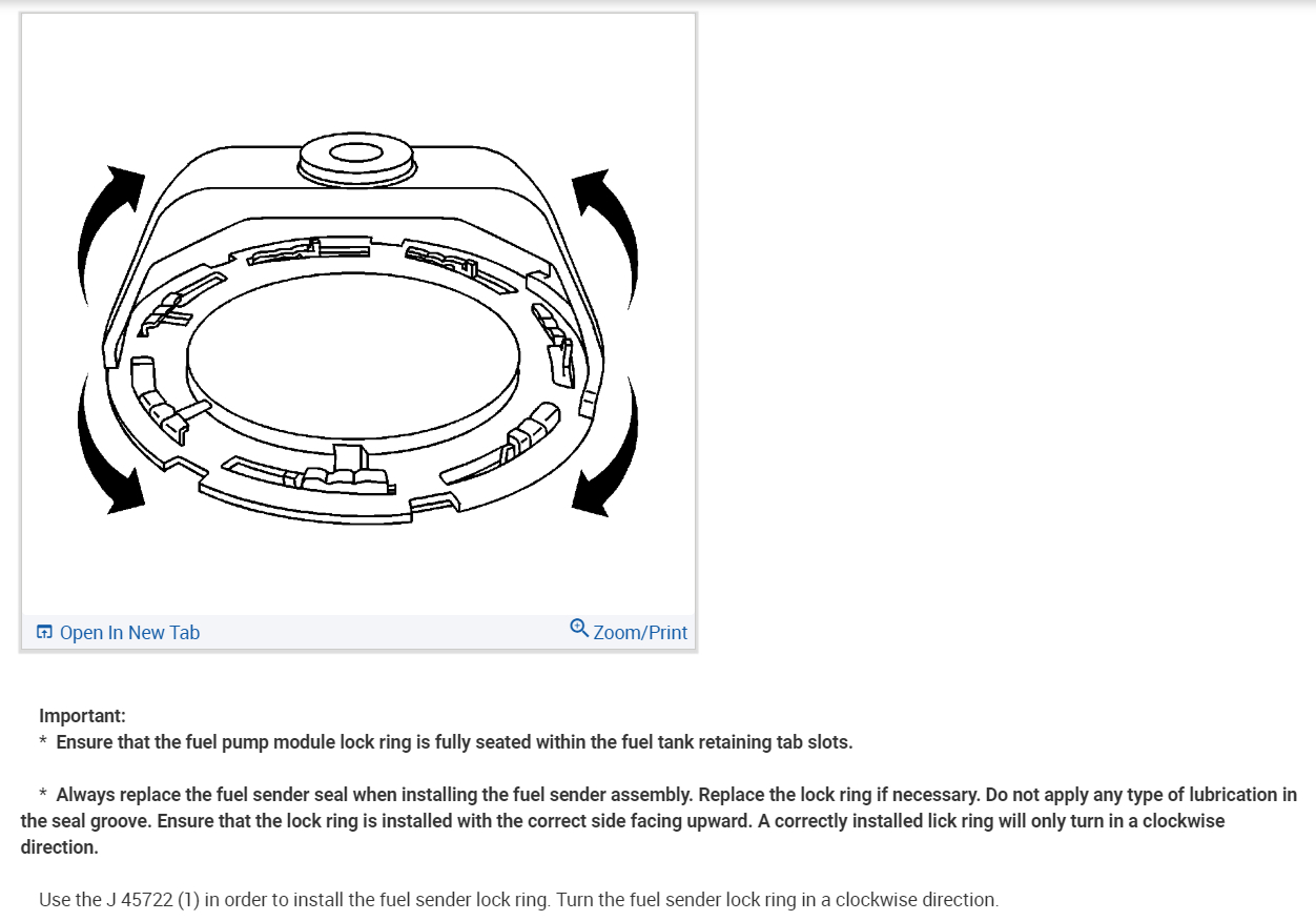

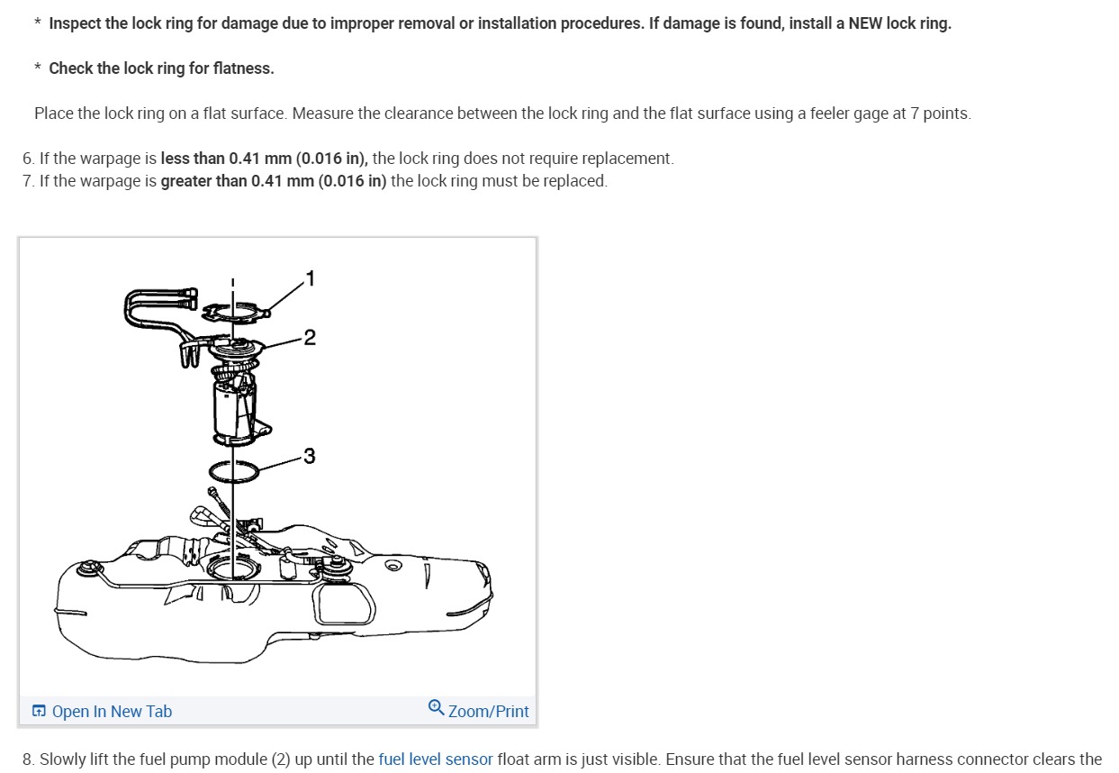

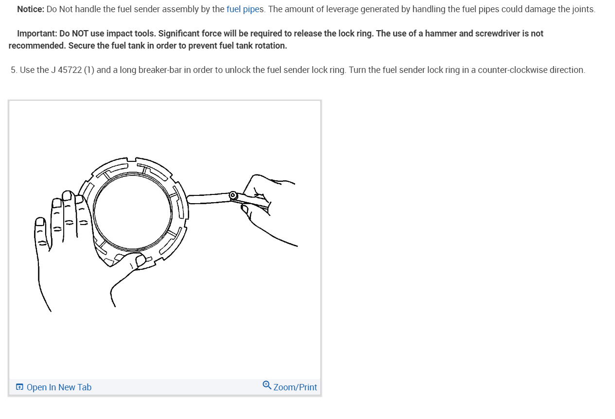

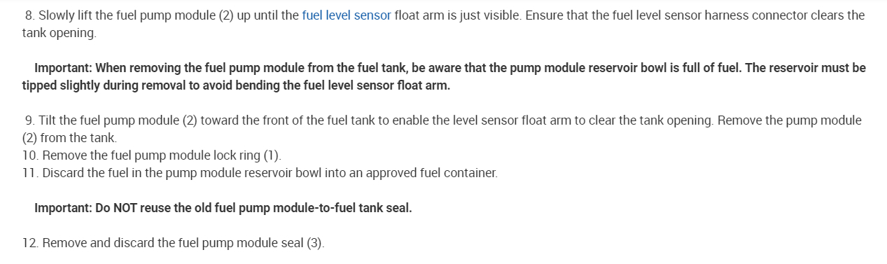

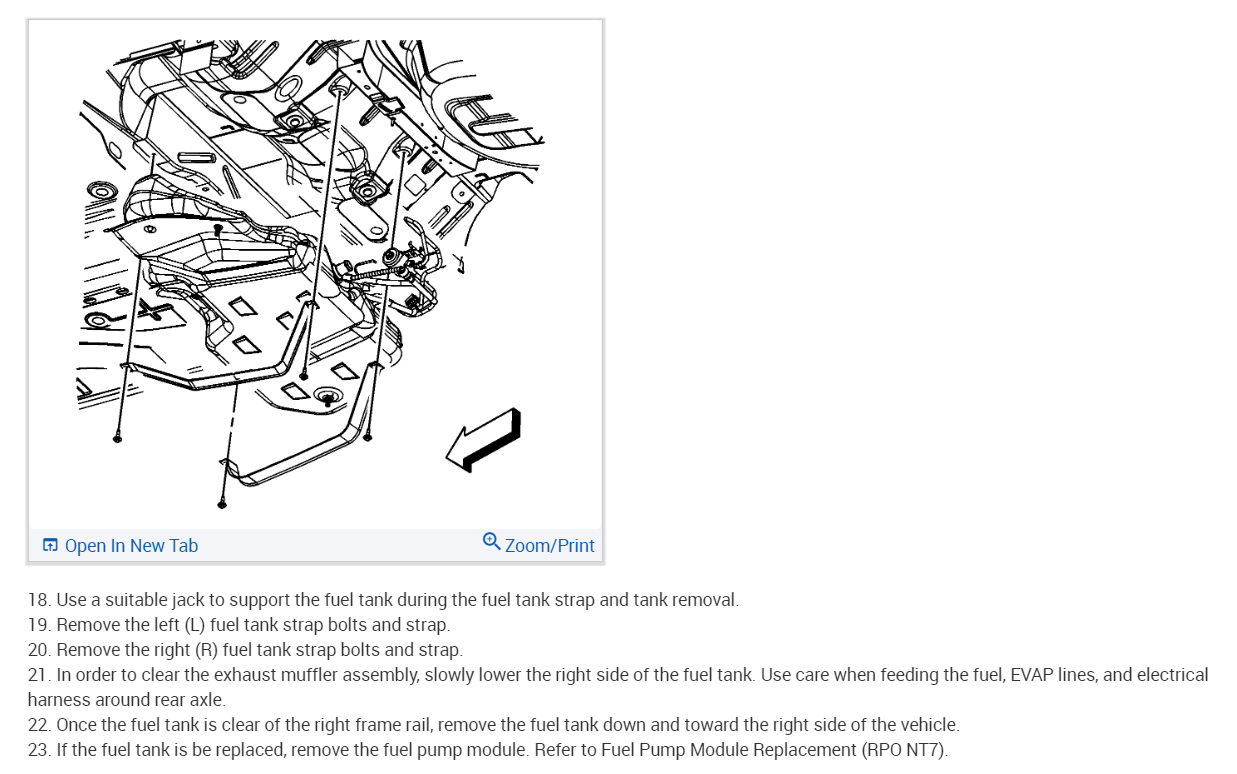

It sounds like the fuel pump went out which is common and can you put 12 volts to the pump to see if it will run. Here are the instructions on how to change the pump out in the diagrams below. Check out the diagrams (below). Please let us know what happens.
