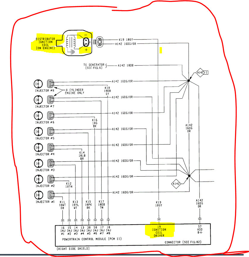

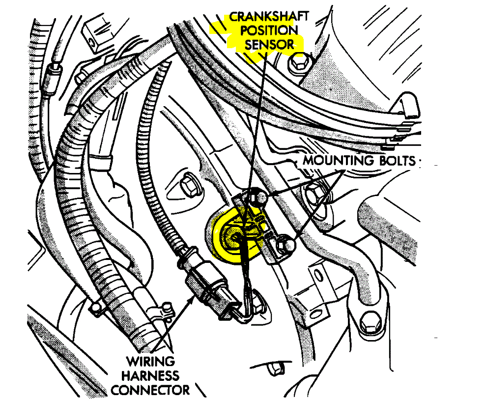

I was going to work and it shut off. I pulled it home and took the bed off to inspect fuel pump. It primed for a couple seconds so I tried to start it and it fired right up. So I tried to drive it and it did the same thing except I didn't tow it. I had fuel at the rail so I knew it was getting fuel. I tried to start it and it fired up. So I headed back home and it shut off again but this time it skipped a couple times then shut off. I pulled it home and put a new coil because there was no power when I tested it. New one shows power at the coil but not at the distributor. I am stumped please help.

If you are not getting spark, the most common cause on these vehicles is the crankshaft position sensor. It is located on the transmission bell housing. I attached a picture below.
Take a look through this link and let me know if it seems to mirror what you are experiencing.
Also, there are other things that would cause it to stall. The Auto Shut Down, camshaft position sensor and so on. However, those things would also shut down fuel delivery and you mentioned it is getting fuel.
If you haven't already, please confirm there is no spark to the plugs when it won't start.
Let me know what you find.

So I am getting 12 volts to the coil but no spark to the distributor. I have read that it could be the circuit breaker. I tested the resistance in 2 different coils and both checked out fine.

First, I attached a schematic related to the coil. Note that power is supplied via the PCM/ASD relay B+. You have power there, correct? If so, the next thing is the coil driver in the PCM. The PCM provides a ground path for the power to complete the circuit. Check to confirm there isn't a wiring issue between the coil and the PCM pin 19 coil driver. Check the wire for continuity first. Make sure the battery is disconnected when doing this. Also, after the battery is disconnected, remove the connector at the PCM and see if the pin is corroded or damaged.

So I followed your first piece of advice and checked my crankshaft sensor and boom someone had spliced the three wires and they were broken were I couldn't see them. Rewired it and it fired right up. I let it sit and idle for 20 minutes then went on a 10 minute ride and it ran fine. Thank you for the advice. I also have a 1988 Chevrolet S10 that will run and idle but when I try to give it has it starts missing and popping. Could the cranks shaft sensor be the culprit of that as well?
