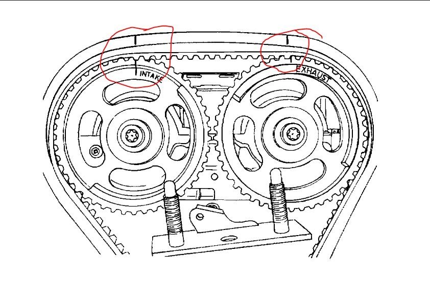

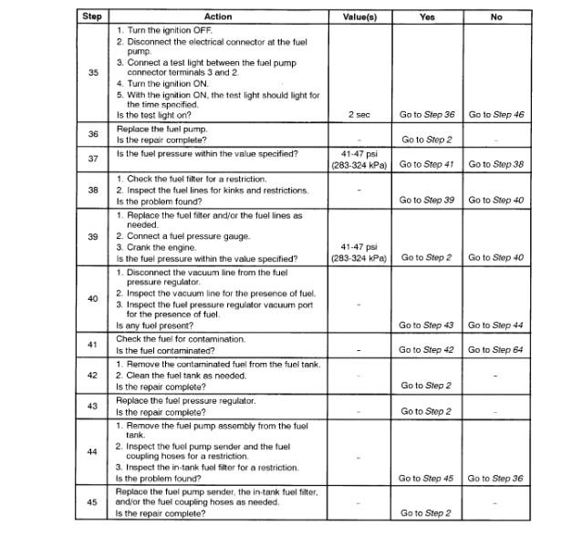

My car keeps cranking but does not start I removed the cam and crank sensors and replaced them now it still does then same. The cam looks like its fora Lenos and doesn't fit behind the timing head could it be that is the main issue uptill now
Wednesday, February 12th, 2020 AT 12:28 PM
17 Replies
Much better thank you.

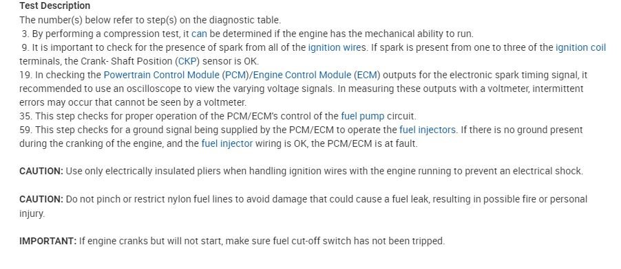

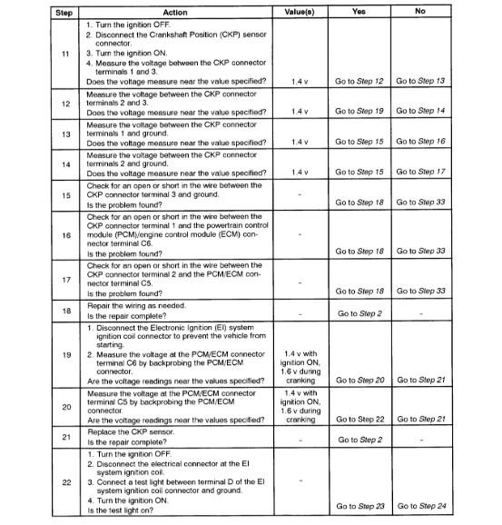

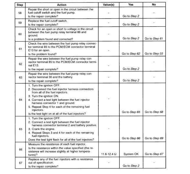

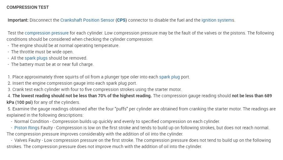

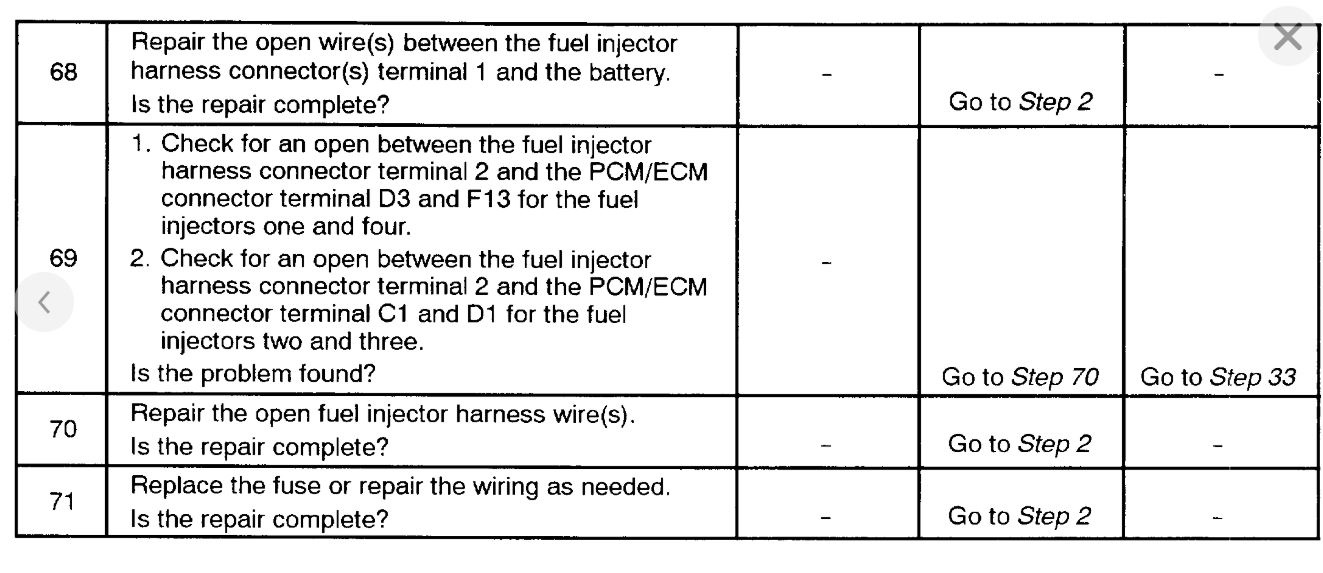

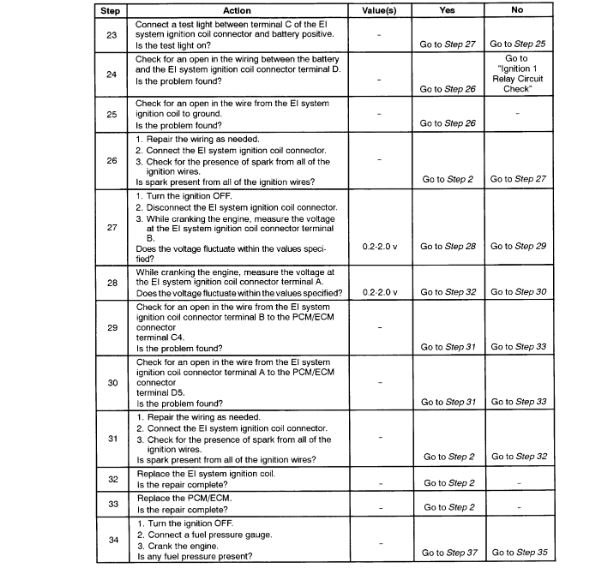

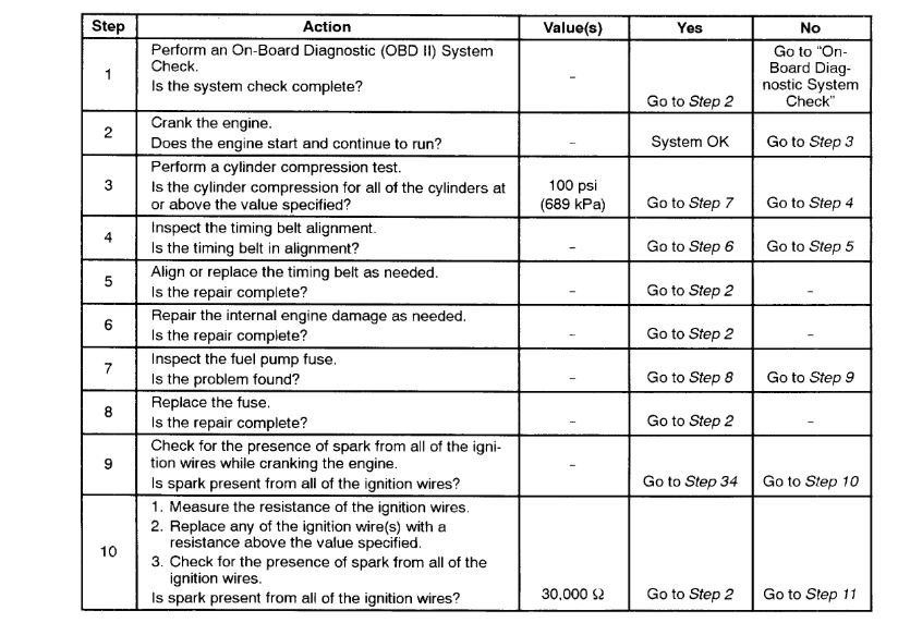

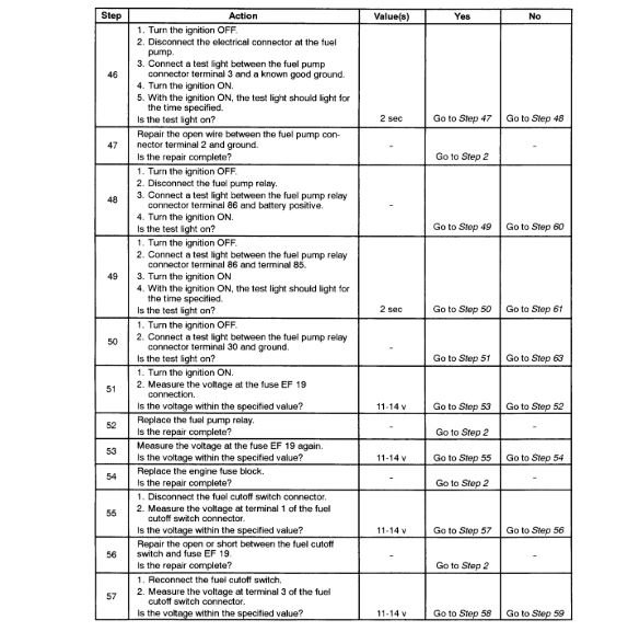

You need to check the compression to see if the timing belt has failed.
You need to test for spark at the plugs.
You also need to check for fuel pressure.
I attached flow charts to help determine the source of the failure.
Sunday, February 16th, 2020 AT 9:37 AM

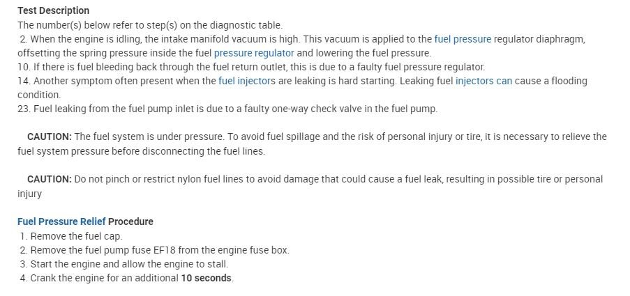

There are many things that can cause this type of an issue. Do the simple things first. Check the air filter to make sure it or the induction tube are not plugged.
Check to make sure there are no engine vacuum leaks.

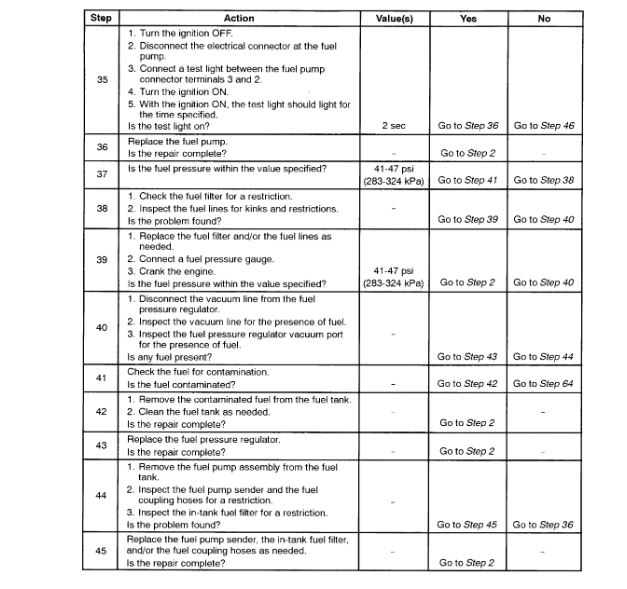

Check to make sure fuel pressure is within the manufacturer's specifications.
Here are the manufacturer's specs for pressure.
Fuel Pressure .................... 283-324 kPa (41-47 psi)
If the check engine light is on, check for trouble codes which can direct us to where the problem is coming from.
https://youtu.be/YV3TRZwer8k
Also, let me know if you are able to keep the engine running with your foot on the throttle or if it still continues to stall.
Let me know what you find.

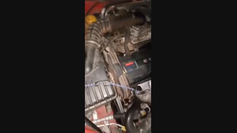

When I start my car it gives me a sound like lawn mower.
Thursday, January 21st, 2021 AT 4:38 PM (Merged)
If this is a constant noise like a lawn mower, more then likely you have an exhaust leak before the muffler. The muffler is meant to do just what is sounds like, it muffles the noise from the engine.
Just to confirm this can you get a recording of the noise so that we can hear it and that should give us the needed info.
We will be limited in the service information we can give you about your specific vehicle because we don't offer this vehicle in the USA so we don't have a manual. However, we can give general information because an engine is an engine and in this case, a noise is a noise no matter where the vehicle is in the world.
Thanks. We will wait to hear back.
TECA
I have added two videos. Hope it helps.
Oh. I am sorry. I didn't expect that so thanks for the videos. This is an engine knock.
I would suggest draining the oil and cut apart the oil filter and look for metal. However, I suspect you will find metal as this is bearing material and the noise you are hearing is metal on metal of the crankshaft bearings or rod bearings. Either way, I suspect you are going to need at least rebuild the engine or replace it depending on price of each.
Sorry for the bad news but that noise is not easily mistaken when you have heard it as many times as I have.

Did you check the engine compression?
Do you have sparks at the spark plugs?
Have you checked the fuel pressure and does starting fluids work?
