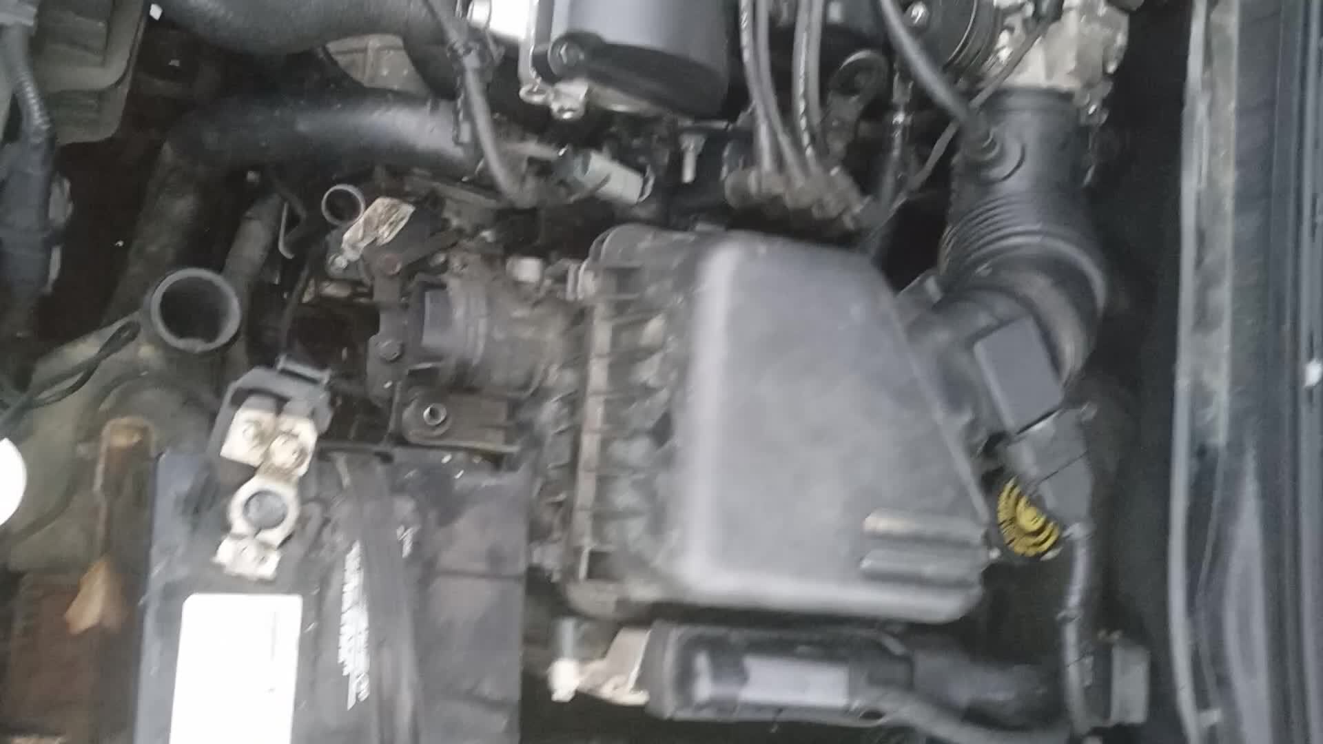

Cranks but does not start?
VICTOR JOHNSON
  • 2007 HYUNDAI ELANTRA
  • 2.0L
  • 4 CYL
  • 2WD
  • 225,890 MILES
I replaced the engine; the car started and ran as if the throttle was wide open, and I cut the car off and started it again and it did the same thing. I adjusted the throttle and cleaned the throttle body with carburetor and throttle body cleaner, and it has not started since. I have checked. It's getting fuel the timing belt is good. I replaced the crank sensor and checked the fire to the crank sensor and the injectors and the fire to the coil packs. Fire to the coil but no fire from the coil to the plugs.

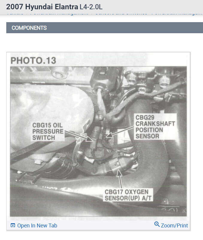

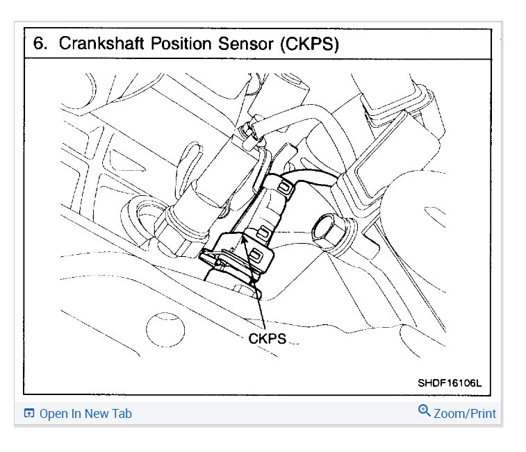

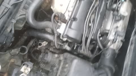

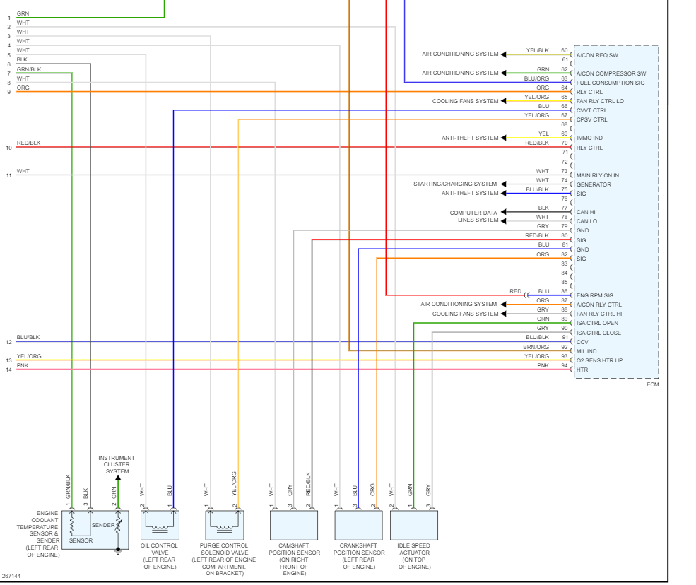

Thanks for the video, it sounds like the crankshaft angle sensor went out which there would be no codes for here is the location and how to change it out in the images below please let me know.
Friday, February 10th, 2023 AT 1:33 PM

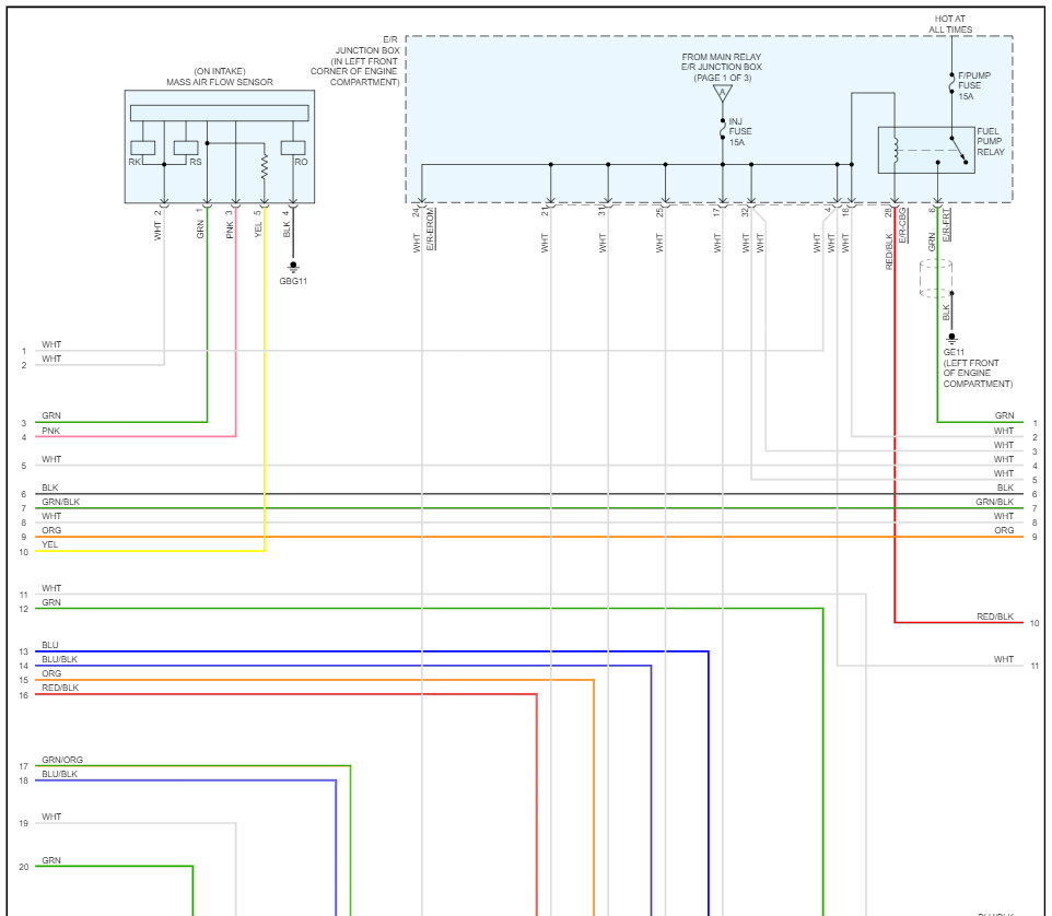

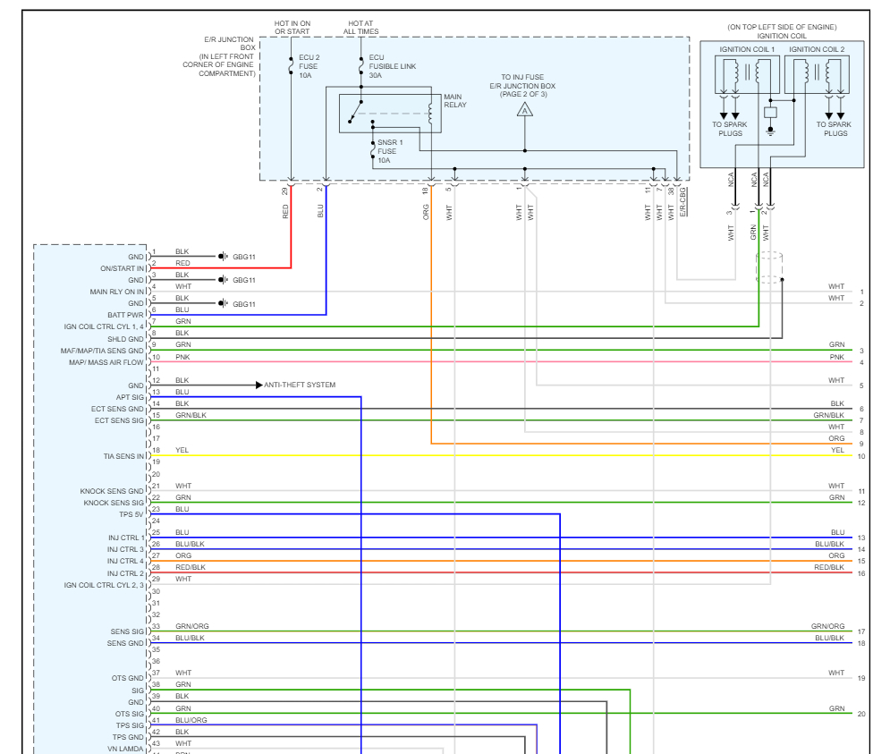

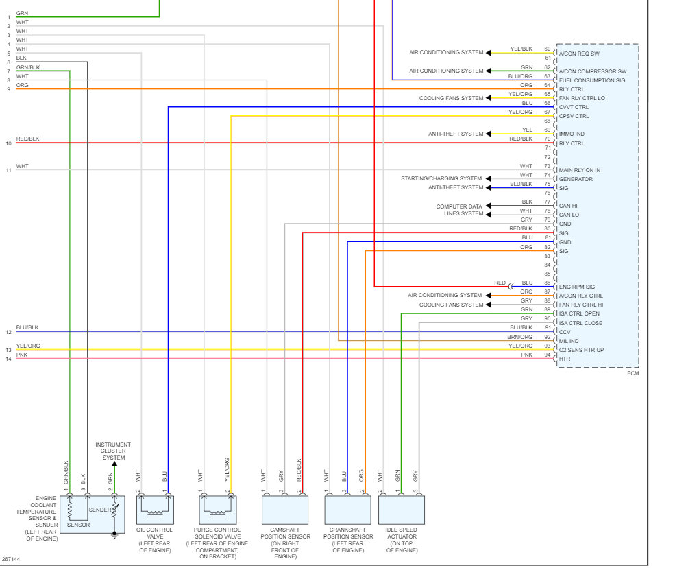

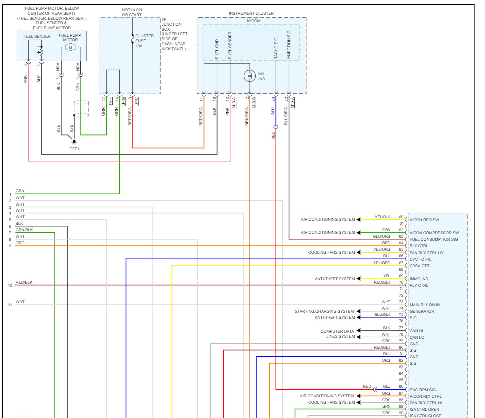

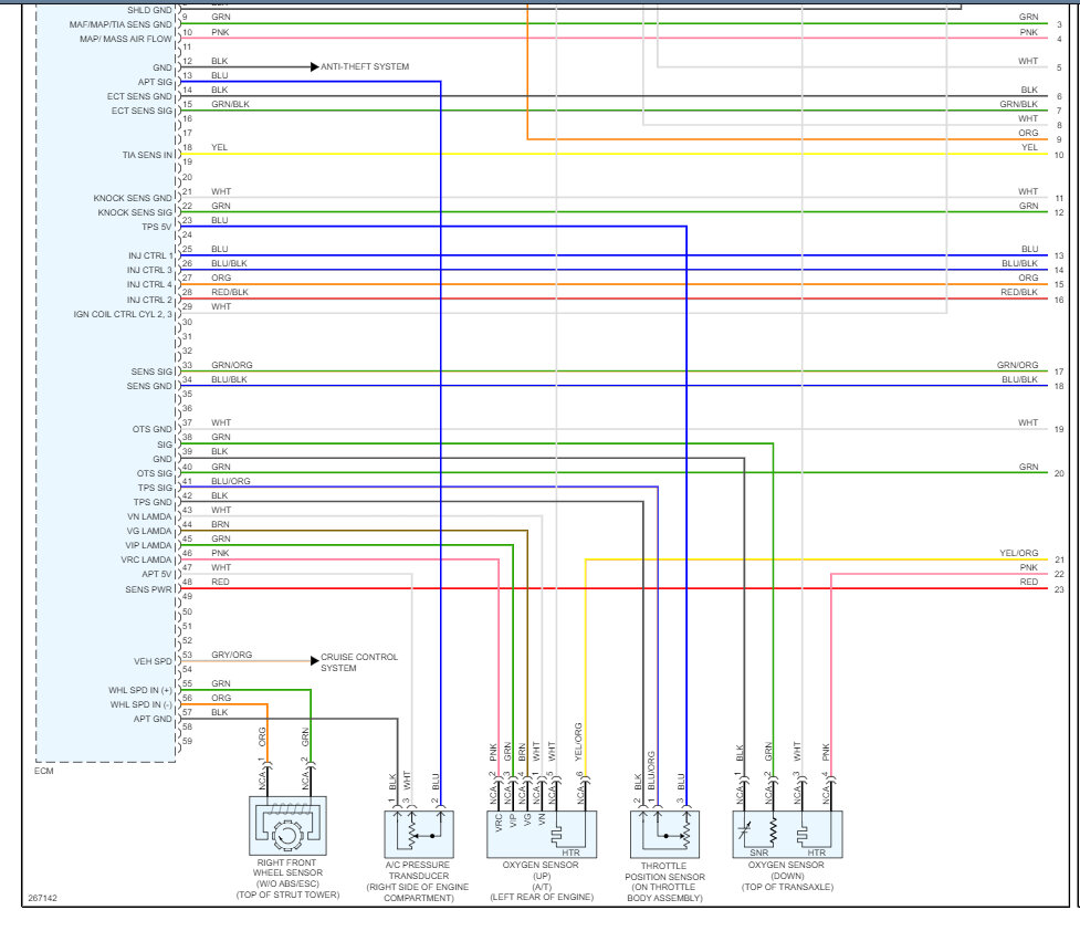

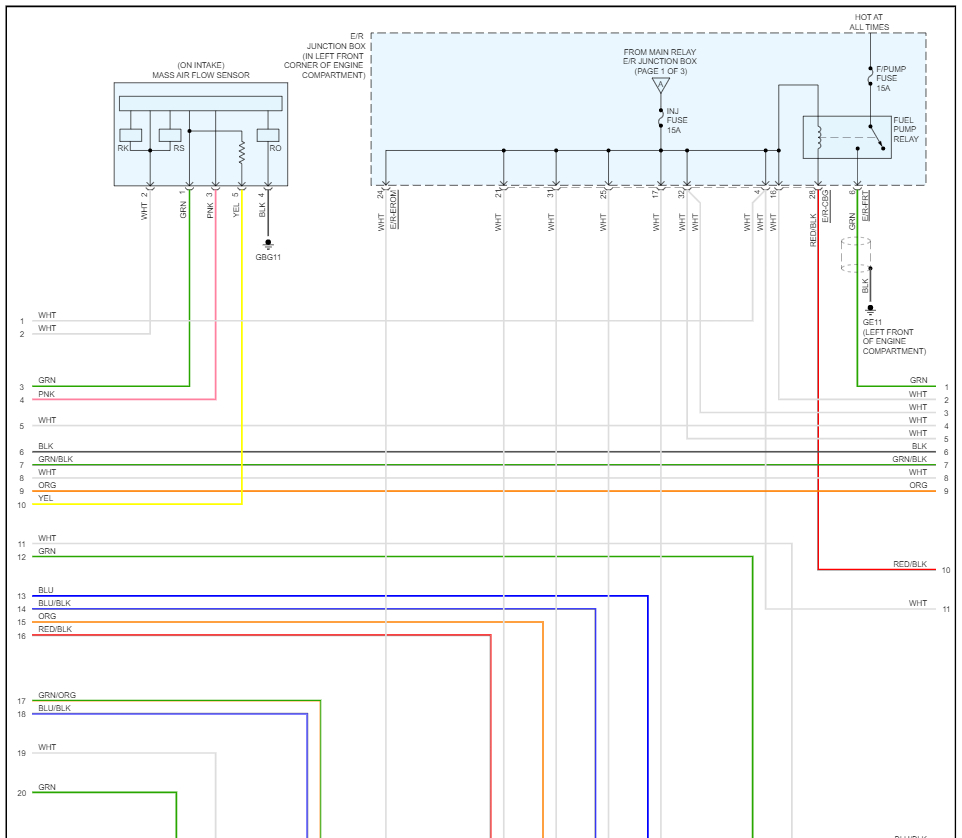

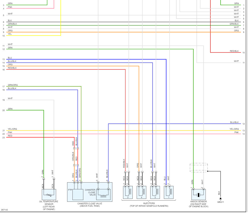

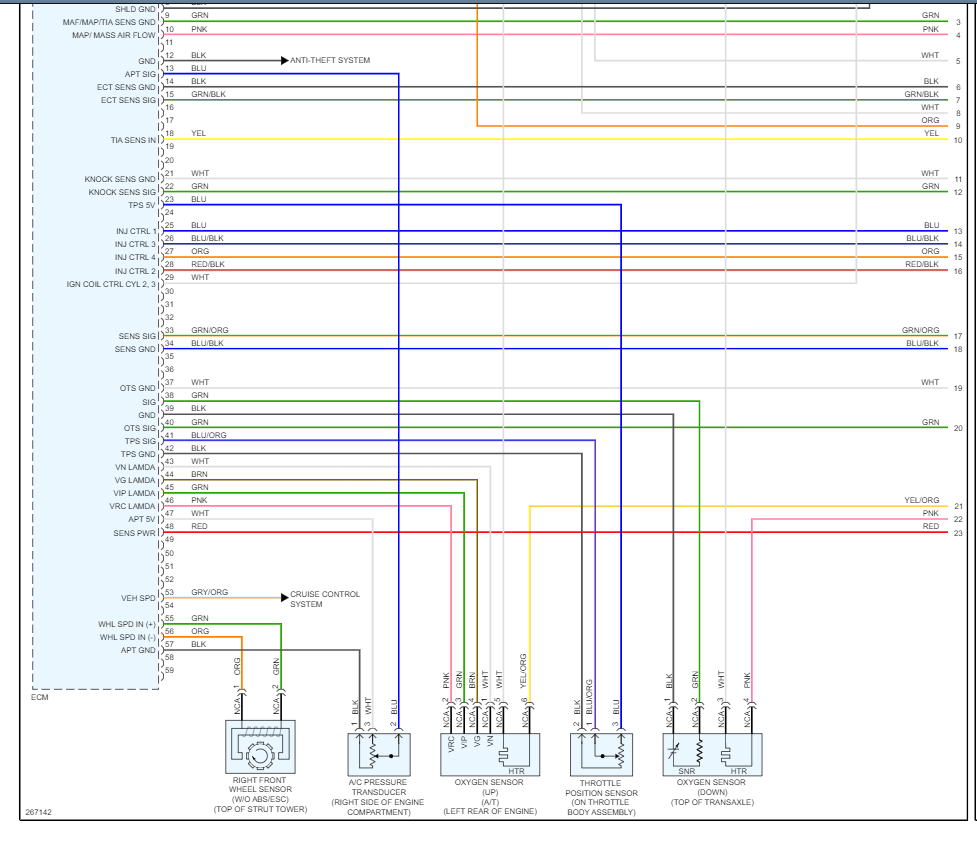

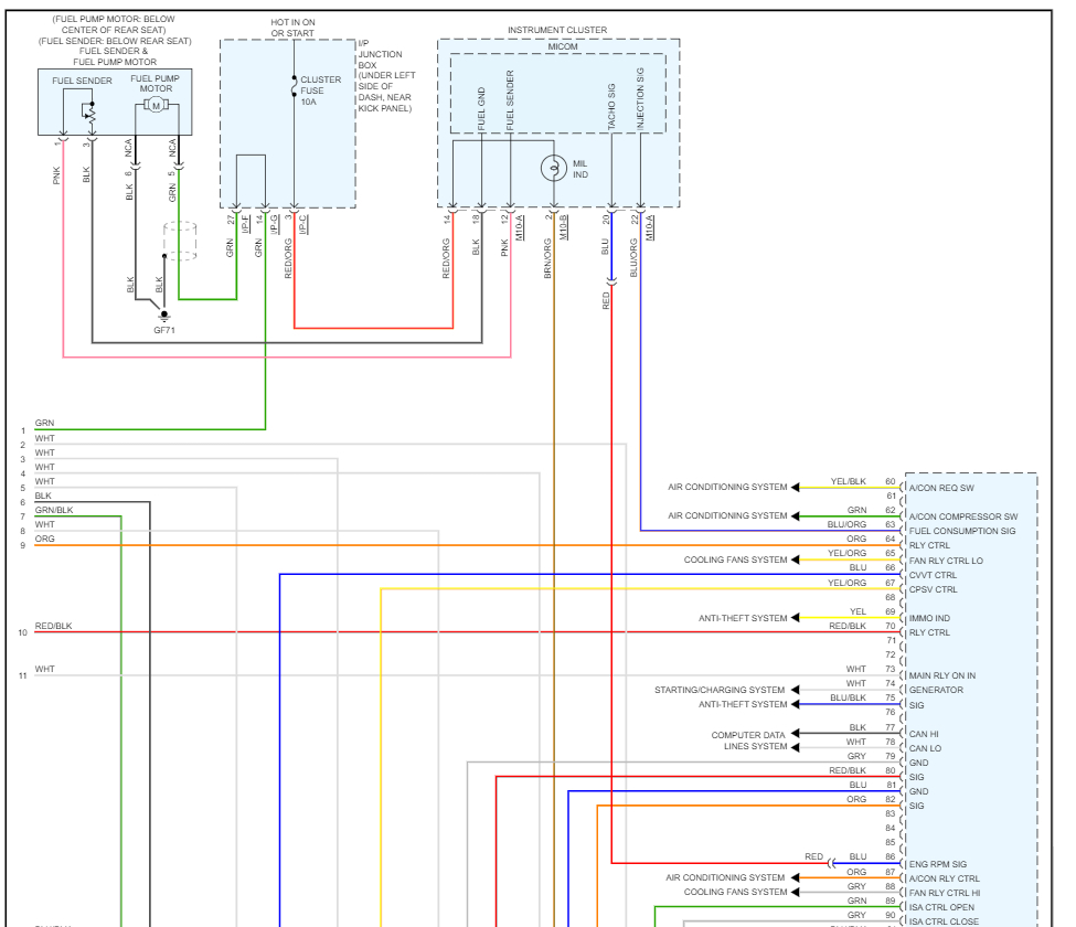

Sorry about that, let's remove the electrical connector from the coils and test the white wire for power when the key is turned on, I know there are two white wires, but one should have power. This guide can help, and I have included the engine wiring diagrams so you can see how the system works in the images below.
Saturday, February 11th, 2023 AT 1:12 PM
