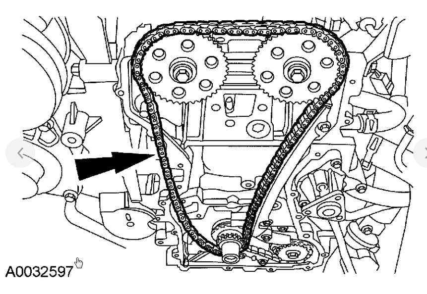

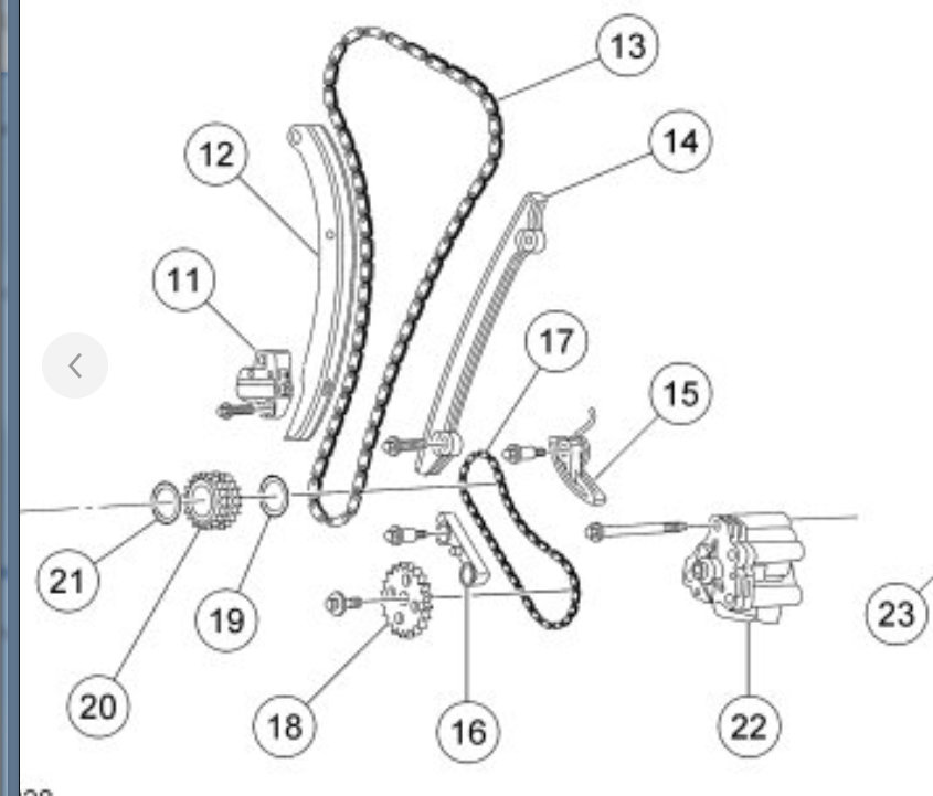

More than likely they will not get back to you as this was from over 5 years ago.
If you can get a video of this that will help. However, if I understand the cams and chain are turning but the crank is not turning?
I am not sure how this would be happening other then the fact that the
sprocket is broken or the crank is broken in another spot.
As you can see from the diagram below, the chain directly connects them so I suspect the sprocket or the key way has broken allowing it to spin but not turn the crank.
Getting a video of this will really help. Thanks

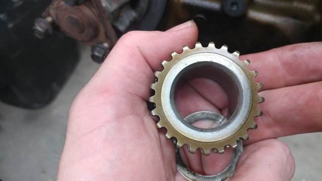

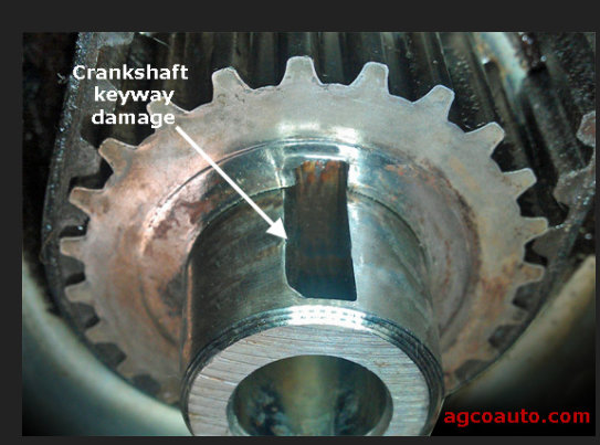

Okay. There should be a key way that goes in the snout of the crank. Then the gear has a cut out that goes over that key way and locks the crank snout to the gear.
I believe these are "removable" meaning the key way can come out of the snout. If this happens the crank snout and gear will no longer be locked together.
See the picture below of an example of this. I tried to find your crank but could not find one. This is just a picture of the key way with the slug missing as an example. Ignore the note about the damage. I did not make that.
-1
Sunday, May 23rd, 2021 AT 4:12 PM
CLARENCE KING
That's what I thought but no dice. Crank is smooth and sprocket isn't keyed.
Tuesday, May 25th, 2021 AT 2:03 PM
CLARENCE KING
I can now spin the gear around and around freely. I can also turn the crank and the gear still doesn't move. Would that be pressed in by chance? It slid right off with little to no effort and doesn't appear damaged in any way.

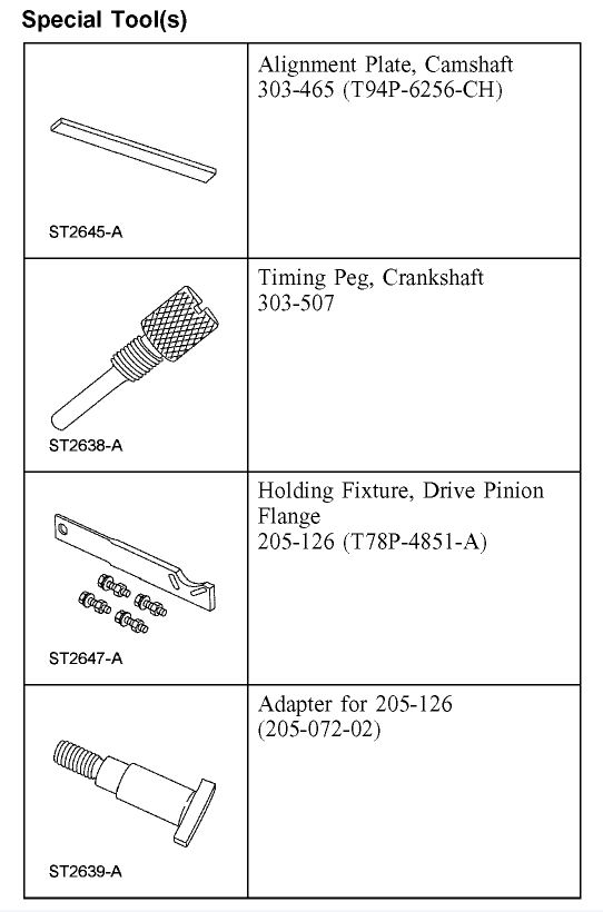

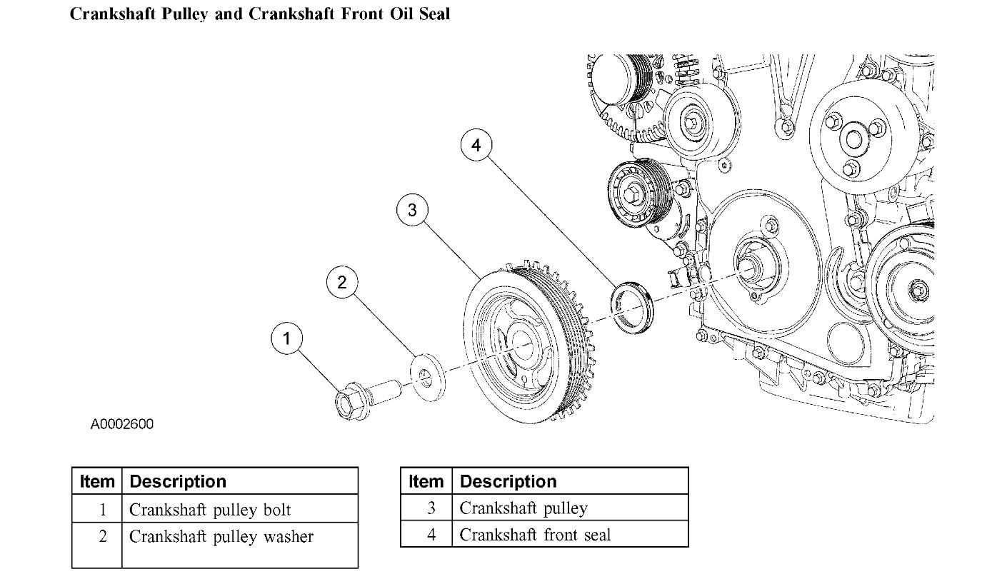

On that engine there is no keyway to retain the sprocket and pulley in position, it uses only the friction between the parts and the crankshaft coupled with the torque specification on the crank bolt to hold it in place. Ford wanted to save the money from cutting the keyway in the crank and broaching the pulley and gear to match. It has not been a good thing.
From the FSM - The crankshaft, the crankshaft sprocket and the pulley are fitted together by friction, using diamond washers between the flange faces on each part. For that reason, the crankshaft sprocket is also unfastened if you loosen the pulley. Therefore, the engine must be retimed each time the damper is removed. Otherwise severe engine damage can occur.

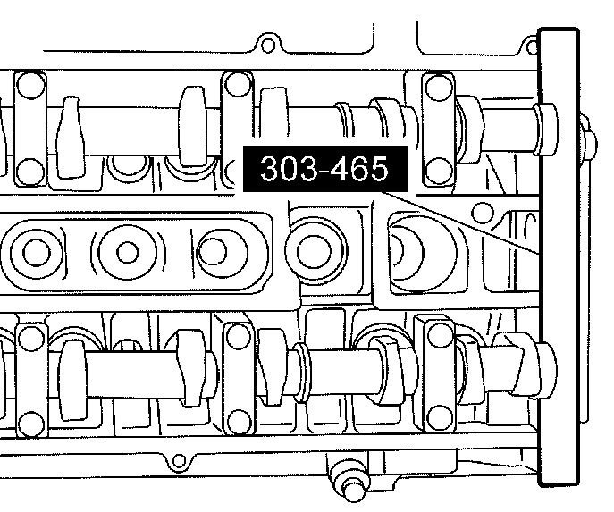

To repair it you will need to place the crankshaft into position and then set the cams in place and lock them both so they cannot turn. The factory special tools are the best items to use for this but it’s possible to make them if you are handy with some pieces.
It’s a very poor design that has caused more than a few engine failures when the bolt would stretch enough from heat cycling and the crankshaft gear would turn and the end result was valve damage from the now out of time condition. What I normally do isn’t listed in the book but it can help, I clean all of the surfaces very well with brake cleaner, then apply Loctite bearing and sleeve retainer compound to the crank snout. Then put the crank sprocket in place, then another dab and install the front pulley. Then torque it down. Without anything else to hold the parts that compound will help hold it in position.

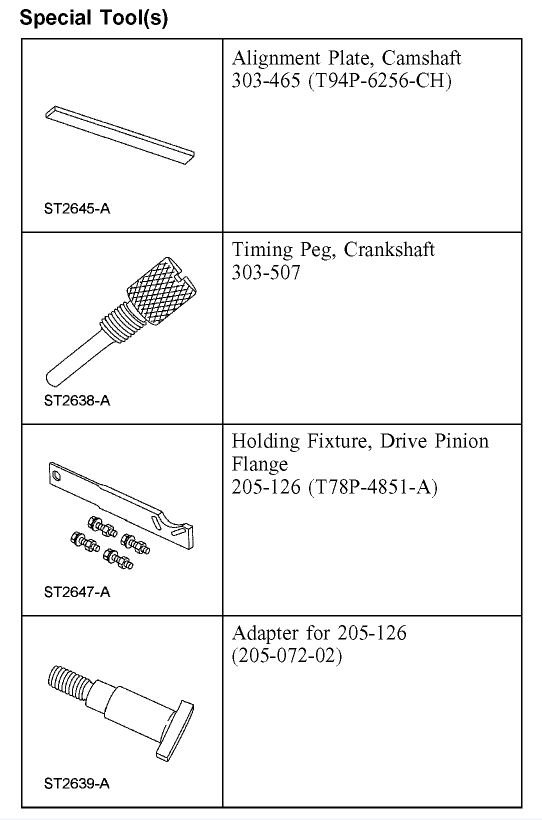

The attached show the tool list and where they are used. They hold all the parts with the crank at TDC and cams in time.
Turn the crankshaft clockwise to position the No. 1 piston at TDC. Only turn the crankshaft clockwise.
The camshaft timing slots are offset. If the special tool cannot be installed, rotate the crankshaft one complete revolution clockwise to correctly position the camshafts.
Install the special tool in the slots on the rear of both camshafts. (303-465)

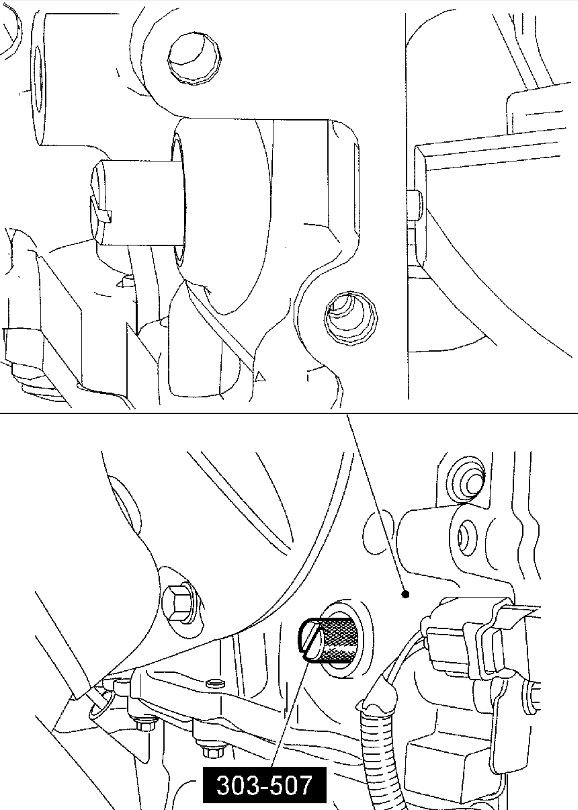

Remove the engine plug and install the special peg tool (303-507)
The special tool will contact the crankshaft and prevent it from turning past TDC.
Failure to hold the crankshaft pulley in place while loosening the bolt can result in damage to the engine.

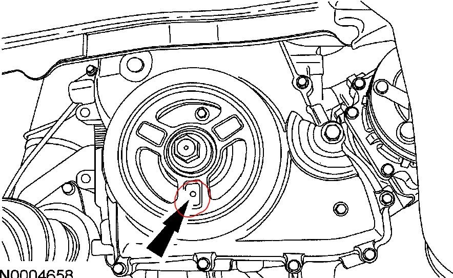

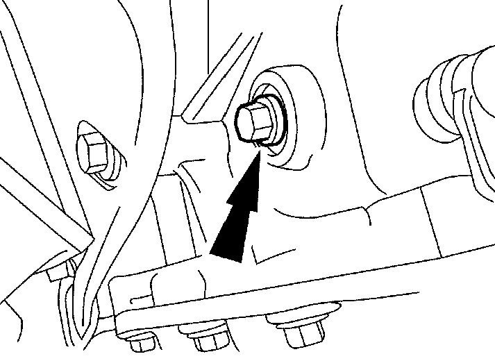

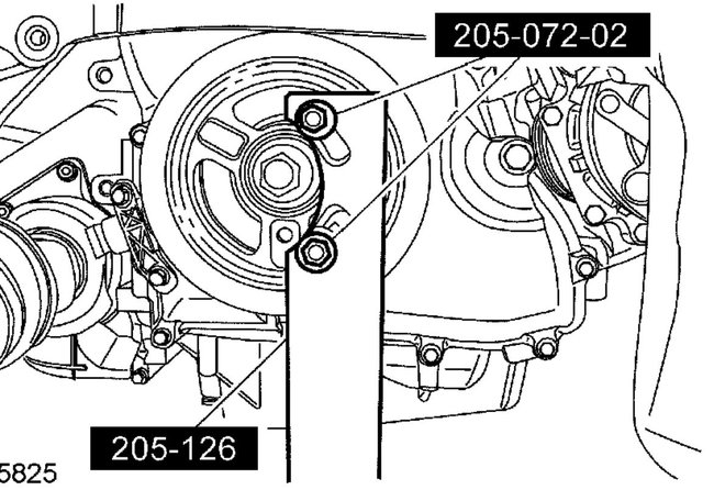

Install a standard 6 mm x 18 mm bolt through the crankshaft pulley and thread it into the front cover. With the bolt at 6 o'clock the pulley will be in time at TDC.
Now install the pulley locking bar. (205-126)
Now with everything in place and locked in position you the torque the crank bolt to 74 ft lb for the initial step, then torque it an additional 90 degrees.
Now remove the special tools and rotate the engine over twice and back to TDC, try to install the cam tool and the front pulley bolt and the locking pin. If they all drop into place easily the engine is in time and you should be done with that part of the process.
