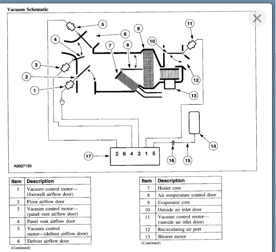

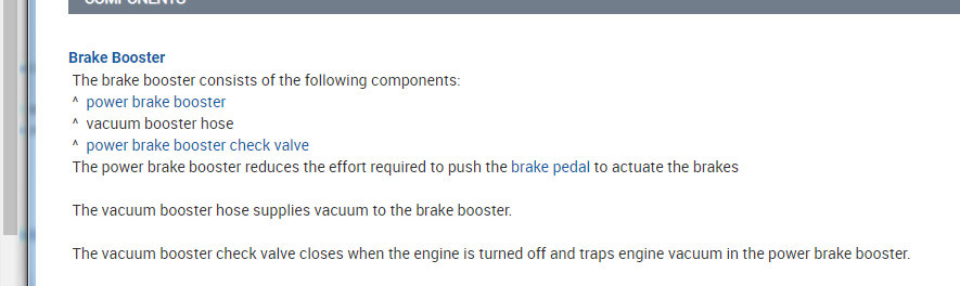

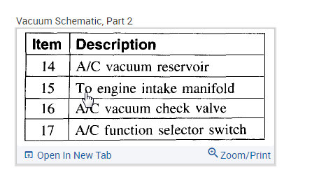

Looking for diagrams and help finding idle and acceleration problems?
Monday, April 28th, 2014 AT 1:52 PM
MECHANIC
18,907 POSTS
Here are some guides that will help with finding the possible cause of this which is most likely a vacuum leak:
https://www.2carpros.com/articles/engine-surges
I attached the diagrams but I suspect it is just a leak around the intake manifold area.
Let us know what questions you have. Thanks
