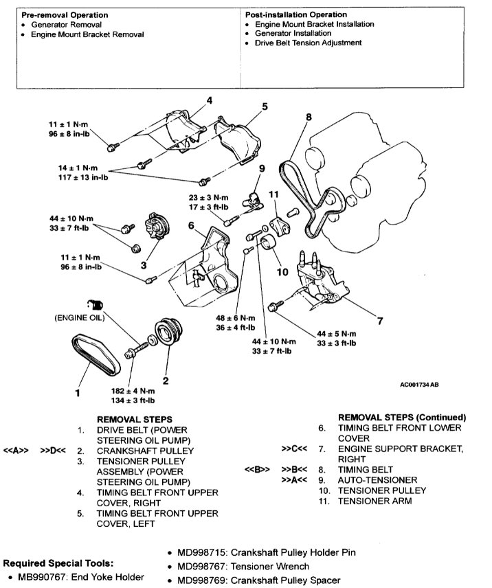

There was a loud knocking/tapping sound I think it was coming from the timing chain stabilizer bar, then after I turned it off it wouldn't start again. So, I have changed timing belt (all the belts) cam shaft sensor, distributor, water pump, and fuel pump, and I cannot get it to start. Any suggestions?

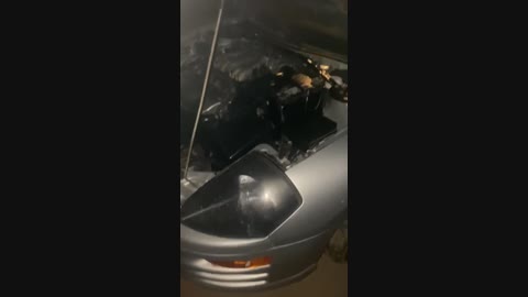

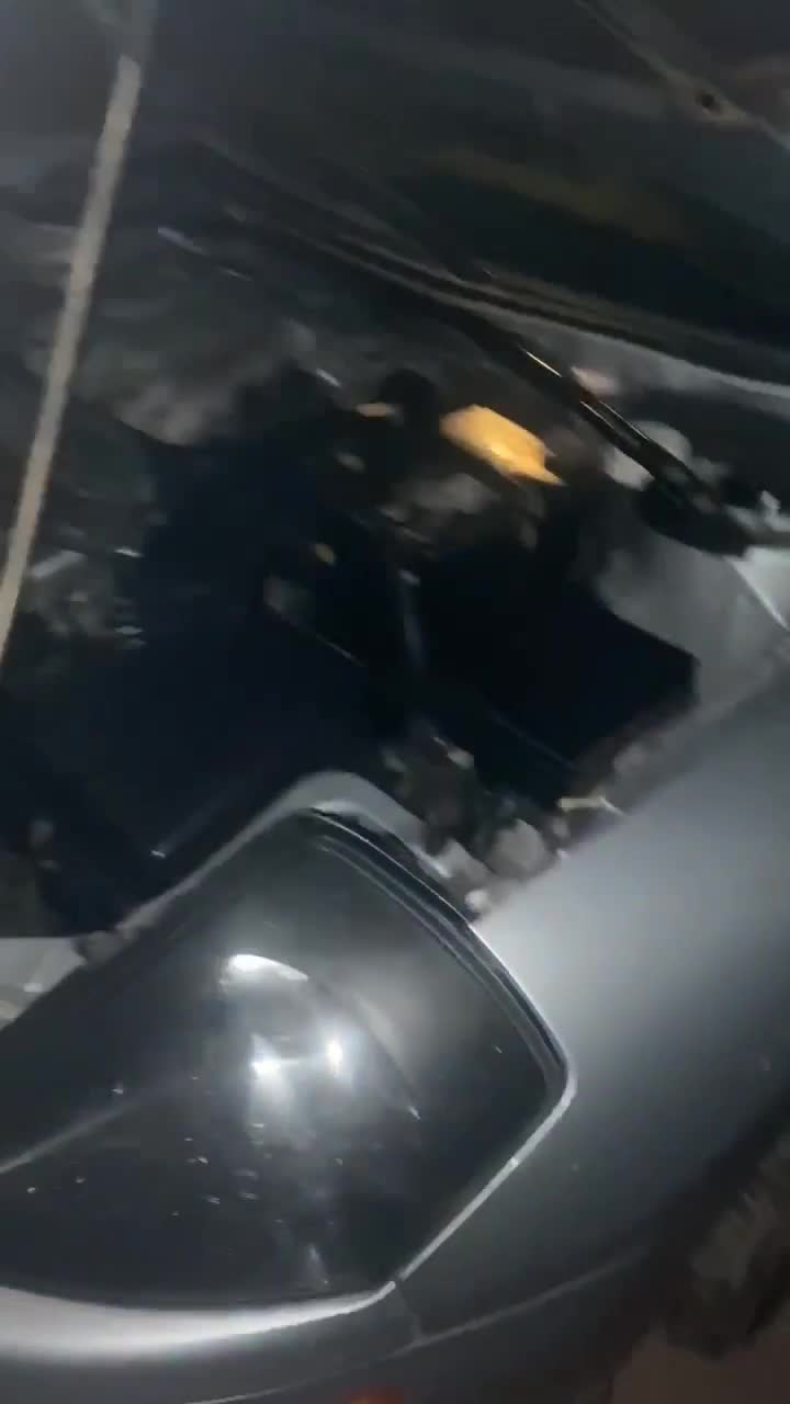

Well, directly after I posted this question it turned over, I'm not sure what the problem was because when it was all said and done one of the relay's was not put back in the proper "slot" (my roommate and Boyfriend are doing the work. I'm not a mechanic, i'm simply relaying the information, but I did discover the relay out of place) my boyfriend says he thinks it's out of time now, because although it starts now it's barely stays running. Please listen to the video? What could it be now?

It almost sounds like something is broken/loose inside.
The fluctuation of the engine speed could be due to a vacuum leak.
Let's start with basics, make sure the oil is at the correct level.
Also is the check engine light illuminated.
If so scanning and retrieving the code(s) can be helpful.

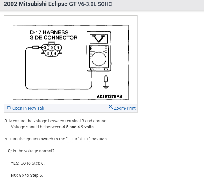

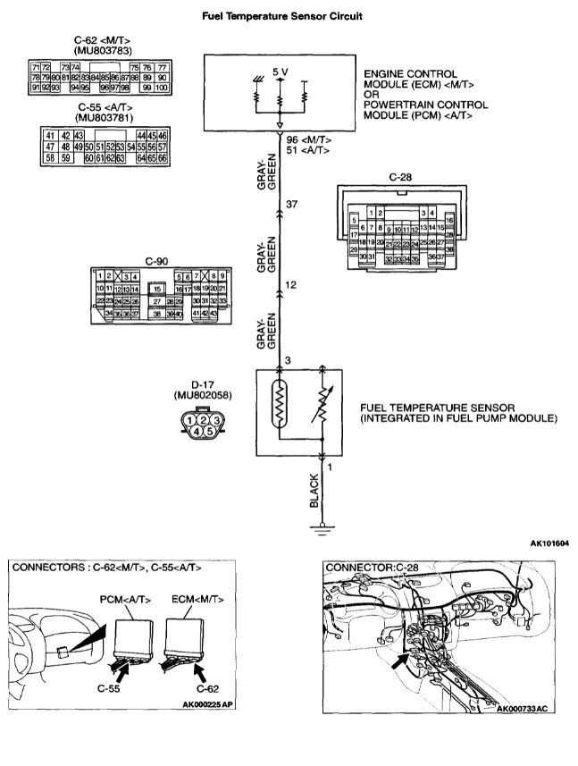

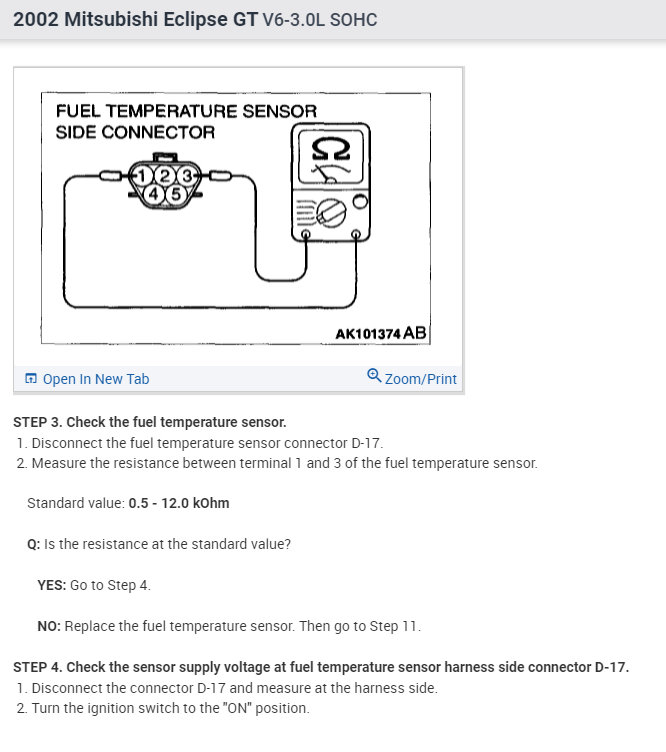

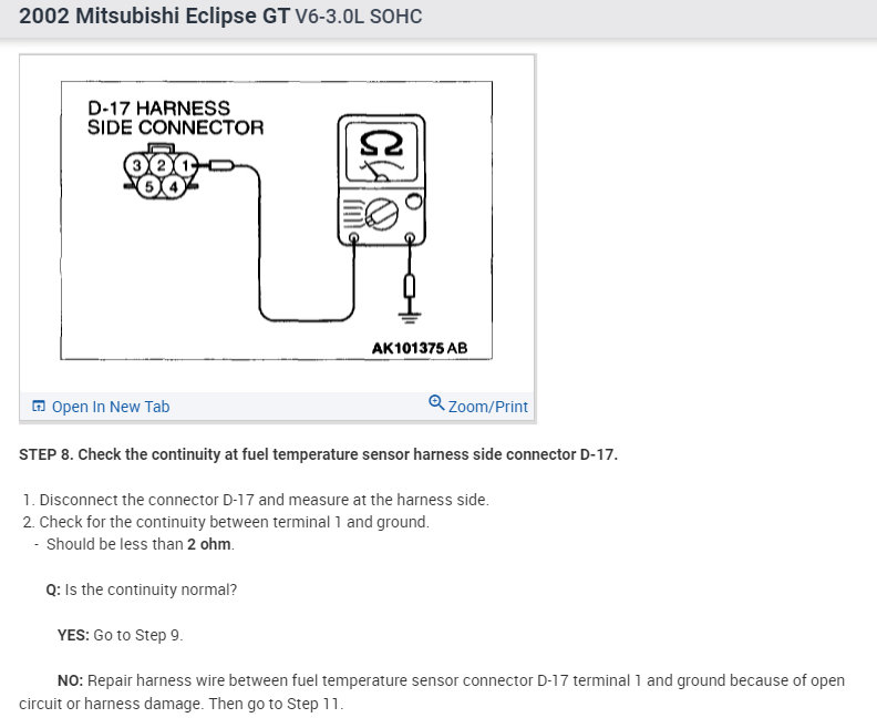

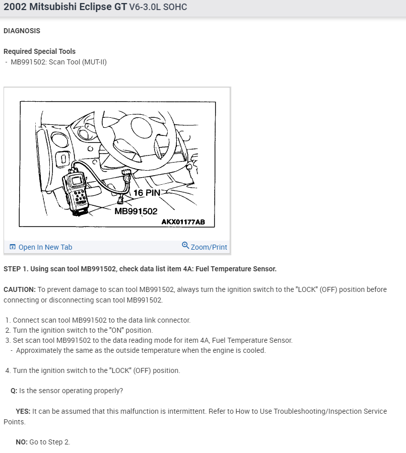

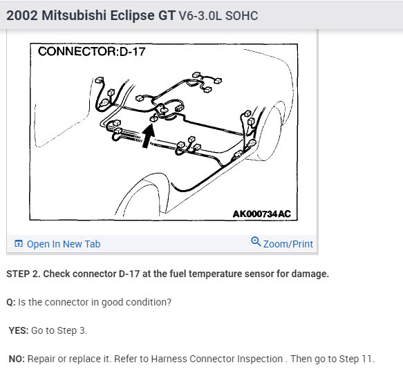

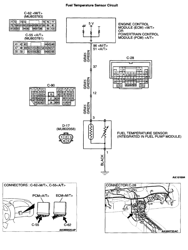

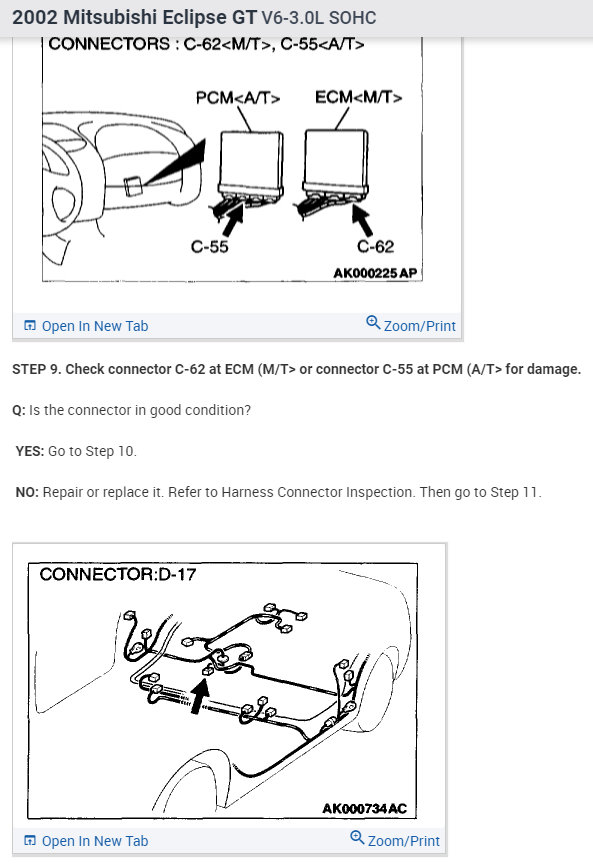

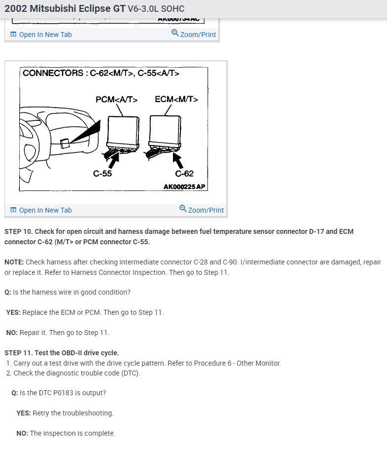

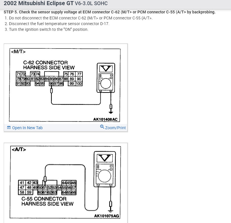

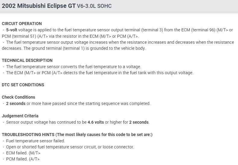

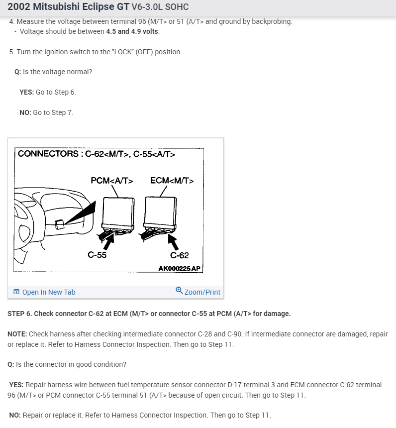

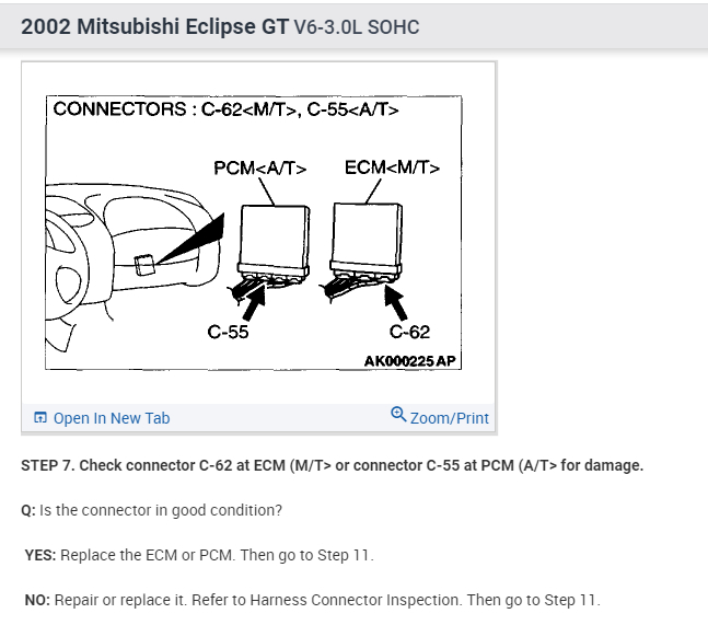

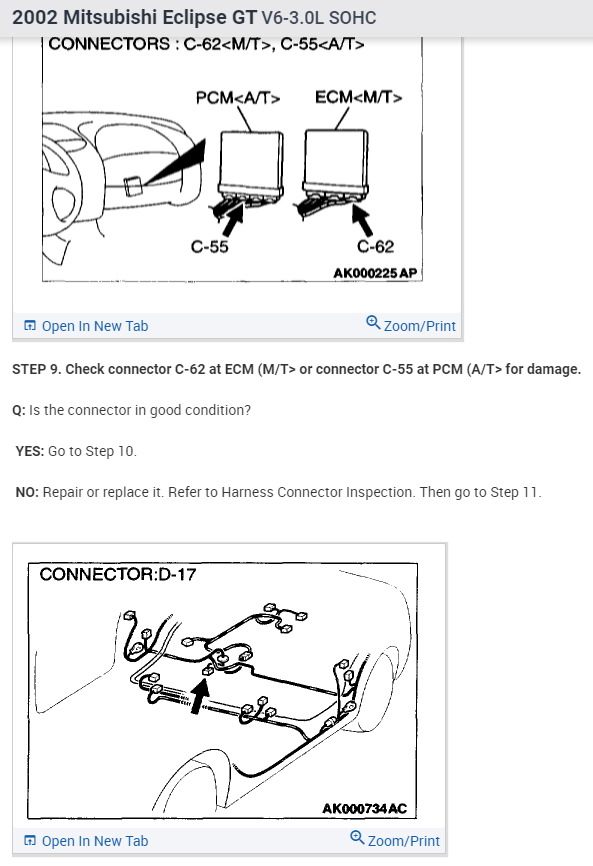

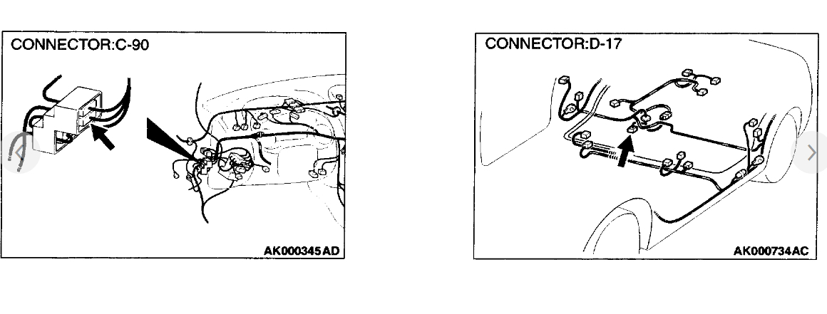

The fuel temperature sensor is integrated with the fuel pump module.
The code P0183 is typically due to a wiring issue.
I have attached the diagnostic steps for code P0183 below.
Following these steps can help you determine the cause of the P0183 code.

So, did the timing belt get changed?
The vehicle can jump time if the belt is worn or loose. It can also jump time due to a weak tensioner for the timing belt.
