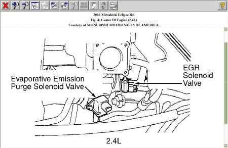

I was just wanting to know if you have pictures that I can see to determine which is my EGR and also which is my fuel pressure regulator on my 2002 mitsu eclipse rs(2.4L). I cannot find a repair manual locally for my vehicle. They say that it has come out yet.

You can download your manual here. See below for EGR and for t
https://www.2carpros.com/forum/automotive_pictures/12900_egr_1.jpg
he fuel pressure regulator should be on the fuel rail end-
