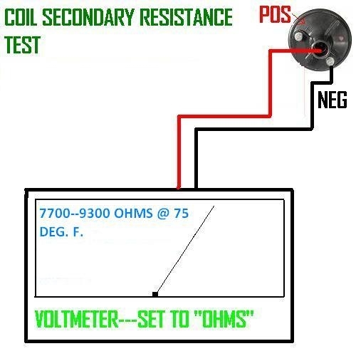

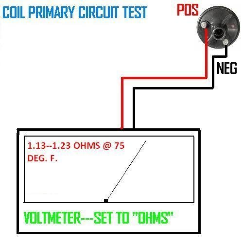

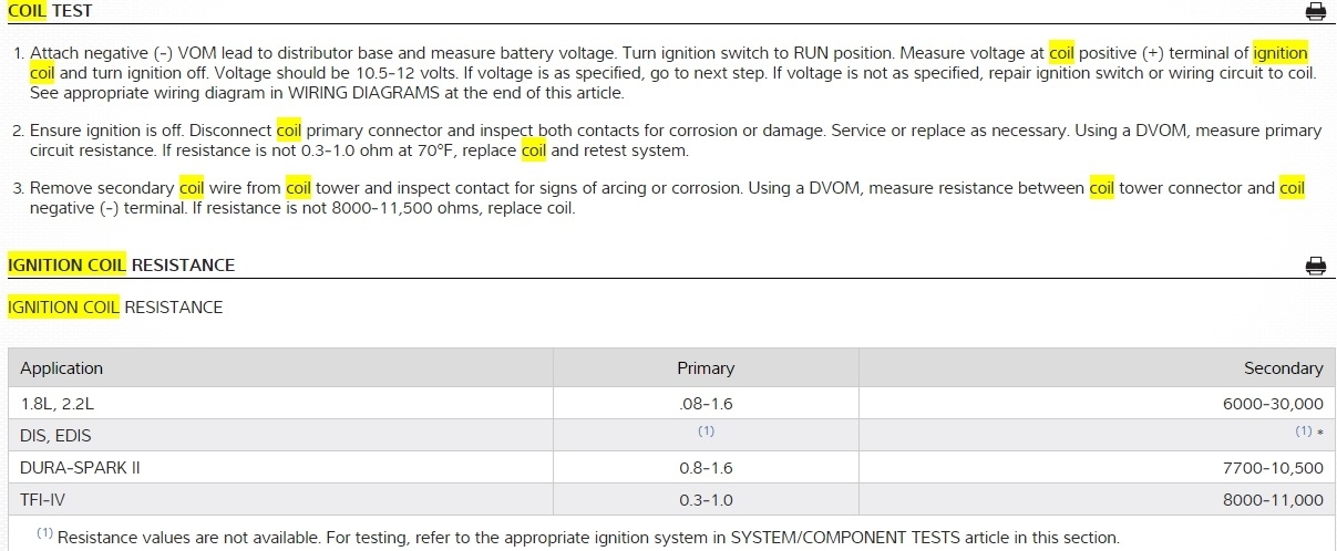

BELOW, I SCREENSHOT THE TEST FOR THE COIL (IF YOU DON'T UNDERSTAND IT LET ME KNOW. I AM ALSO INCLUDING 2 PICTURES OF HOW TO TEST A "REAL COIL", AS I AM A OLDER JEEP KIND OF GUY, I HAVE NOT GOT AROUND TO MAKING A PICTURE FOR THIS NEWER STUFF YET. IT IS THE SAME TEST PROCEDURE, JUST A DIFFERENT LOOKING COIL (MINE HAS DIFFERENT OHM VALUES).
