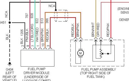

JOHN_35120
  • 12 POSTS
Okie Dokie.I checked everything out. Got to looking and found the Fuel Pump Driver Module. Replaced it. Got power. But for some odd reason the power going to the fuel pump got hot and started melting. . Unplugged fuel pump and turned the key over and got power to my meter. The wire did not get hot then. There was a naked spot on the power wire in the fuel pump. LOL Thx to me... Could that be grounding out or shorting out In the fuel tank? Thanks John
Nov 27, 2019 at 6:57 PM (Merged)
MASTERTECHTIM
  • CAR REPAIR CONTRIBUTOR
  • 4,750 POSTS
absolutely. something is wired backwards or arcing out.

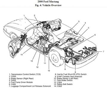

If inertia switch is OK then inspect fuel pump driver module.
https://images.2carpros.com/forum/automotive_pictures/261618_Noname_494.jpg

I wouldn't replace anything, without checking fuel pressure. I asked about that in the first post. My hearing is no good, I can't listen for the pump. I have to check fuel pressure and amp draw for the pump.
I just wanted to add, the voltage and ground for the fuel pump motor comes through the pump driver module. You have to have both voltage and ground or the pump motor won't run. I believe the ground is a duty cycle, switched on and off. If there is something wrong with the system, a code should have set. Whether it will or not is a different story.

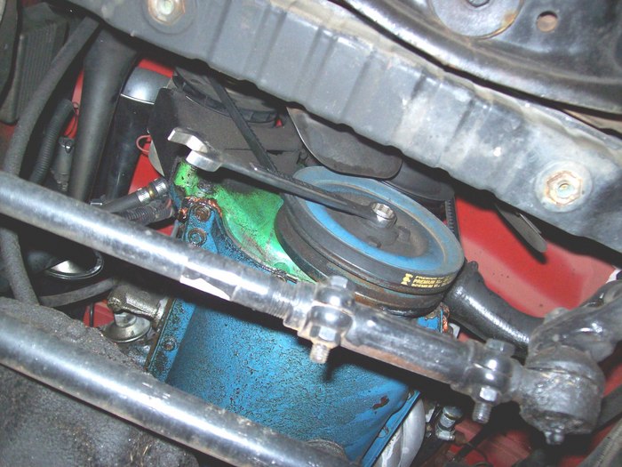

CJ MEDEVAC
  • 11,004 POSTS
Say it won't turn over
Let rule out "seized up"
"key off"
See if you can rotate the engine with a wrench--one full revolution (or more).....put a mark on your harmonic balancer so you will know when you get there
I demonstrate in pic, with my jeep cj 5 engine
The medic
