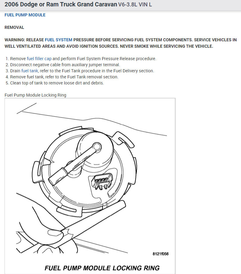

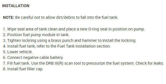

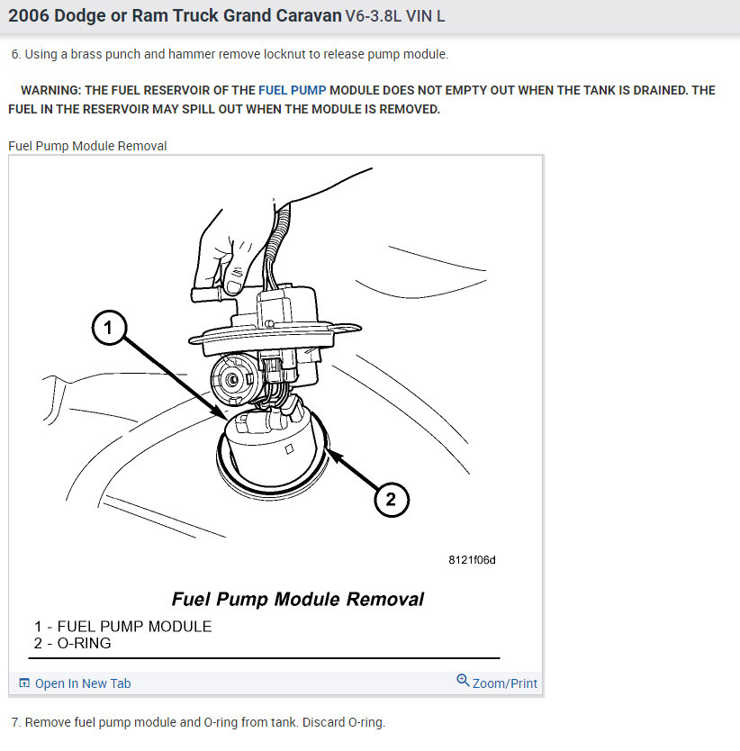

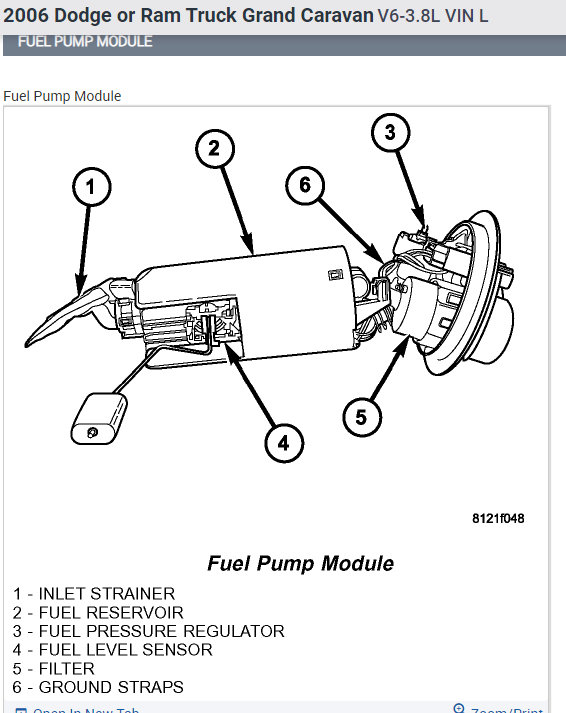

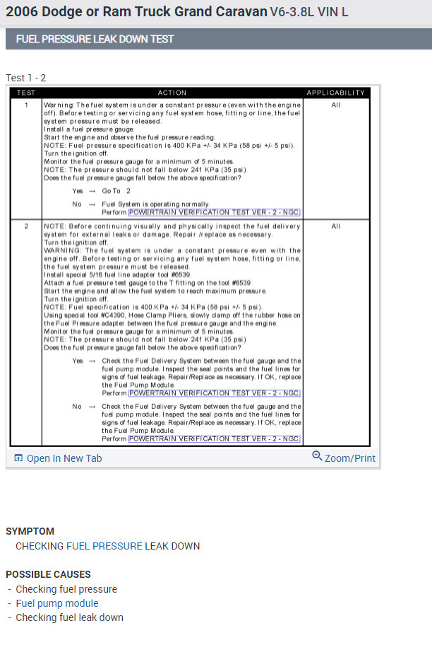

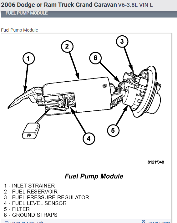

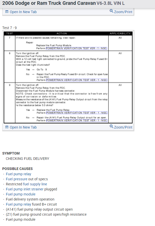

As the engine ran out of fuel the pump could have picked up debris from the bottom of the tank and clogged the system. If the fuel pump strainer picks up debris it will stop or limit fuel from passing through the pump.

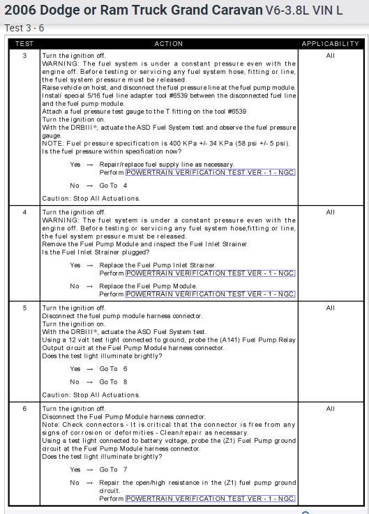

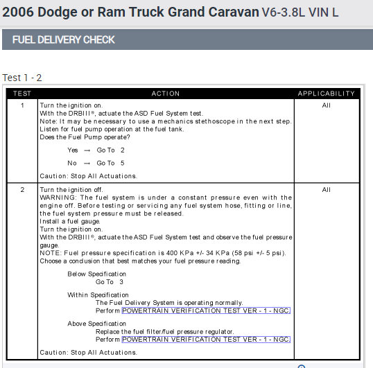

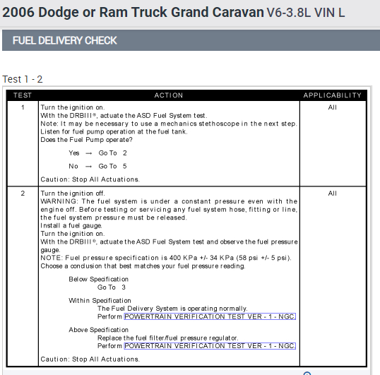

This vehicle should have 58 PSI (+/- 5 PSI) of fuel pressure.
Here is a helpful video of how to check fuel pressure:
https://youtu.be/aITQclp7zIE

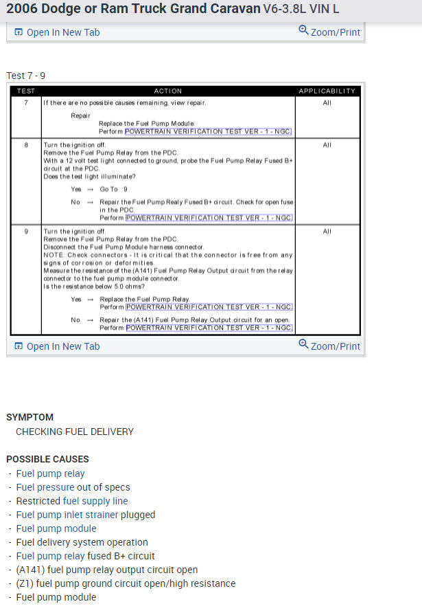

I have attached the step by step instructions of the fuel delivery check and fuel pressure leak down check. That way you will have enough info to go by.
Thursday, August 12th, 2021 AT 8:16 AM
WILLT1963
  • 9 POSTS
Thank you. Looking to not have to drop tank. I will look at info you provided and get back as soon as I have.

With the limited time I am having I was only able to check one more thing. I pulled the fuel line off the injector rail right below the throttle body. I put it into a clear bottle to be able to see it "key on pump prime" only gives a trickle of fuel when the key is turned with no improvement while cranking. Only getting a trickle of fuel. That tells me a bunch. Dropping the tank on Saturday morning (well that's the plan anyway).

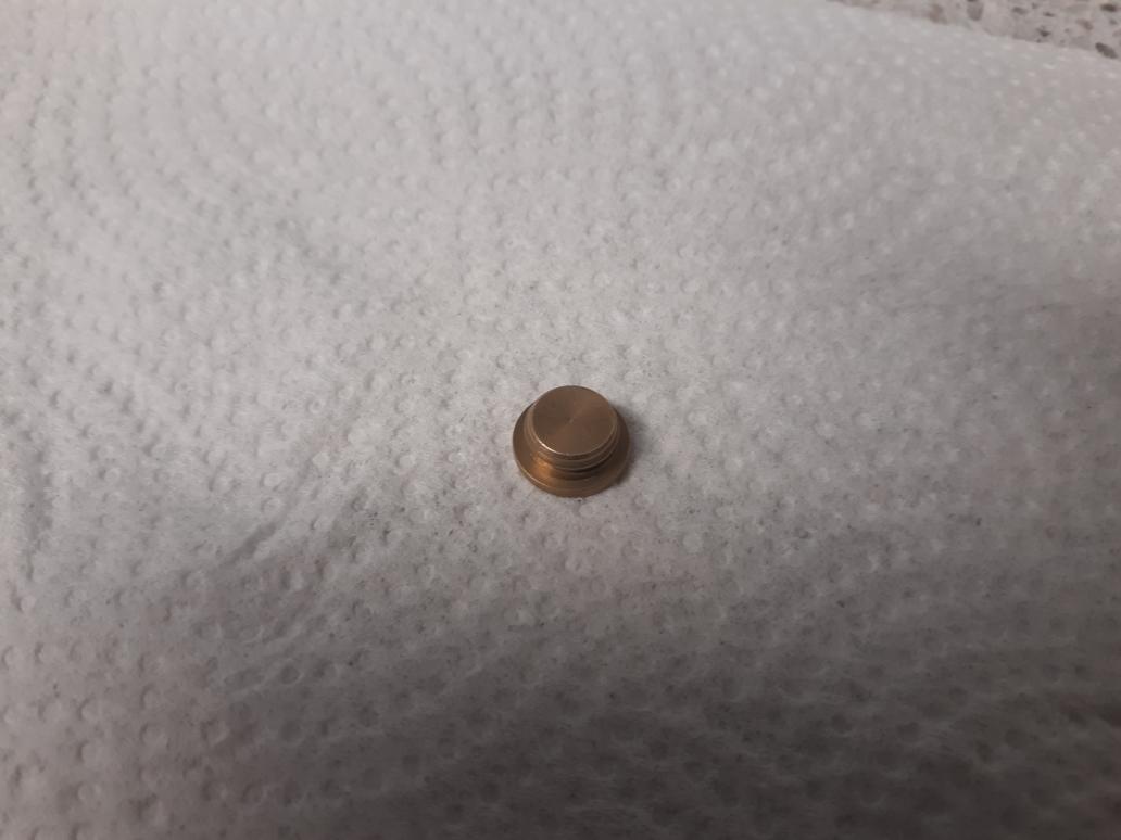

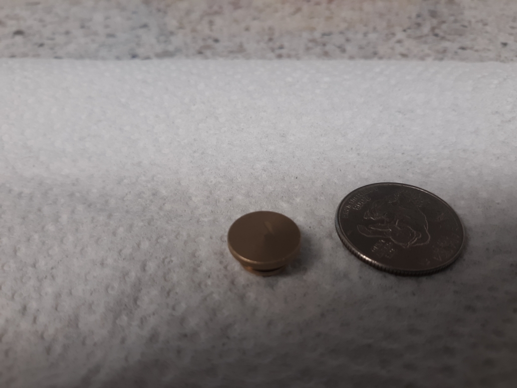

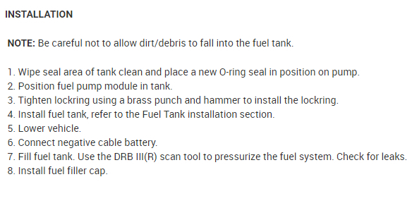

Changed the fuel pump cleaned it out real good. Old pump looked ok but we knew it was not. Primed it 2 times. 3rd turn of key cranked and started. Found a brass disk in tank. What is that!
Monday, August 30th, 2021 AT 10:19 AM
WILLT1963
  • 9 POSTS
Picture added for size comparison. Now comes new rotors and pads. Inspection and registration.

That brass fitting is puzzling. There should not be anything in the tank that will need a brass fitting.
Glad you got the fuel pump done.
