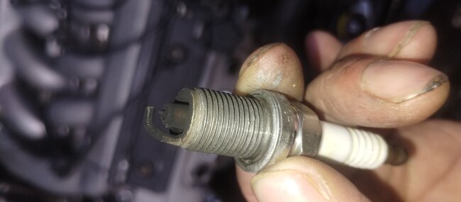

CHRISTOPHER IVAN ROEDER
  • 156 POSTS
I just replaced my spark plugs probably a little over a month ago but I'll pull them all and check and I'll let you know, I do have a new EGR valve on the way tomorrow as well
  • 156 POSTS
Is this what you mean by carbon fouled?
Wednesday, September 10th, 2025 AT 4:35 PM
KEN L
  • MASTER CERTIFIED MECHANIC
  • 55,535 POSTS
Yes, that is carbon fouled, I would install new spark plugs.
Wednesday, September 10th, 2025 AT 5:42 PM
  • 156 POSTS
Ok what usually causes them to be like that?
Wednesday, September 10th, 2025 AT 9:41 PM
KEN L
  • 55,535 POSTS
Too much fuel or no/low compression.
