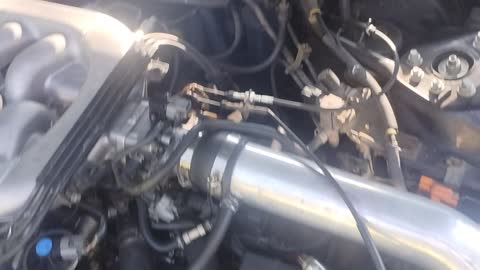

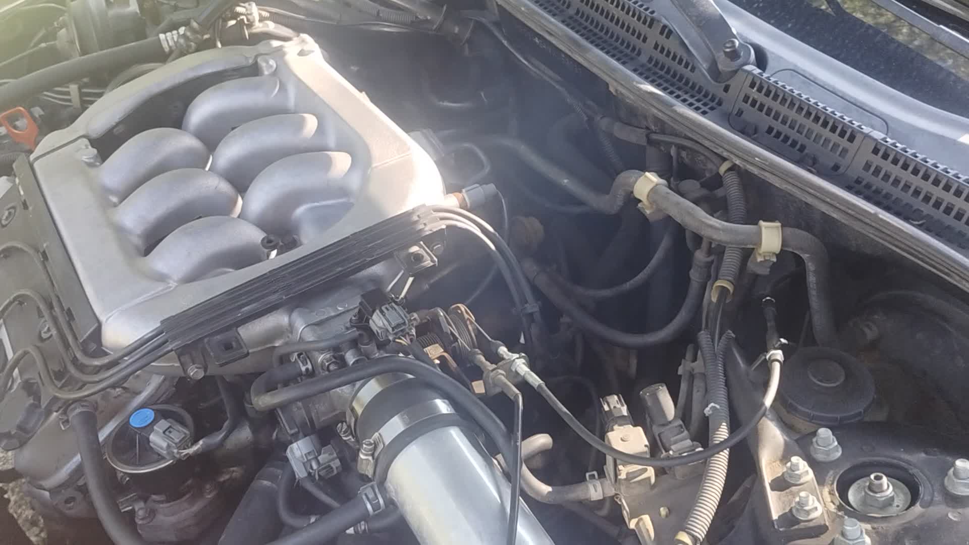

I still need to go get the tester to do the compression test but this is a video of what it was doing when I started it this morning it was putting out some smoke not sure from what but it was coming out of the engine bay and the tailpipes. Didn't know if this would lead us anywhere
Sep 7, 2025 at 8:13 AM
  • 54,494 POSTS
I would remove the air filter and try to run the engine again. Thanks for the video it helps.

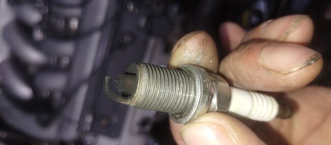

CHRISTOPHER IVAN ROEDER
  • 156 POSTS
Is this what you mean by carbon fouled?
Sep 10, 2025 at 4:35 PM
  • 54,494 POSTS
yes, that is carbon fouled, I would install new spark plugs.
Sep 10, 2025 at 5:42 PM
  • 156 POSTS
Ok what usually causes them to be like that?
Sep 10, 2025 at 9:41 PM
  • 54,494 POSTS
Too much fuel or no/low compression.

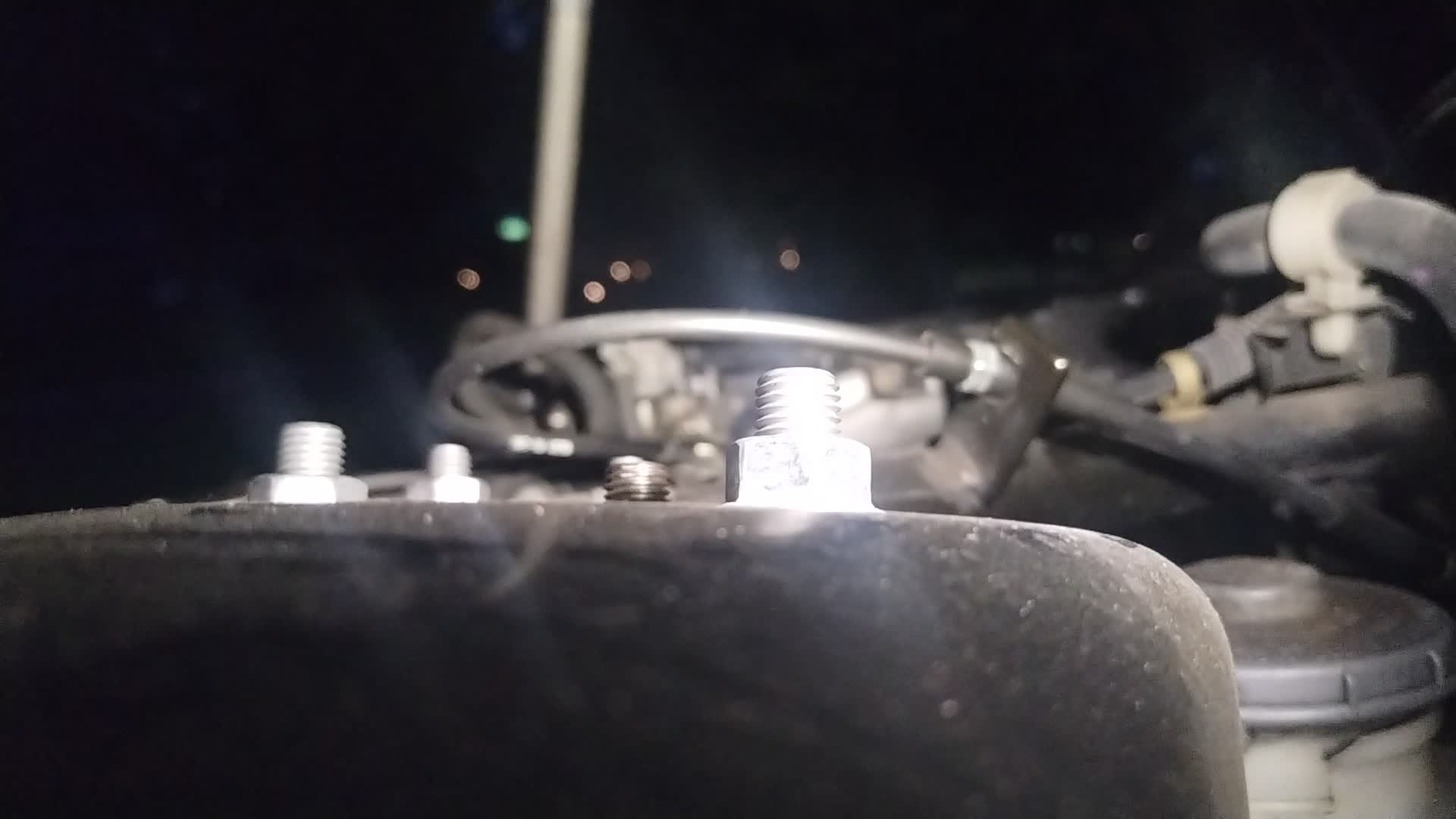

I have a spark plug wire that is broken to the distributor cap
Sep 13, 2025 at 2:37 PM
  • 54,494 POSTS
I would fix that to see if it helps. Can you upload an image?
