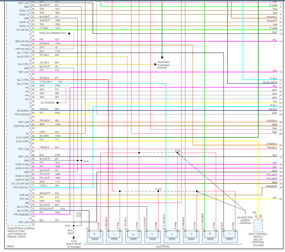

Hello, I have an 8.1 vortex with crank no start problem here’s the result of all my diagnostic.
Have 62 psi of fuel
Getting strong spark
12v at the injector
All fuse and relay are tested and are fine
Crank replaced cam replaced MAF replaced are tested and are okay.
The point is I’m not getting ground pulse to the injector and if I test with my multimeter directly on the injector connector sometime 0v or 6v on all injector but something weird happen it’s been like 3 month since I have tried to started and I notice that the cluster wasn’t show the mileage and my interior mostly disassembled (cause it’s a project truck but before send it to paint shop I want all work perfectly to when I’ll reassemble the truck after the paint )and I see the 3 wire connector on top of the ignition switch and I unplugged et plug back in the mileage comeback and before that the vats system has already been disabled I’ve already with a security problem and I know that’s not the case now and seriously I do not think it’s PCM cause I know a PCM on those truck last the life of the truck.

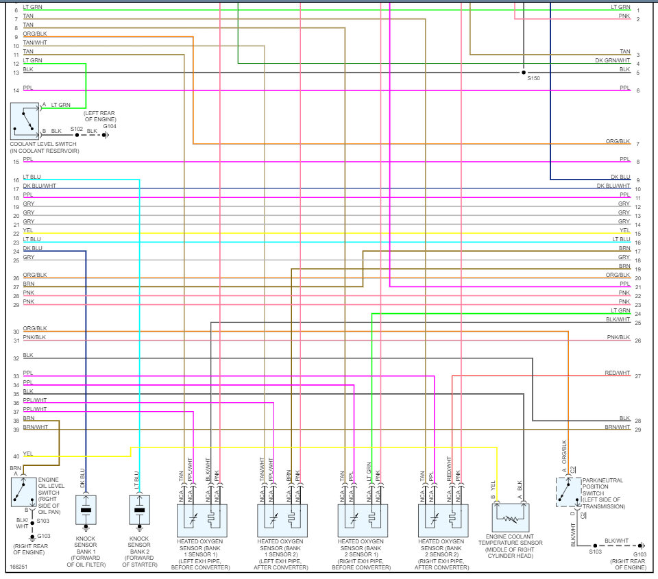

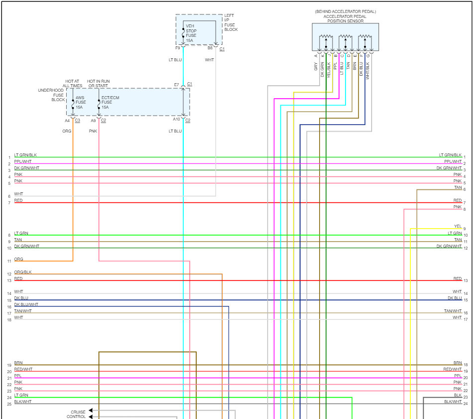

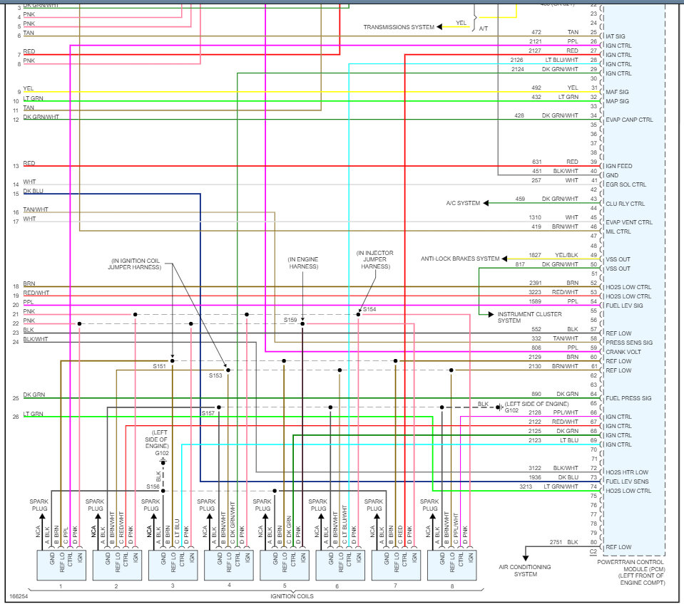

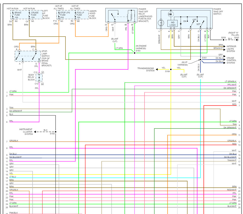

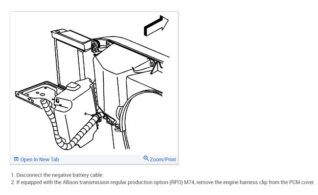

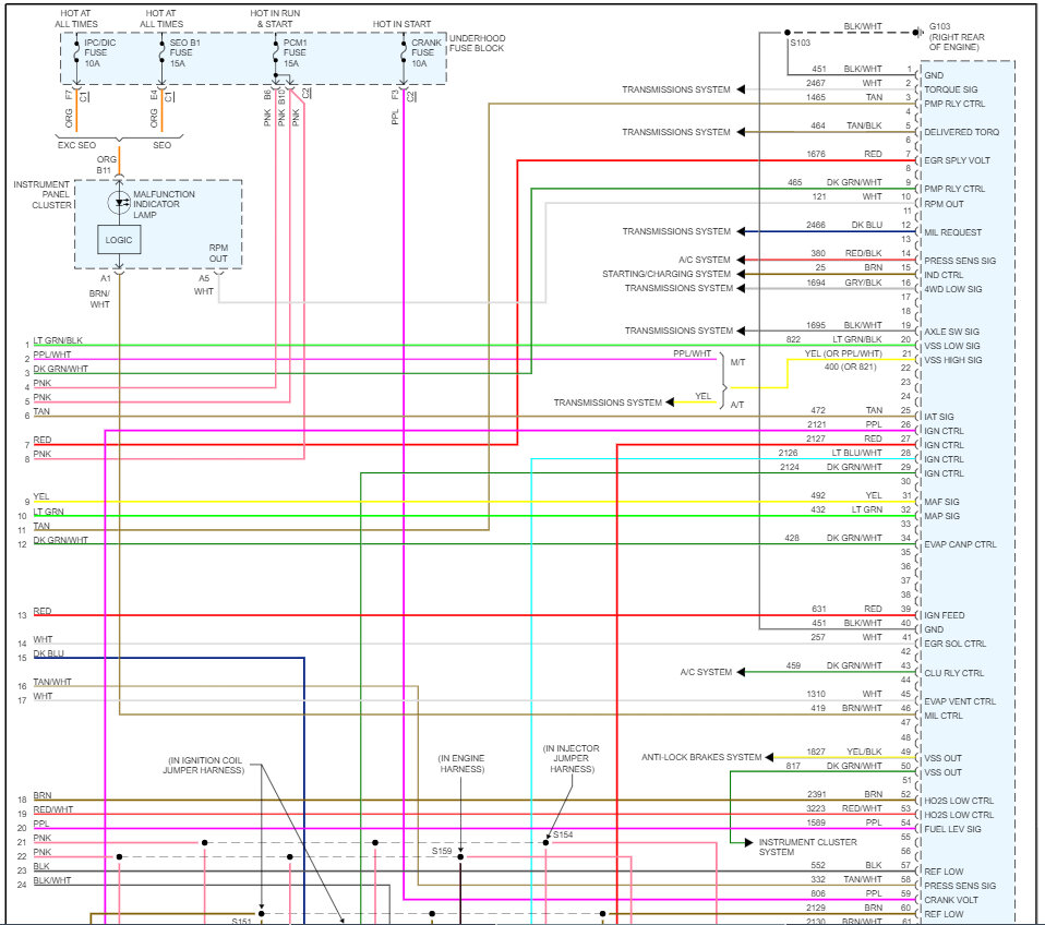

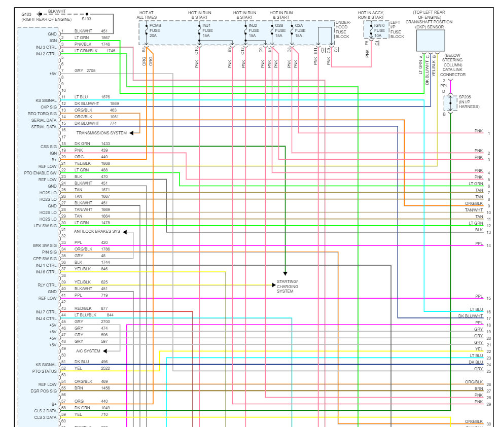

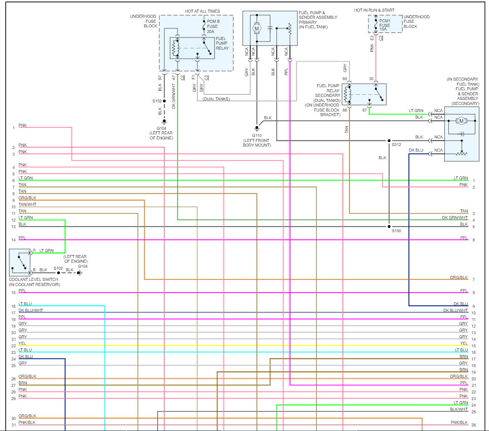

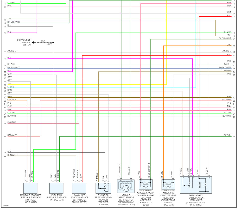

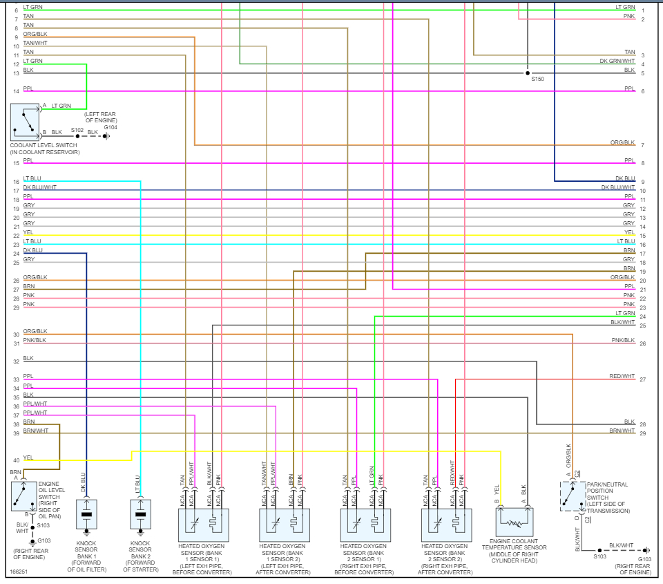

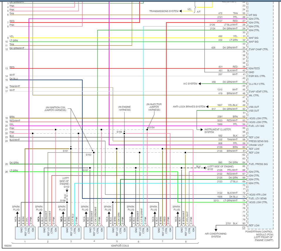

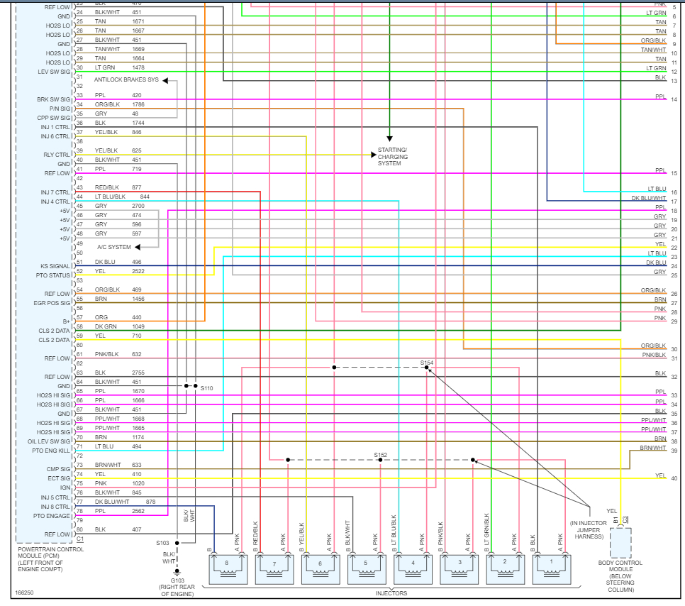

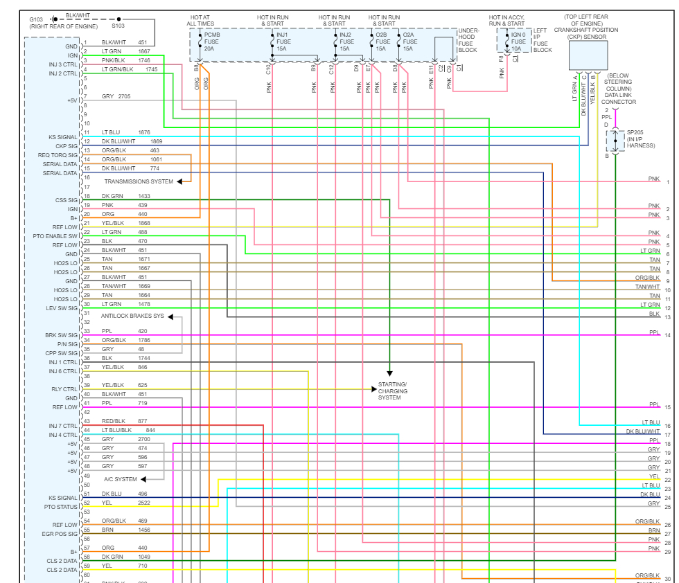

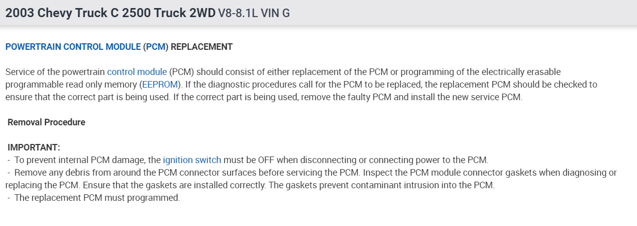

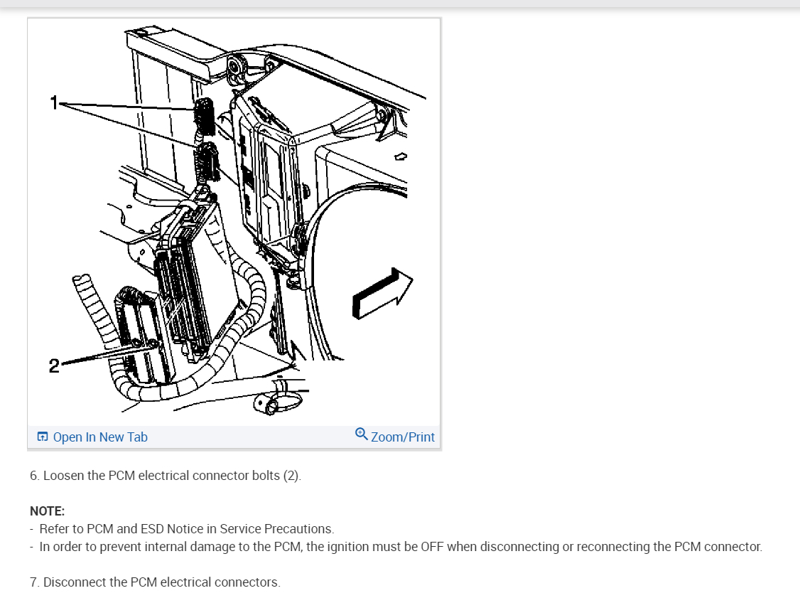

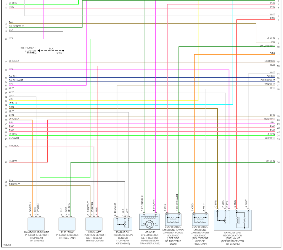

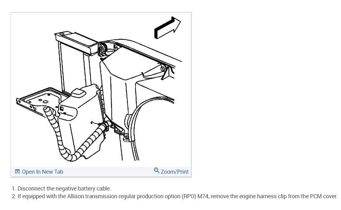

It sounds like the PCM is bad, but we should check the grounds first. here is a guide to help and the PCM wiring diagrams so you can see which wires to test:

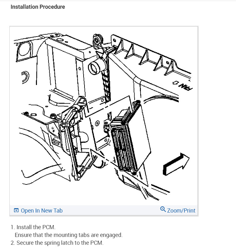

If the grounds check out you can get and if the fuses are okay (test with ignition on) I have left the location and instructions on how to change out the PCM, you can get a preprogrammed unit by searching Google or Ebay. Also, you should unplug all injectors to see if the pulse comes back because a shorted injector can shut down the PCM injector driver.

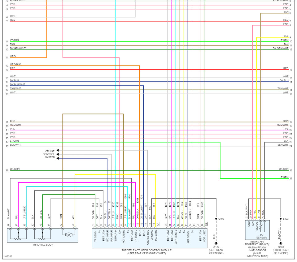

Okay, I have the wiring diagrams above lets use this guide to check the voltage and the main power inlets at the PCM.
Please go over this guide and report back. Also I would check the PCM grounds that can cause a low voltage issue as well.

If the PCM is getting power and ground and there is no shorted injector I would try a rebuilt PCM.

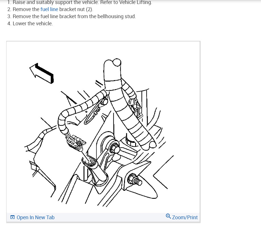

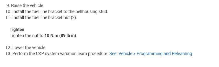

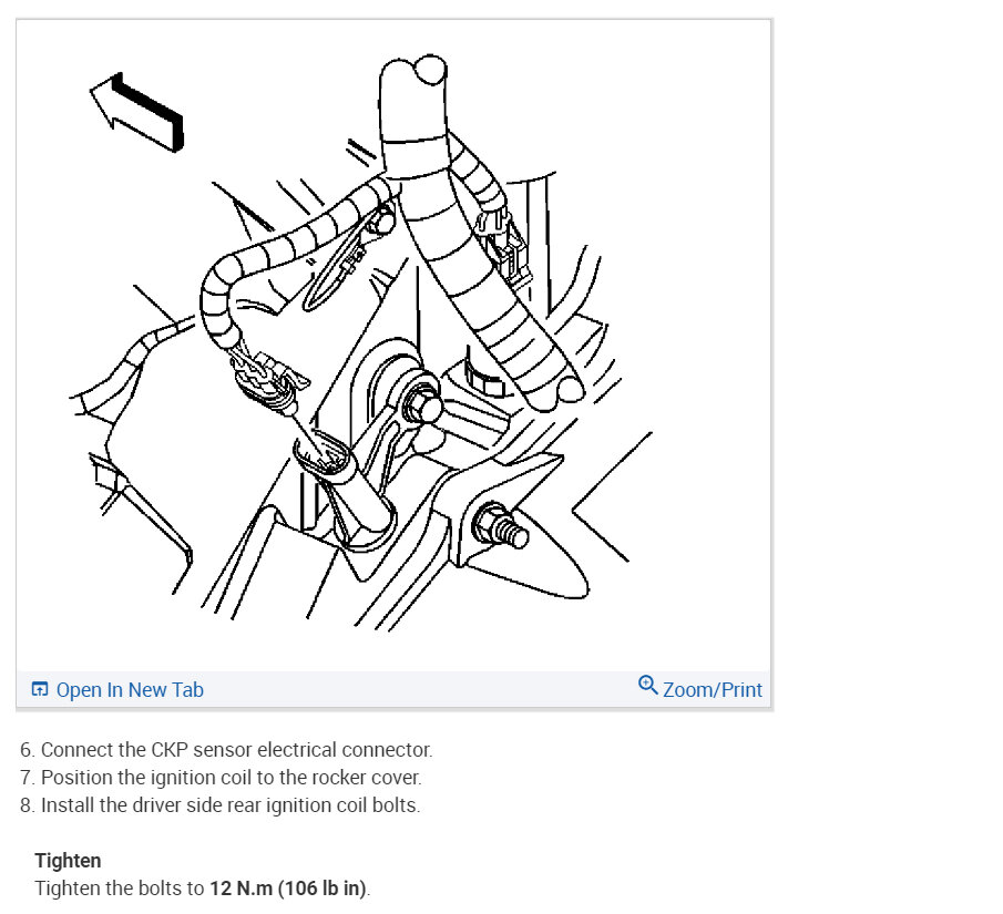

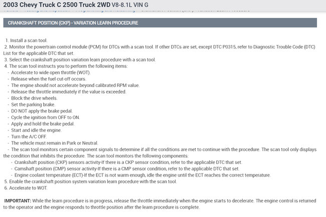

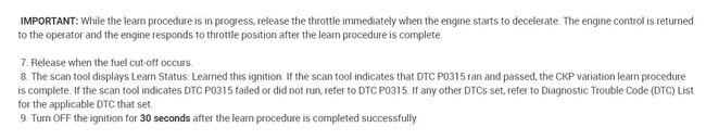

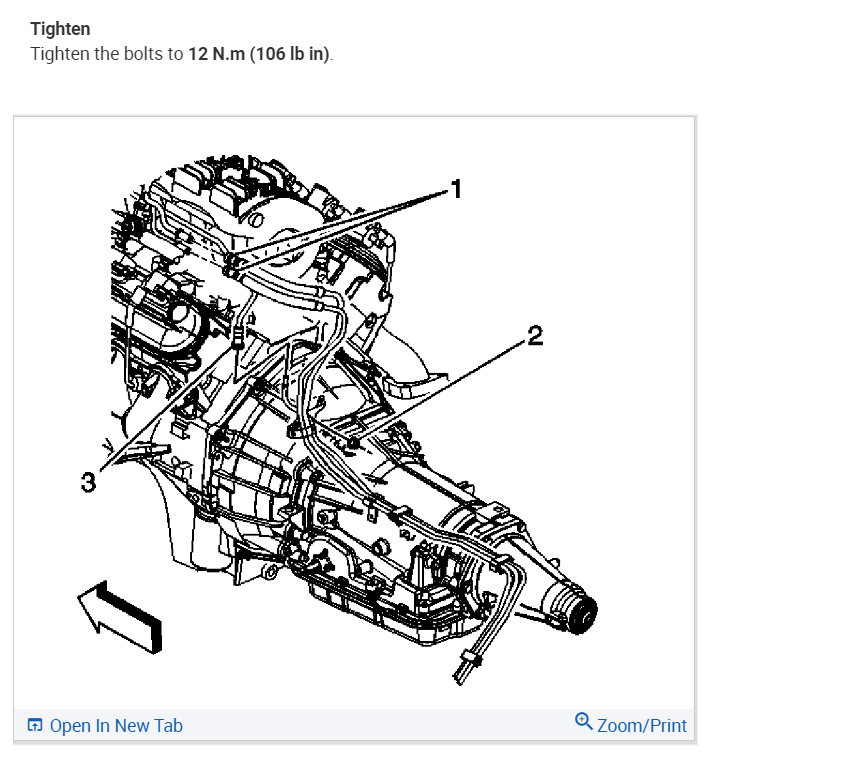

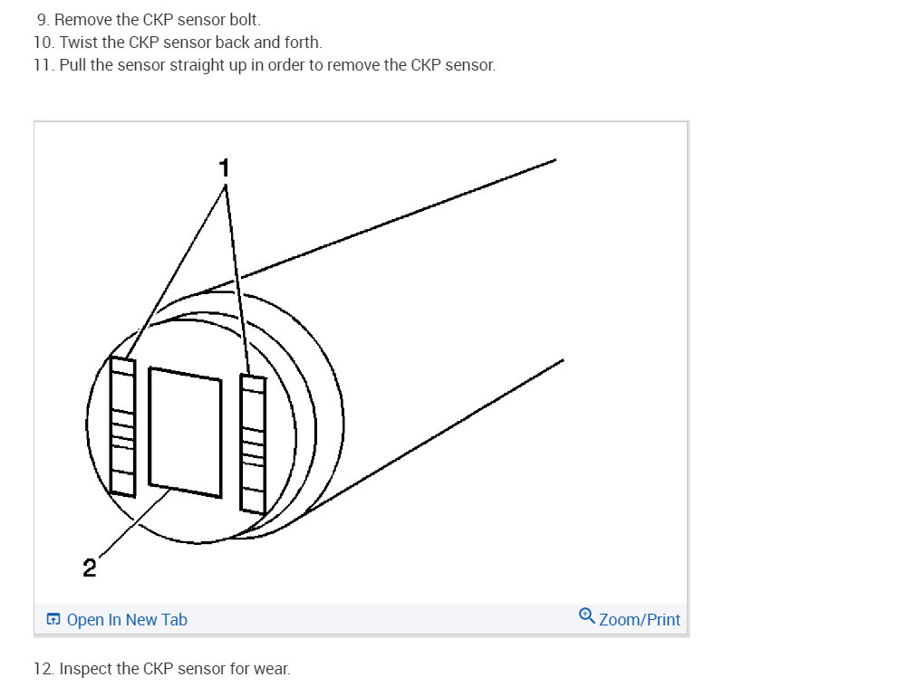

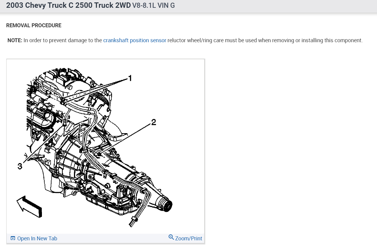

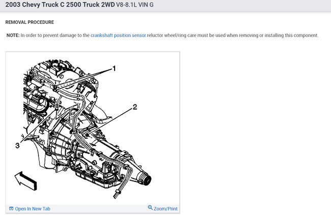

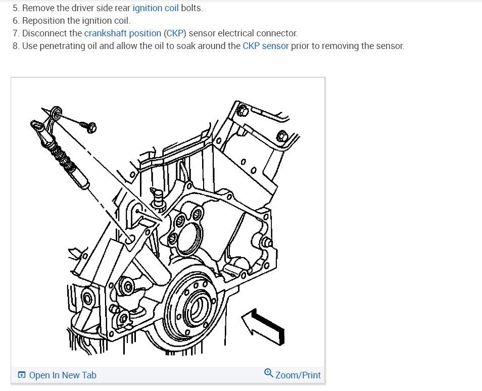

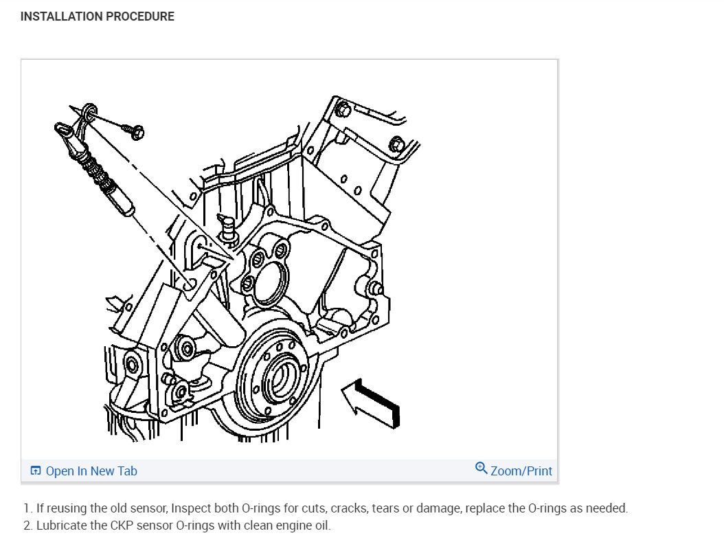

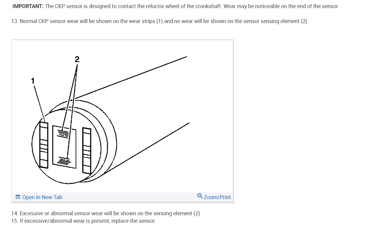

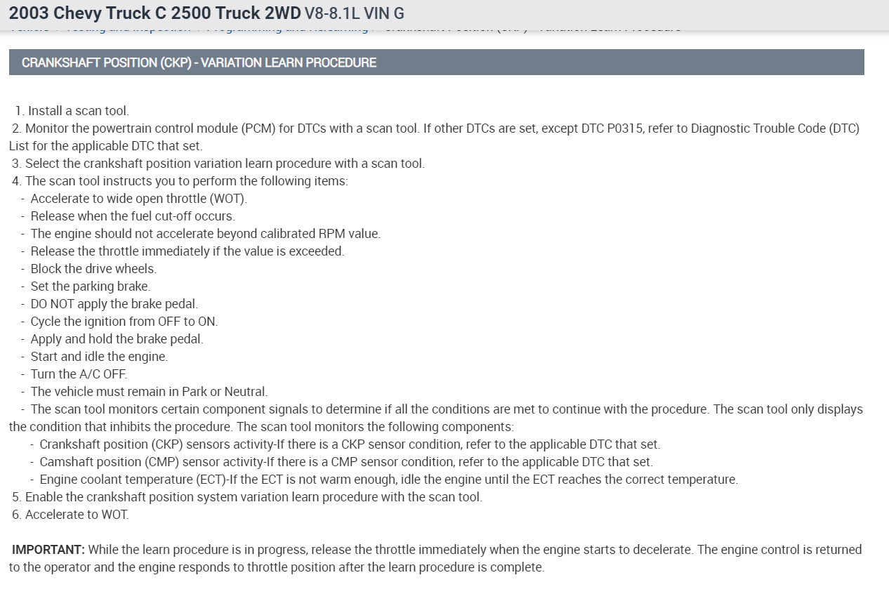

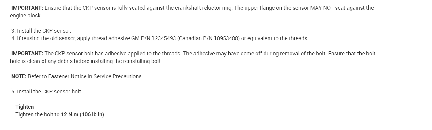

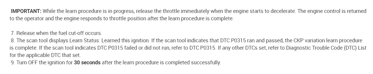

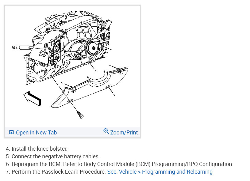

Because the spark is inconsistent it could be the crankshaft angle sensor. Here is the location so you can check it out. Check out the images (below). Please let us know what happens.
Saturday, May 6th, 2023 AT 11:17 AM
LOUD PELLETIER
  • 39 POSTS

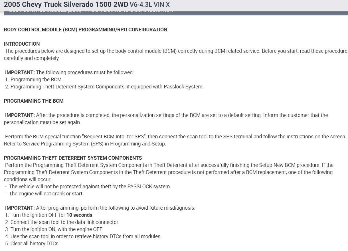

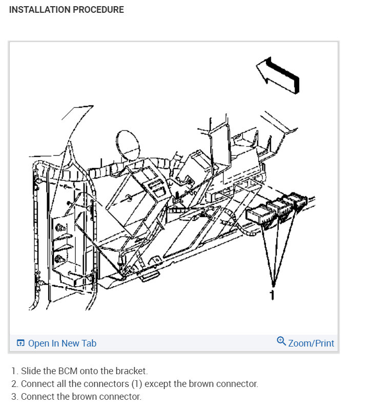

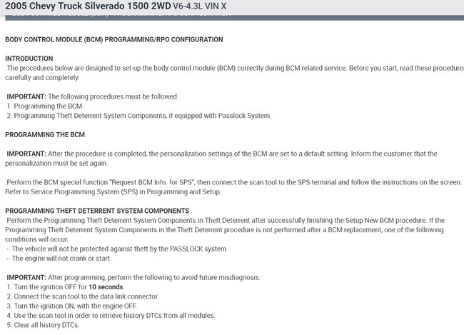

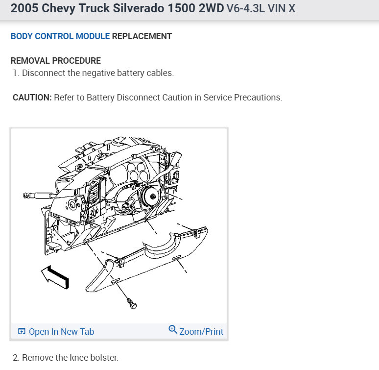

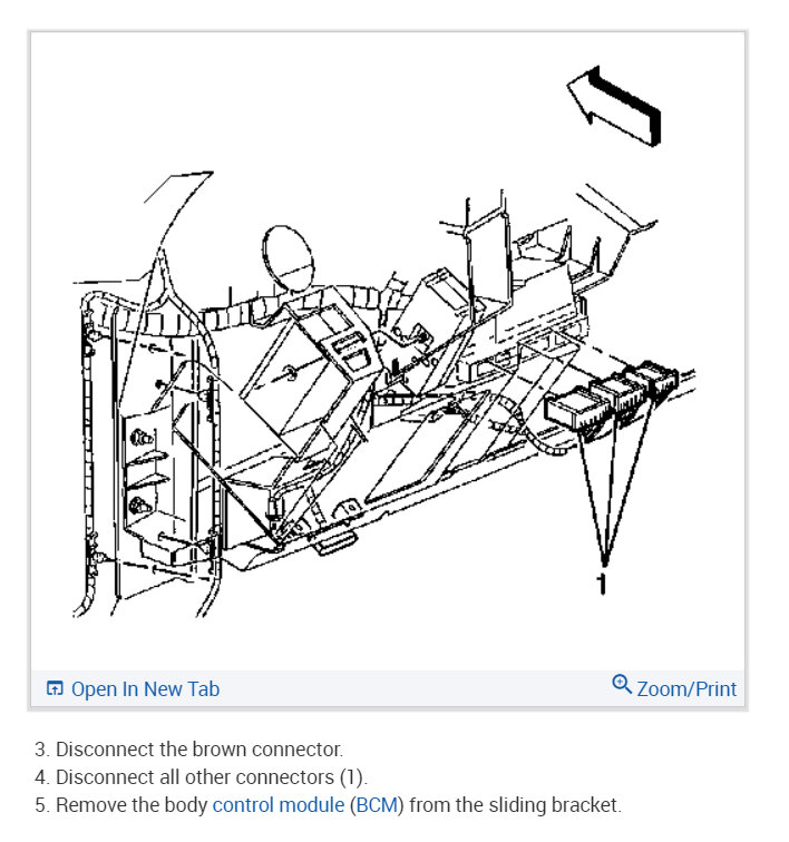

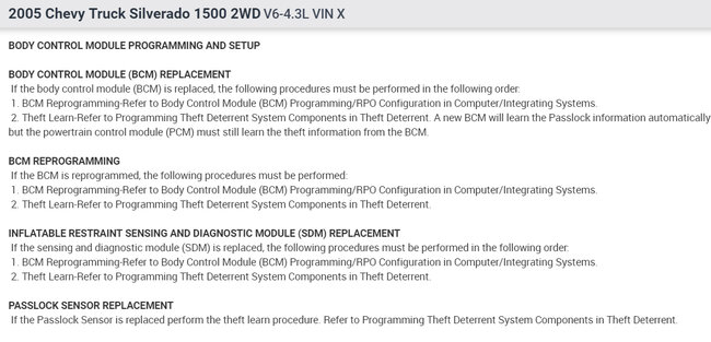

The only thing I found weird is that he has start last fall and I didn’t touch the CKP. How he could have move and can it be CKP that cancel ground pulse to injector or weak ground pulse and I don’t know the code cause the BCM act really weird recently he don’t recognize the truck 8 month ago the truck start fine run fine And suddenly the BCM decides not to recognize anything and I remove the chip in the radio that makes the pass lock issue.
Sunday, May 7th, 2023 AT 7:59 AM
KEN L
  • MASTER CERTIFIED MECHANIC
  • 55,420 POSTS

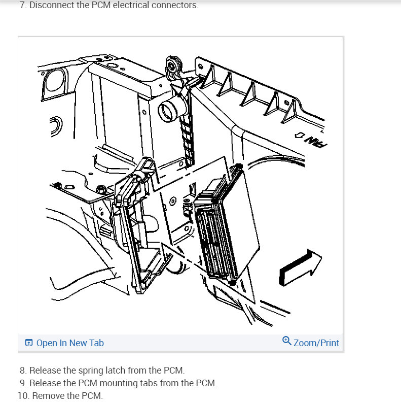

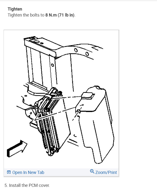

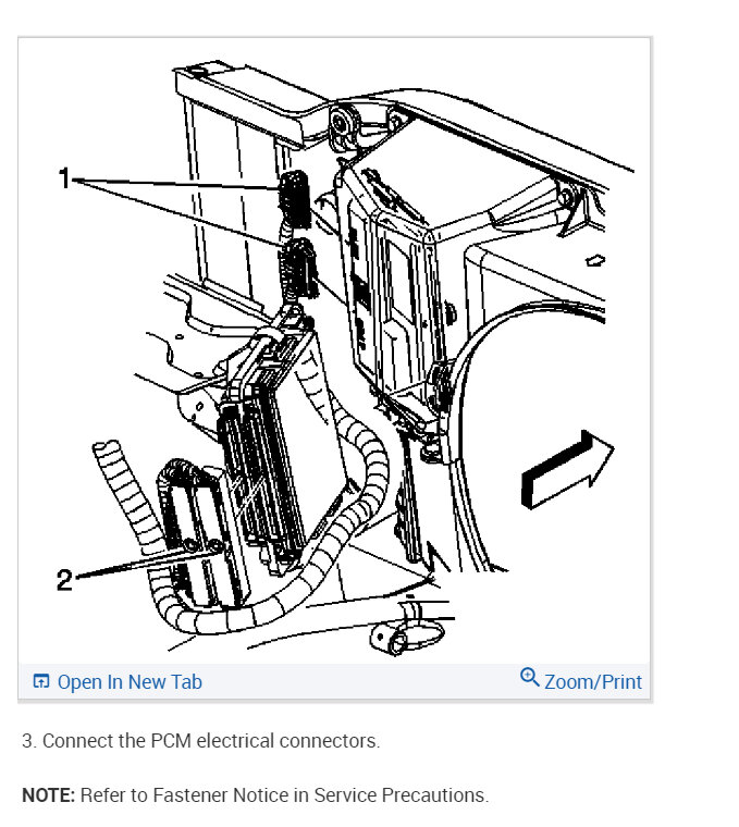

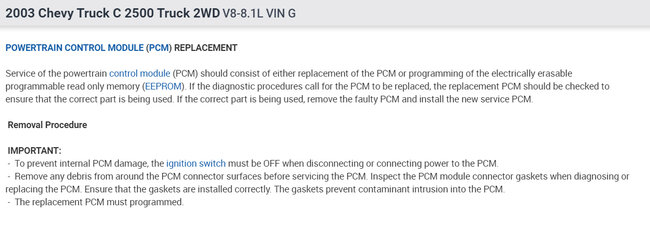

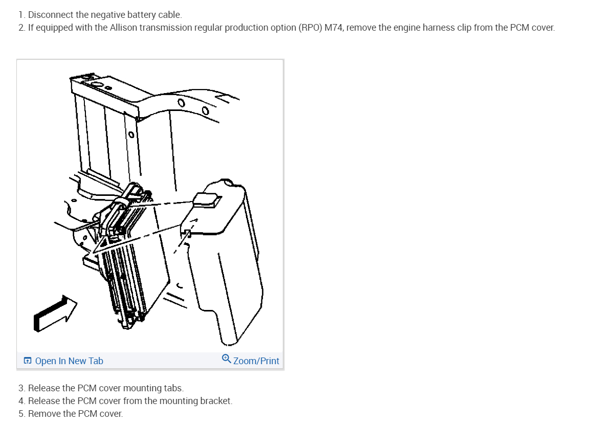

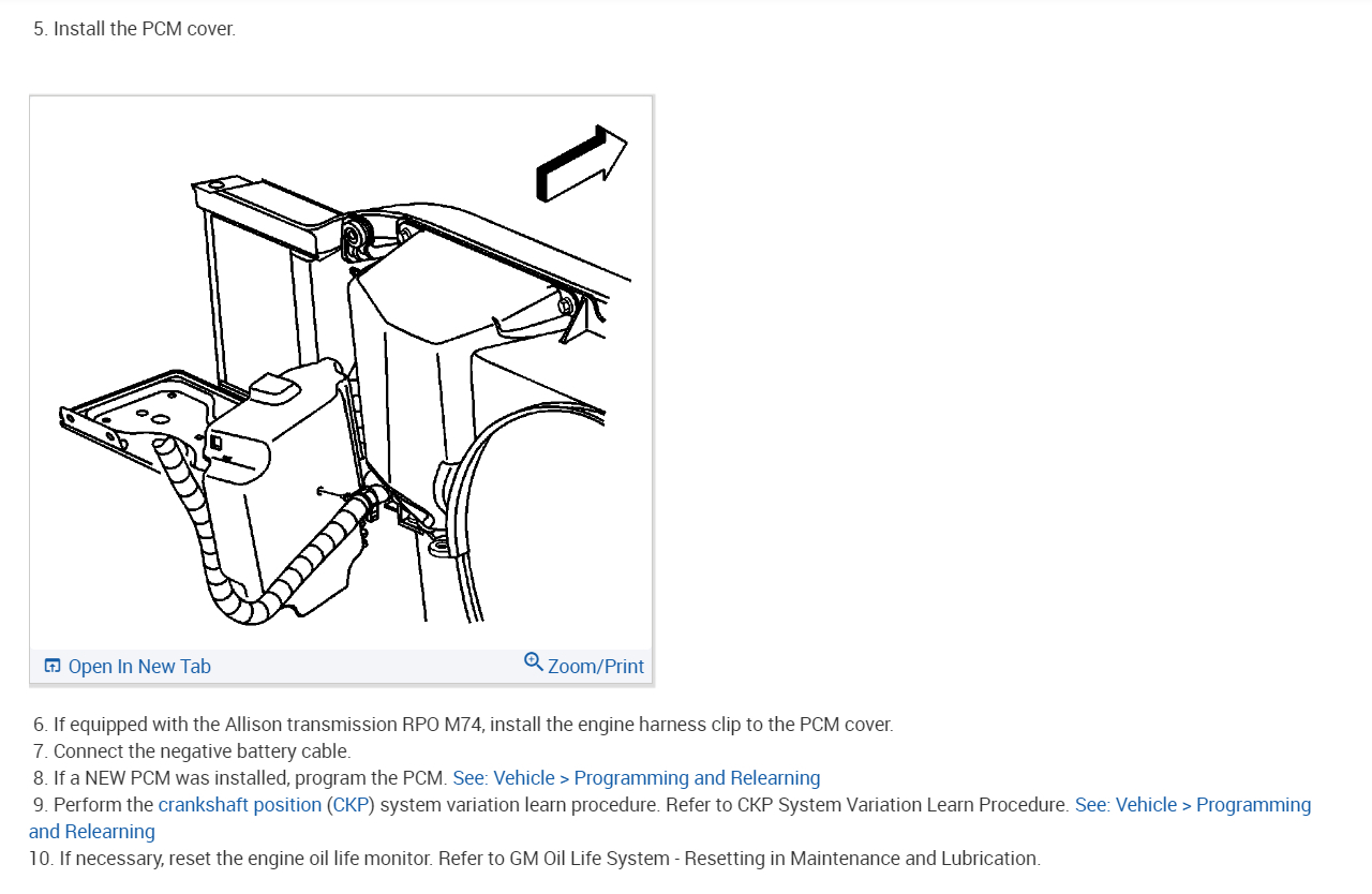

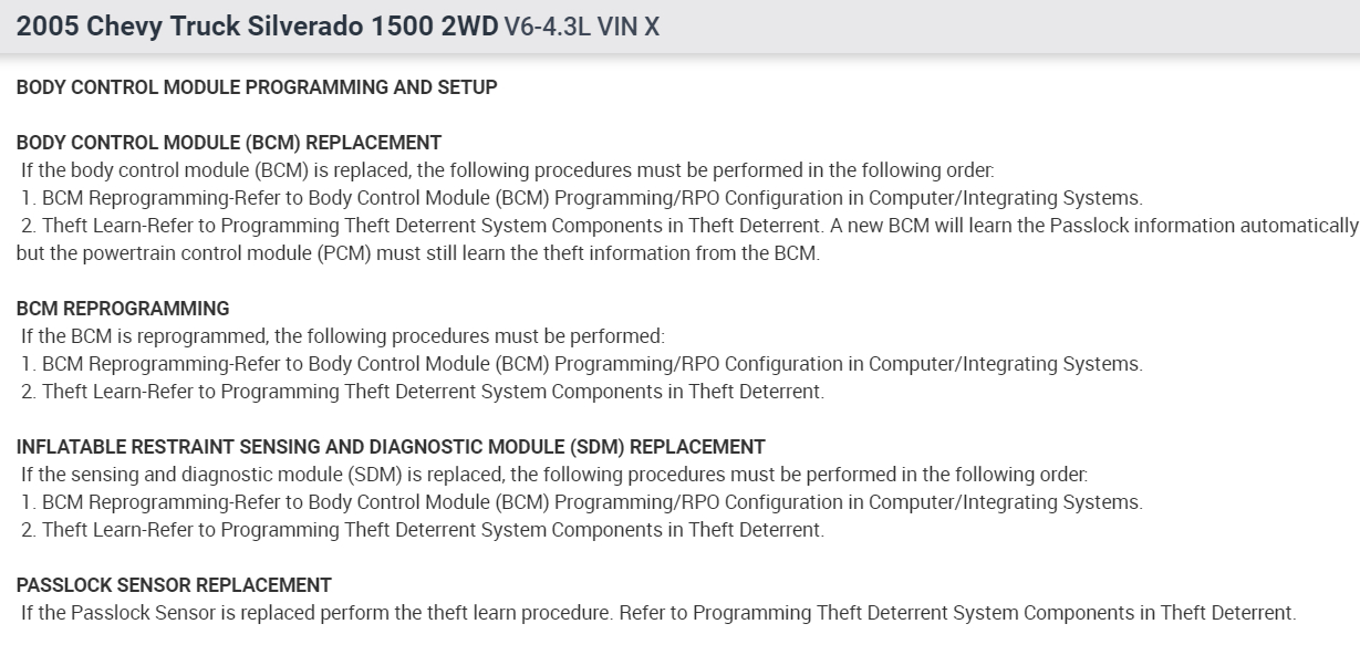

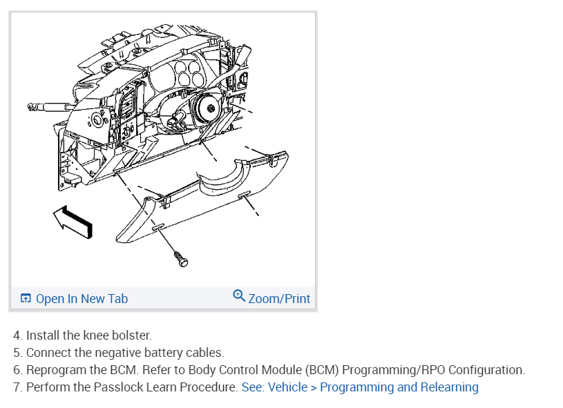

I have seen a bad BCM cause this problem. Here is the location and how to replace it. You can get a preprogrammed unit by searching Google or Ebay. Check out the images (below). Please let us know what happens.
Sunday, May 7th, 2023 AT 11:36 AM
LOUD PELLETIER
  • 39 POSTS
Cause crank no start and all symptom I told you before.
