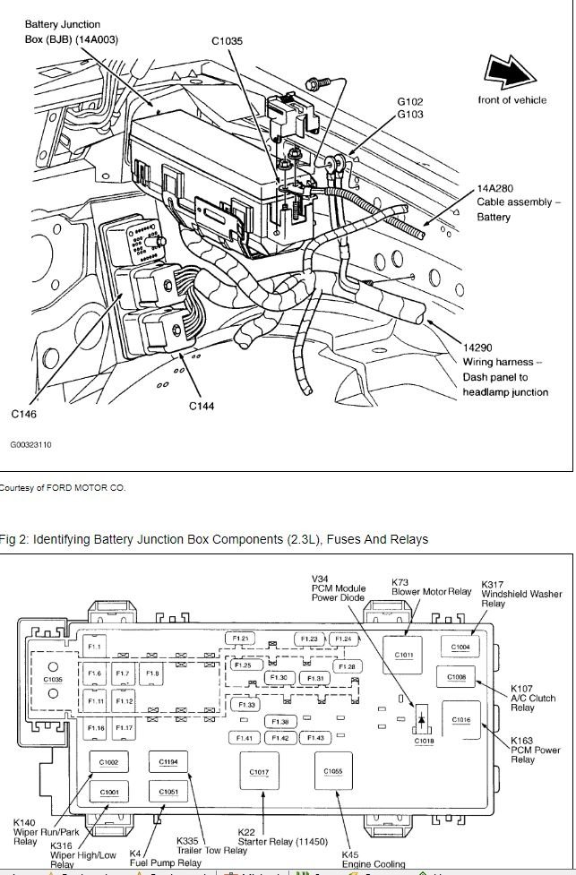

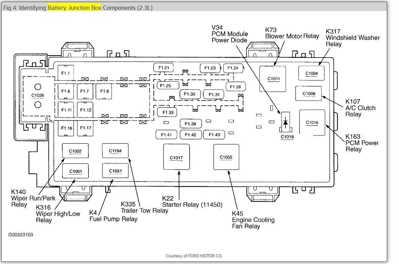

Try a new fuel pump relay.
It is located in the battery junction box, under the hood.

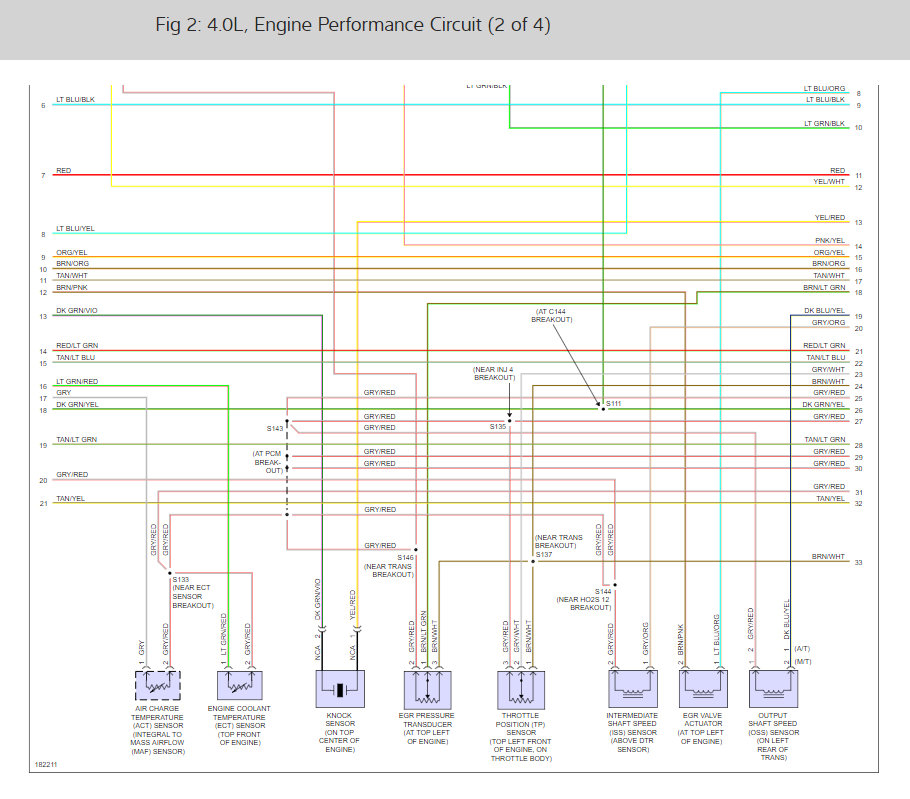

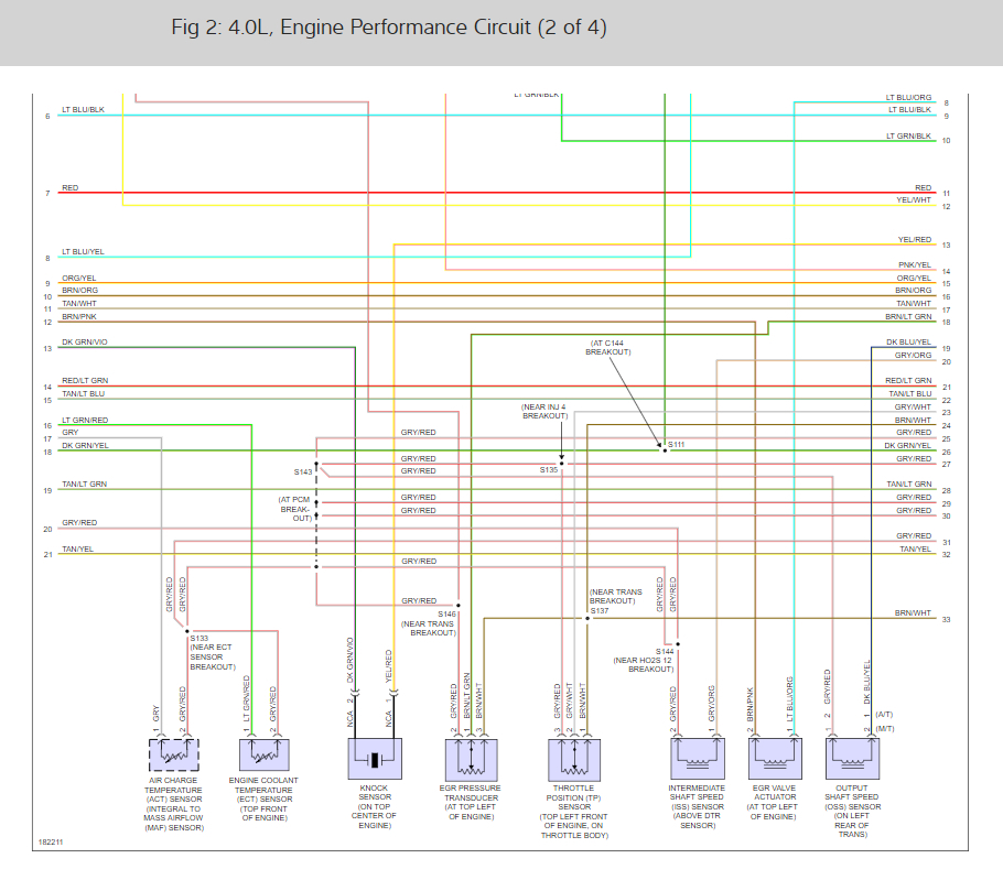

It sounds like the engine coolant temperature senor could be shorting out which will cause the issue. Lets run the codes to see what comes up here is a guide

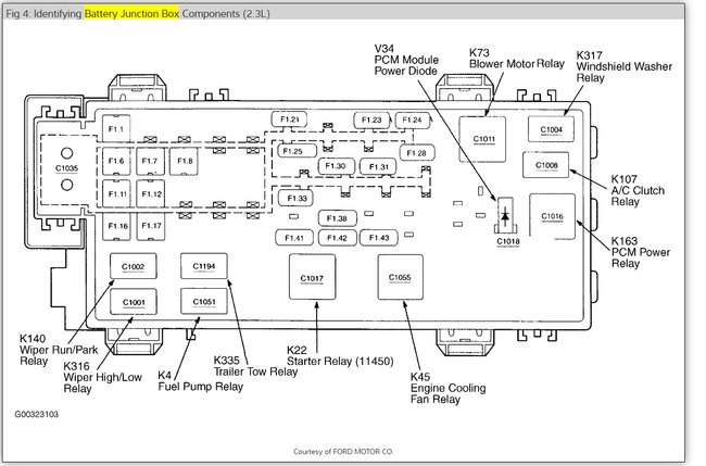

Cannot hear fuel pump running with key in the on position,fuel door opened in quite setting.
Changed fuel filter.
Checked inertia switch -okay
Checked all fuses in dash and in engine compartment for continuity-okay
Swapped relays 46a and 46b.
Have not check fuel pressure yet.
Mar 2, 2021 at 11:29 AM (Merged)
  • CAR REPAIR CONTRIBUTOR
  • 54,350 POSTS

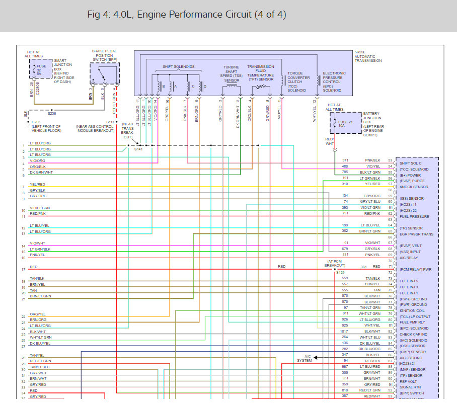

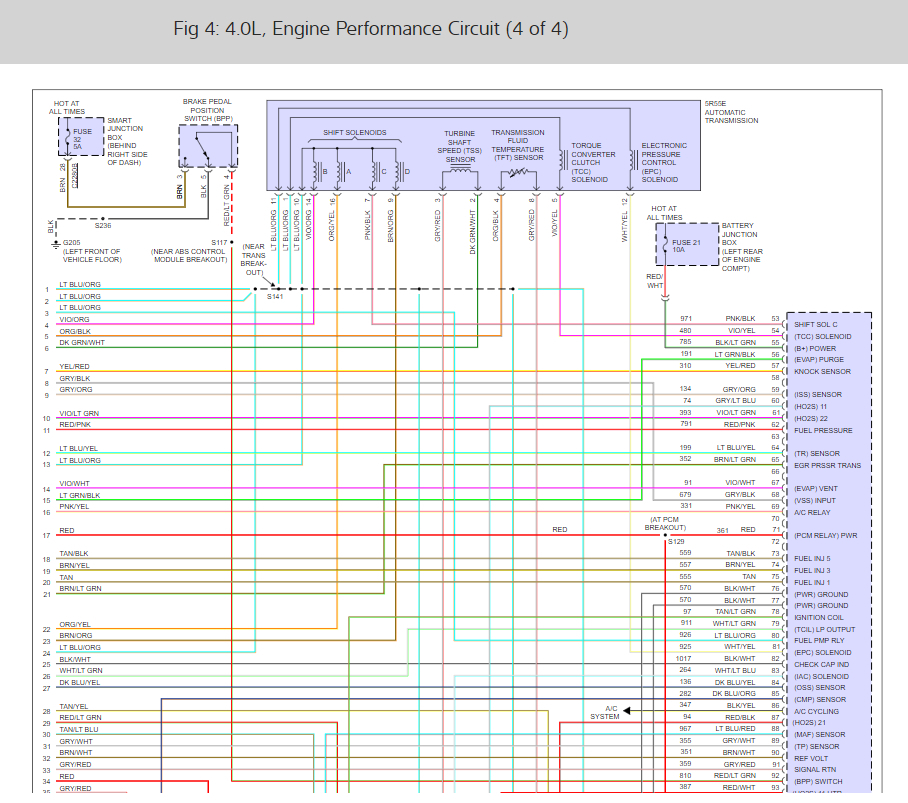

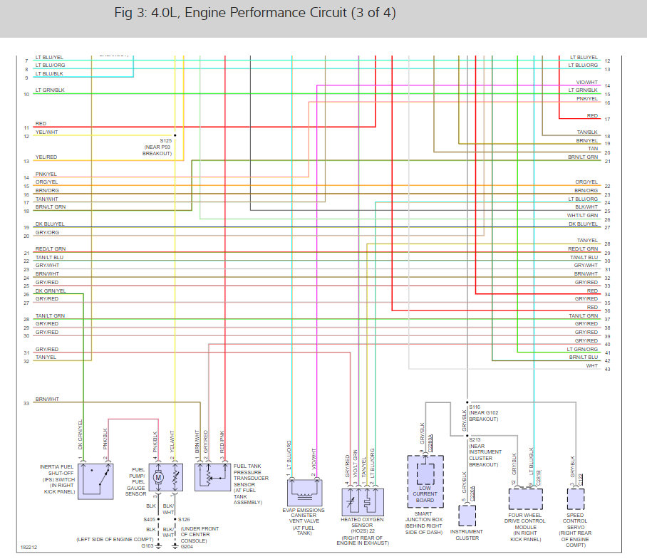

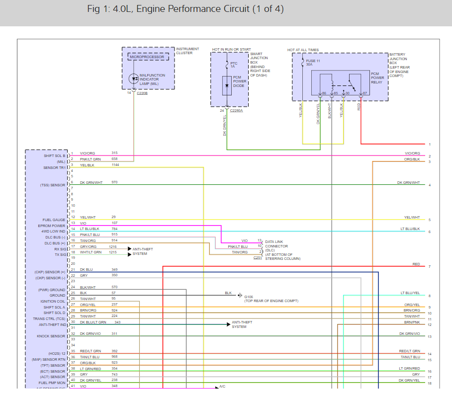

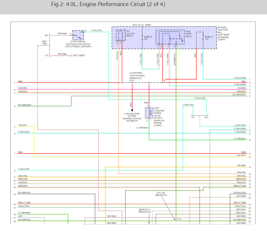

If you cannot hear the pump no need to check fuel pressure. It sounds like the pump may have gone out but to be sure lets check for power at the fuel pump relay. Here is a guide to help you confirm the issue and the engine wiring diagrams so you can see how the system works and the fuel pump relay location:
Try to jump power to the pump to see if it goes on.
