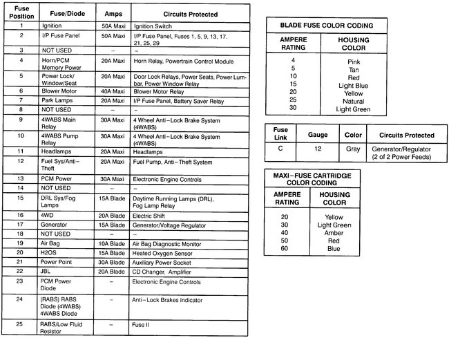

My 96 ford ranger has stopped starting. I replaced the #23 fuse while the truck was running and upon doing so the truck quit running. I have checked all the other fuses. Did notice that I am no longer getting fire from my plugs. The timing belt looks fine and have also replaced the coils. Will turn over but wont start. Really appreciate any help. Cant really afford to take it in.
Tuesday, March 2nd, 2021 AT 5:29 PM (Merged)
  • 110,192 POSTS
Hi mojo_7733, Welcome to 2carpros and TY for the donation
No snapping blue spark continue to troubleshoot the ignition system-power input to the coil/coil packs, coil's resistances, distributor pick-up coil, ignition control module, cam and crank sensors and computer Note: If it doesn't apply disregard it
What did the #23 fuse cover? Also, have you checked the crank sensor? Are you getting power to the coil? Also, pop the distributor cap off and make sure the rotor is turning when the engine is cranking.

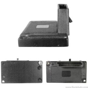

BTW, what is the ICM?
I have a new cam position sensor, but can't find it on the engine to replace it (96, 2.3L).
Also, where is the ICM located? I can have it checked.

Your ICM looks like this below and I dunno where its located been looking into Mit1 and Alldata auto references no exact location-sorry

Thank you for the pics, now I know what it looks like. I have searched my truck for 2 days and cannot find this ICM module. Is there anyone out there who knows where this module is located? I called the local Ford dealer today and all they told me was that it was in the inner right fender. IT'S NOT THERE!

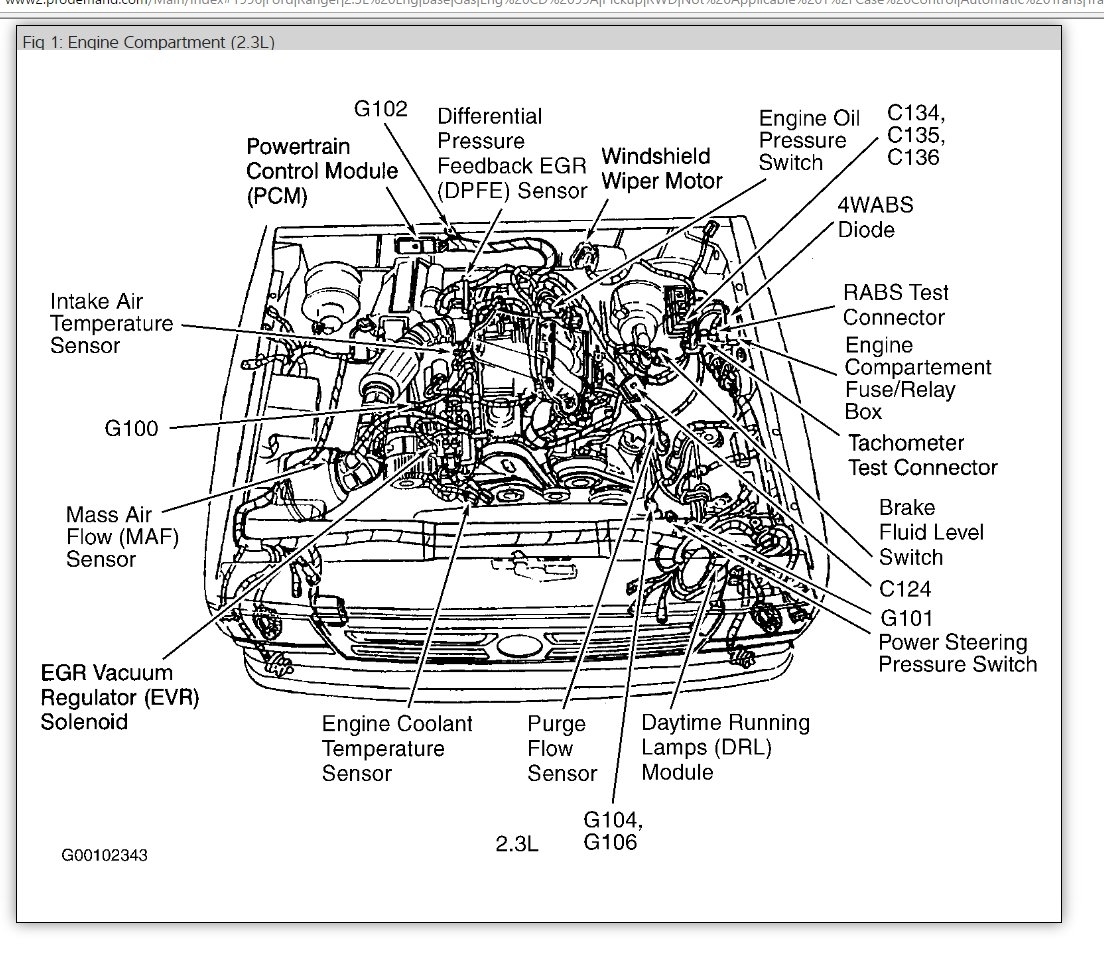

The PCM is located in the firewall on the passengers side. Here is a diagram that shows its location.
Please check the timing belt as well.

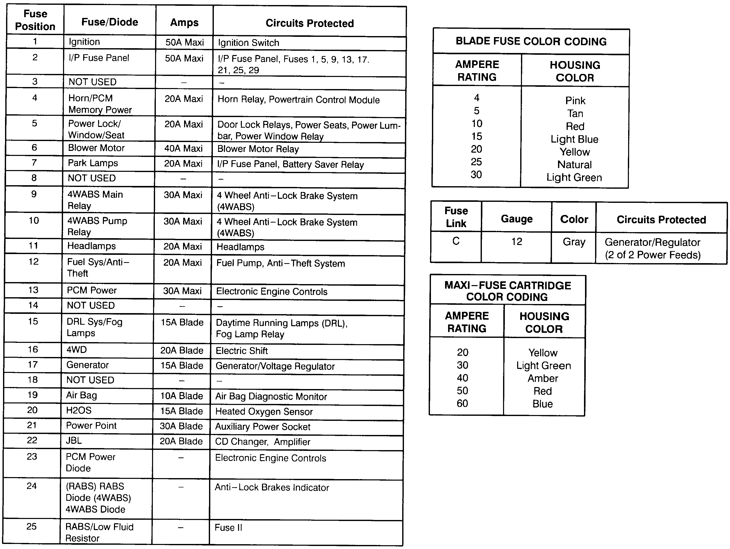

DUMPBOY
  • 1996 FORD RANGER
  • 3.0L
  • 4WD
  • MANUAL
  • 152,000 MILES
One time it will fire up like normal but if you shut it off it won’t crank back up until it sits a while. Also, when it’s running it occasionally has a small but quick dip in rpm's.
Tuesday, March 2nd, 2021 AT 5:30 PM (Merged)
  • 110,192 POSTS

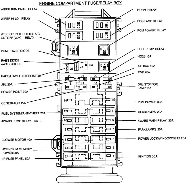

The first thing that comes to mind is a bad electronic engine control relay (EEC). This relay will prevent the fuel pump from coming on as well as shutting off the ignition.
It's been awhile, but I recall several reports of this in the past where the car ran fine, someone would park, come back a few minutes later and it wouldn't start.
With that in mind, here is what I want you to do. The PCM power relay functions the same as the EEC relay on your truck. What I want you to do is this. When the engine refuses to start, switch that relay with a different one in the fuel/relay box that has the same part number and then see if it will start.
I attached a picture of the relay box under the hood as well as a legend of what each component is for.
Do this and let me know if it works. If it does, just replace the relay.

I tried switching the relays and it didn’t work. I was told by someone else that the camshaft synchronizer could also cause that but I don’t know. Any help would be great.

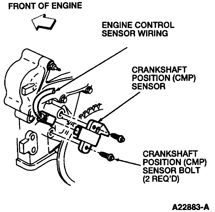

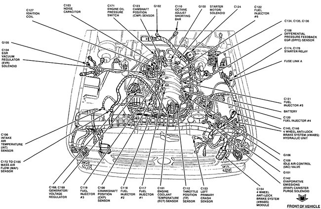

If the EEC isn't the issue, the next suspect is the crankshaft position sensor. Take a look through this link.
The Crankshaft Position Sensor is located at the lower front of the engine. (See Picture 1)
Crankshaft Position (CKP) Sensor
See Picture 2
REMOVAL
1. Disconnect battery ground cable.
NOTE: When battery voltage is removed from the Powertrain Control Module (PCM), all learned values will be cleared and reset to predetermined values. When battery voltage is restored to the PCM, the vehicle may exhibit certain driveability concerns. It will be necessary to drive the vehicle to allow the PCM to relearn values for optimum driveability and performance.
2. Disconnect Crankshaft Position (CKP) sensor electrical connector.
3. Remove two CKP sensor screws and remove sensor.
INSTALLATION
1. Position CKP sensor on engine .
2. Install two CKP sensor screws and tighten to 4-7 Nm (35-62 Lb in).
3. Route CKP sensor wiring harness and connect electrical connector.
4. Connect battery ground cable.
When the problem happens, you have two easy choices to check. First, if you have a live data scanner, see if there is an RPM signal. If there isn't, my first suspect is this sensor. Or, check to see if the engine is getting spark.
