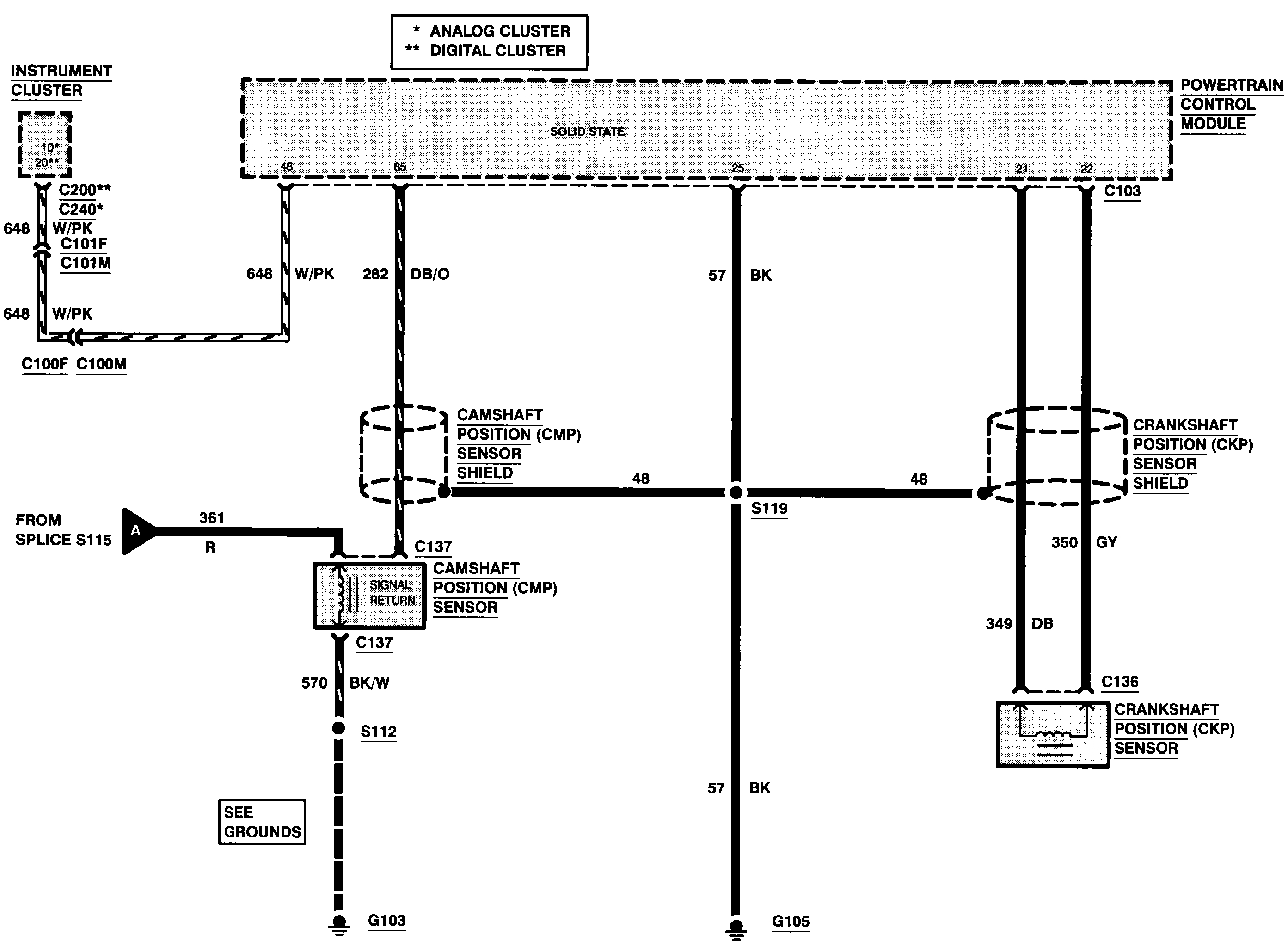

Crank but will not start
511232
  • 1996 FORD WINDSTAR
  • 3.0L
  • 6 CYL
  • 2WD
  • 190,000 MILES
The van was running okay until I got to the stop light and it just quit running. Fuel pressure is okay, but no spark when I tested the plug.
Monday, August 19th, 2019 AT 11:36 AM
2 Replies
BMDOUBLE
  • 1,139 POSTS

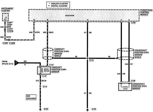

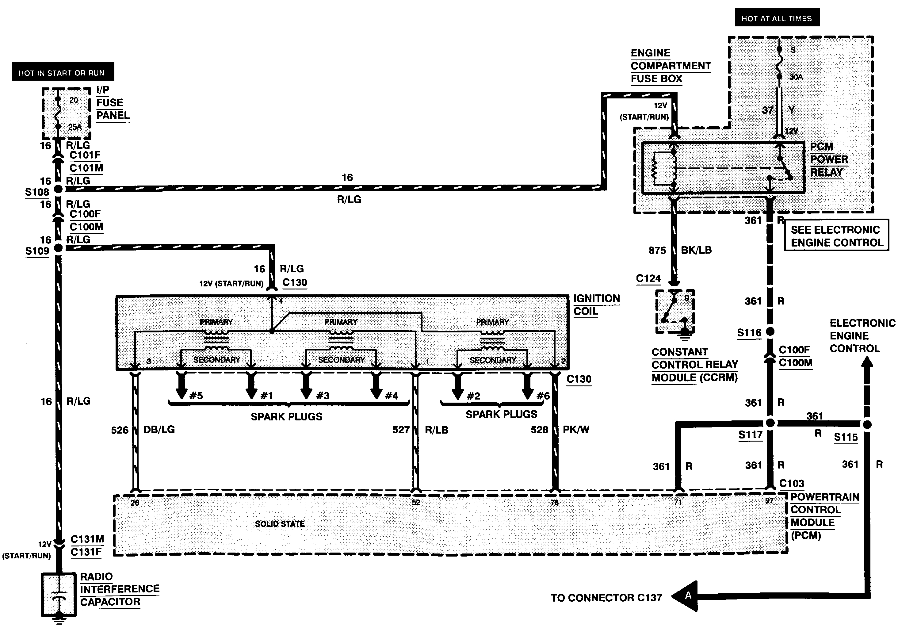

The easiest thing to check first off is the crank sensor signal. If your van has a tachometer look to see if it registers any rpm while cranking. If it does then that tells me that your power-train control module is seeing a crank sensor signal and should be firing your coil. Next I would retrieve any codes with a scan tool as well to give us a direction for troubleshooting purposes. I will attach a wire diagram to help get started.
