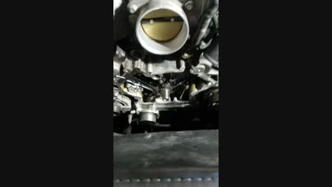

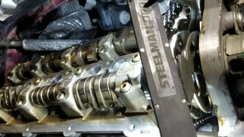

I guess I will disassemble that side again in on TDC and see where it has landed, and send you a video.
Thursday, August 16th, 2018 AT 12:14 PM
MARK FRIZZELL
  • 142 POSTS
With that being said no one is perfect. If I was one link off on the bottom around crank would that give the effect of starting good, runs quite, but adjusters cannot compensate? And give those codes?
Thursday, August 16th, 2018 AT 5:46 PM
KEN L
  • MASTER CERTIFIED MECHANIC
  • 55,090 POSTS
Oh yes, if you are one tooth off it will make the code and the actuators will try and compensate. Please send the video when done. Please hang in there we will get this right.
+1
Friday, August 17th, 2018 AT 9:57 AM
MARK FRIZZELL
  • 142 POSTS
Okay, I will do it, has been a bear. But I always prevail. I know it has to be something simple, even though the adjusters do not look right it runs good.
Video to come. Thanks for your patience Ken.
Friday, August 17th, 2018 AT 10:11 AM
KEN L
  • 55,090 POSTS
We will get it fixed. Have a good weekend.
+1
Friday, August 17th, 2018 AT 11:01 AM
MARK FRIZZELL
  • 142 POSTS
Yep.
Friday, August 17th, 2018 AT 12:04 PM
KEN L
  • 55,090 POSTS
Yep, one link off looks that way to me as well. Let try it with the links moved one, sorry this is kind of a learning experience like most car repair.
+1
Saturday, August 18th, 2018 AT 1:21 PM
MARK FRIZZELL
  • 142 POSTS
Hope, it looks right.
Monday, August 20th, 2018 AT 8:12 AM
MARK FRIZZELL
  • 142 POSTS
Success!
Monday, August 20th, 2018 AT 3:21 PM
KEN L
  • 55,090 POSTS
My man! Nice work mark, we both learned something on this one. Glad you got it fixed I knew we would win. :)

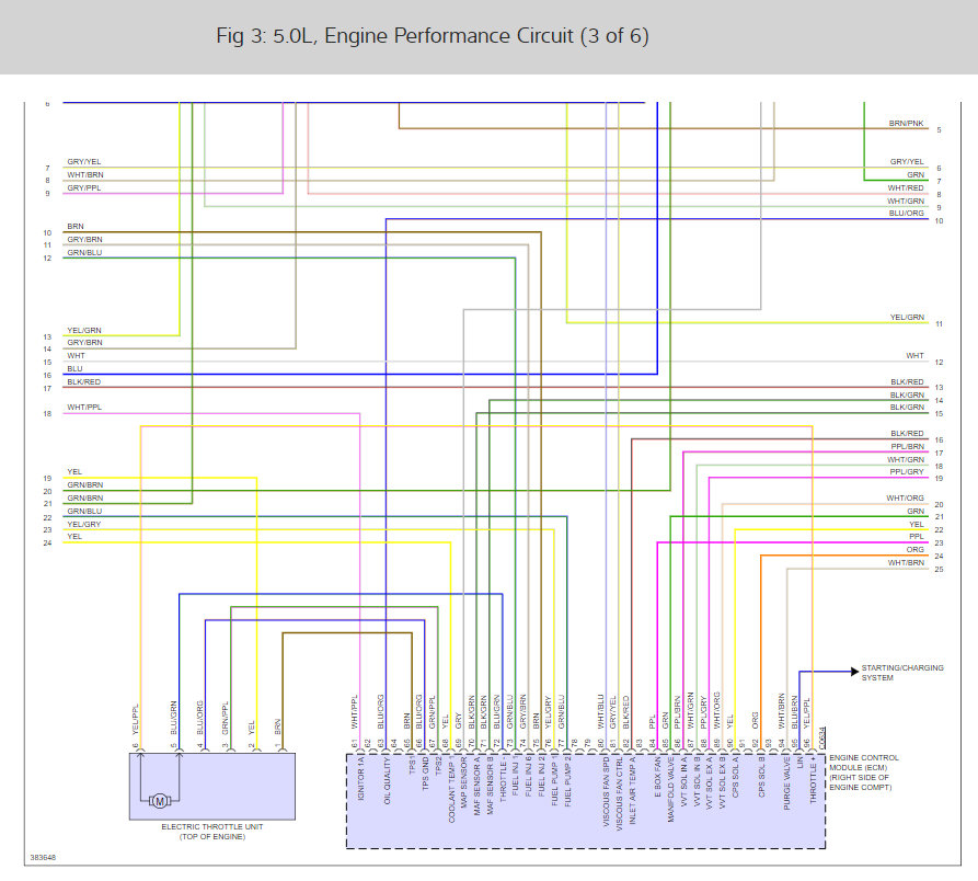

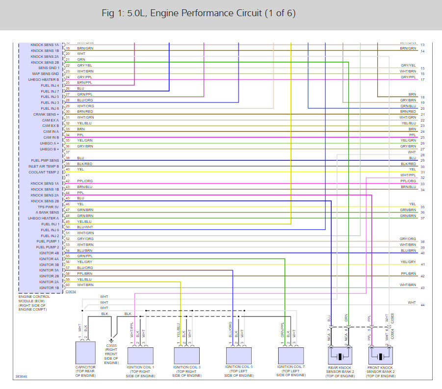

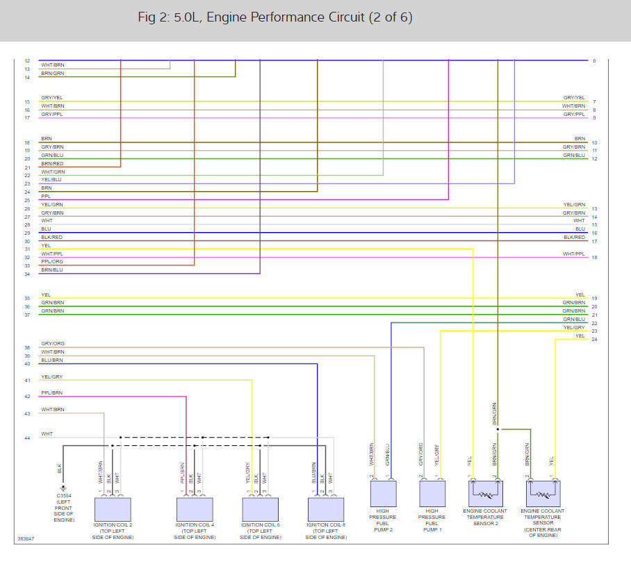

Hoping this was put to bed. I have one strange thing that has popped up occasionally, I do not remember the code right now but, it said that cylinders 2, 4, 6, 8 LH misfire. It runs great. It only appeared twice and it was at an idle after a long drive. Is there a sensor that controls all four cylinders (intake sensor)? Something on the bank maybe loose or going bad?
Thanks, Mark
Saturday, September 8th, 2018 AT 5:59 AM
KEN L
  • 55,090 POSTS

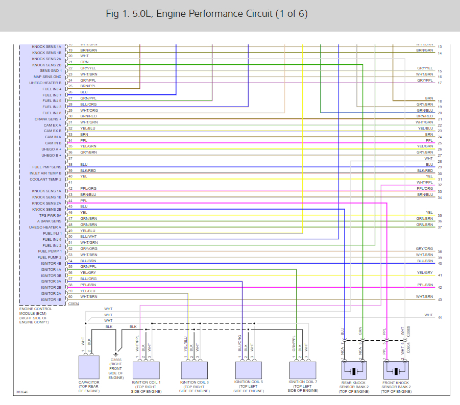

Those coil share a ground and if it grounds to the valve cover (most do) the cover must have its ground on as well. It sounds like it is loose/dirty? If I can get the code number it will help.
+1
Saturday, September 8th, 2018 AT 11:58 AM
MARK FRIZZELL
  • 142 POSTS
P0302
P0304
P0306
P0308
P0300
P0316 - Misfire detected first 100 revolutions
Monday, September 10th, 2018 AT 3:14 PM
KEN L
  • 55,090 POSTS

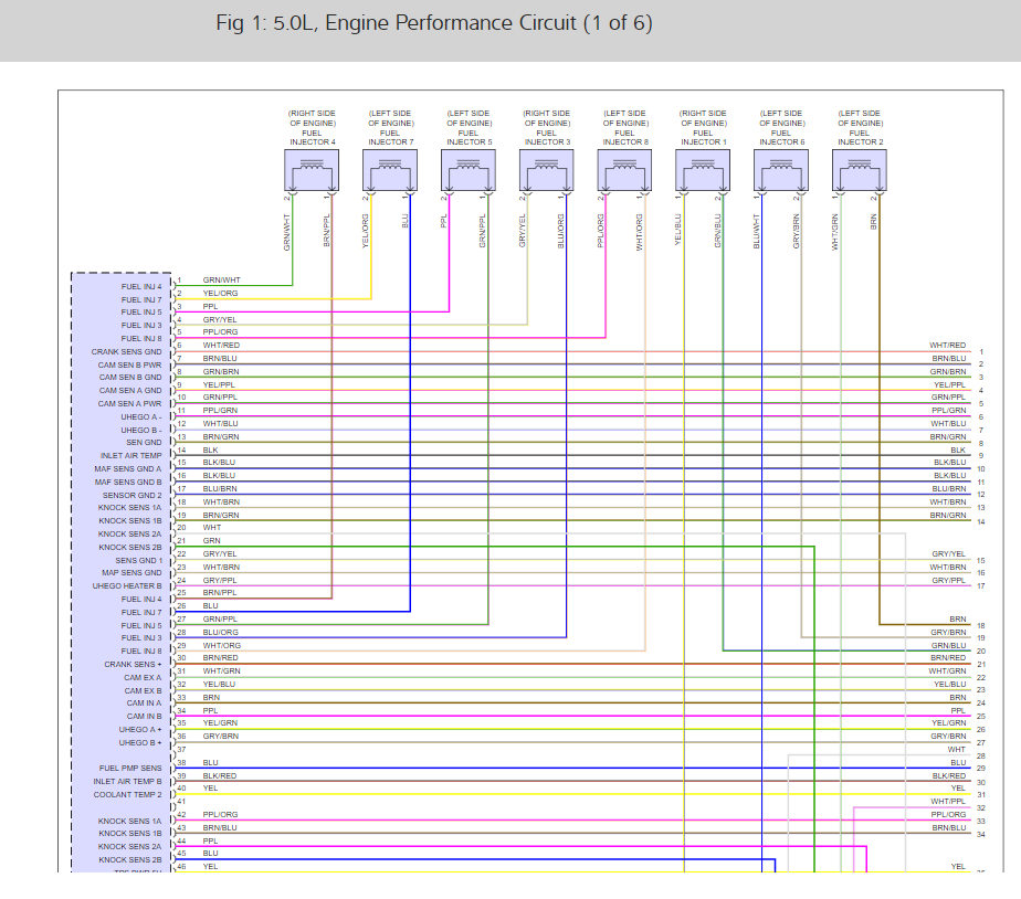

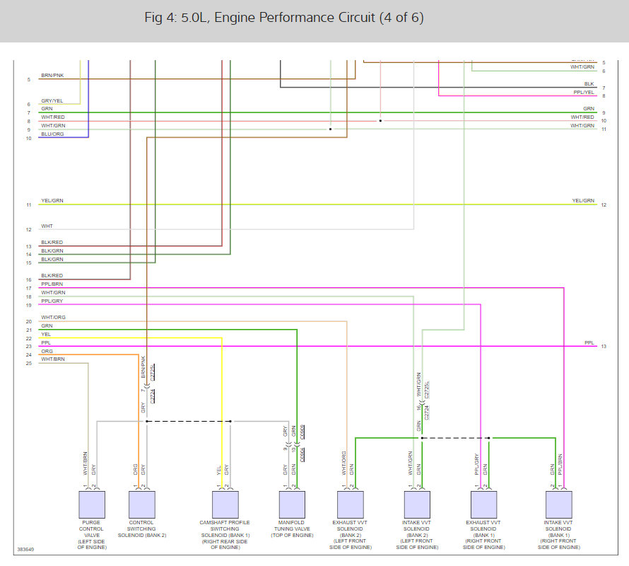

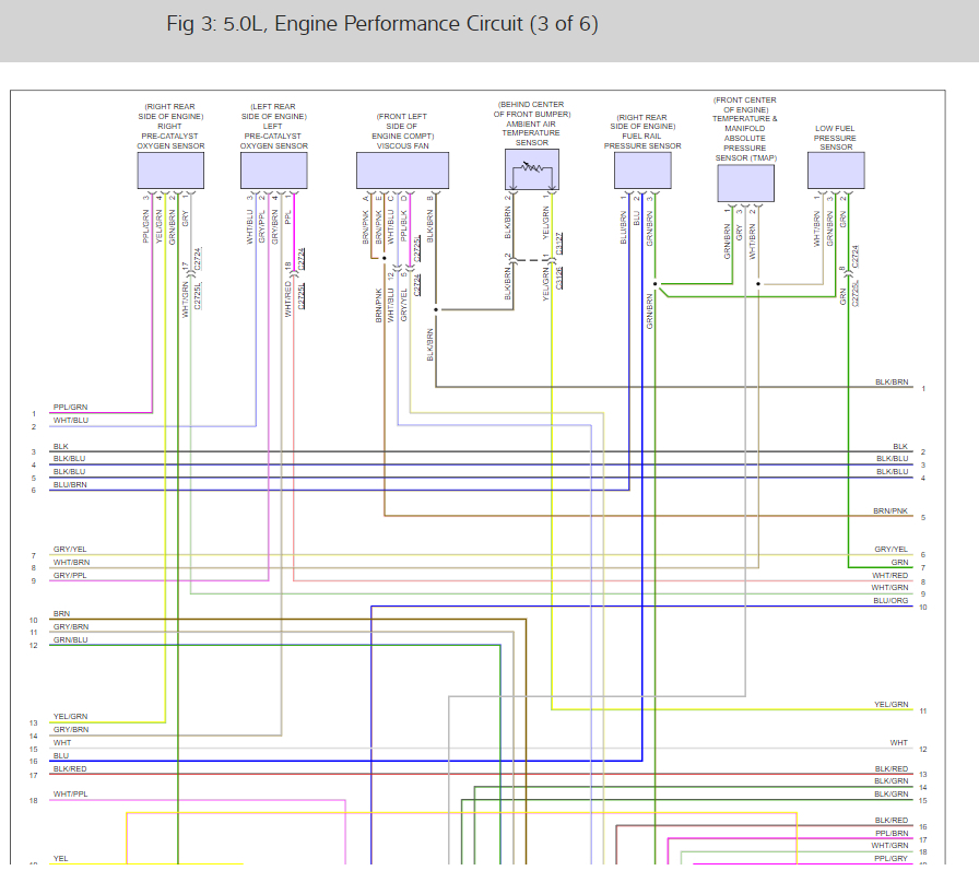

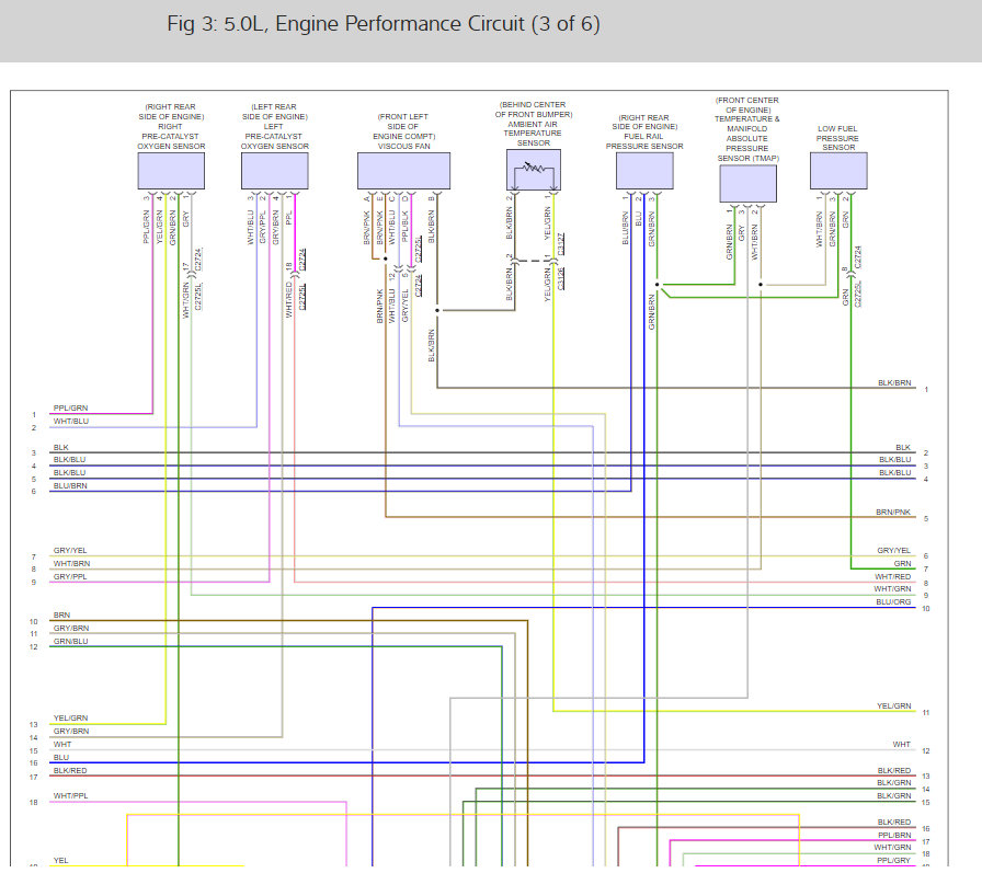

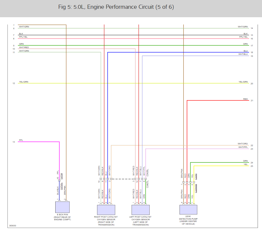

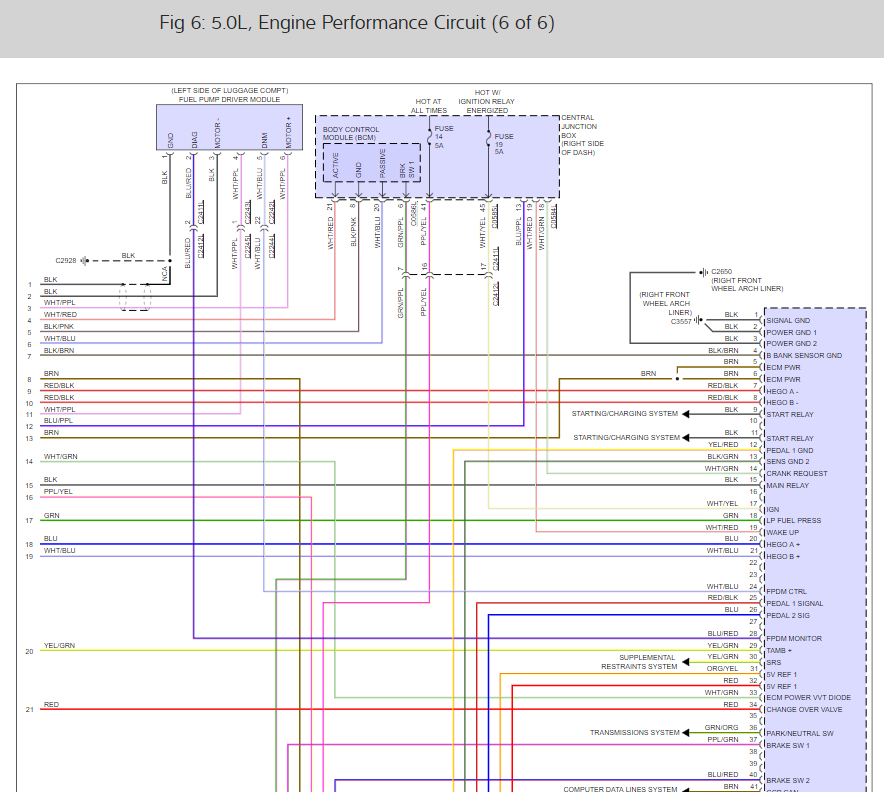

Yes, definitely one side of the engine. At least there are no p0012, p0011 codes. Still sounds like a grounding issue to me for the coils. Here are the engine wiring diagram and a guide to help you test the grounds. Is the main ground strap from the battery to the block and then to the frame in good shape all connected?
+1
Tuesday, September 11th, 2018 AT 11:59 AM
MARK FRIZZELL
  • 142 POSTS
Grounds are good, another possibility?
