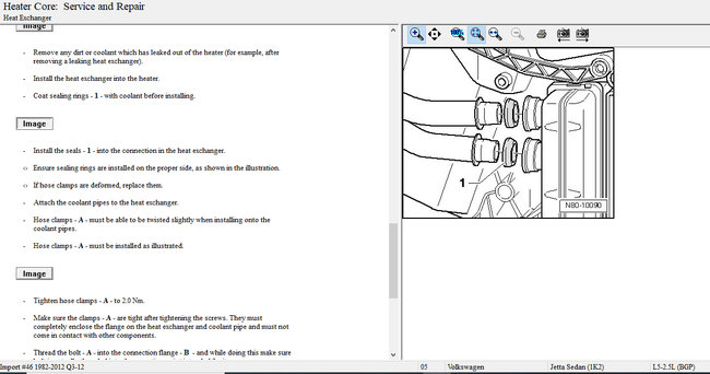

Thank you as I've had time to think about it I remember smelling some coolant inside the car. Is it possibly the heater core? There's no leaking inside of car just curious. Thank you in advance.
Thursday, February 11th, 2021 AT 5:28 PM
KIDPLASMA
One more thing; is it possible or recommended if it is the heater core could I or should I use radiator sealant until I can get it repaired?
Thursday, February 11th, 2021 AT 5:45 PM
SEVAG P
  • 406 POSTS

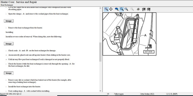

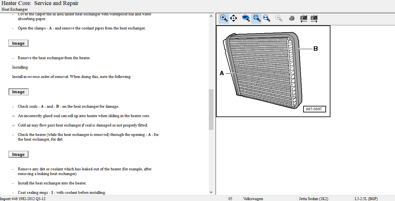

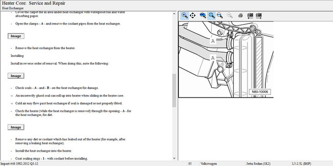

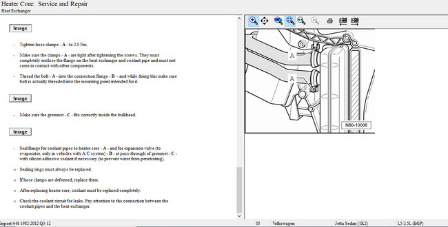

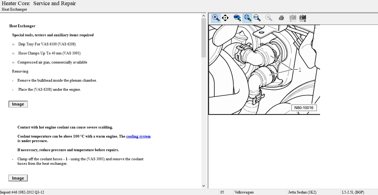

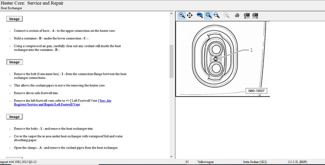

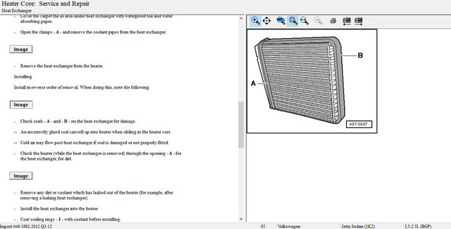

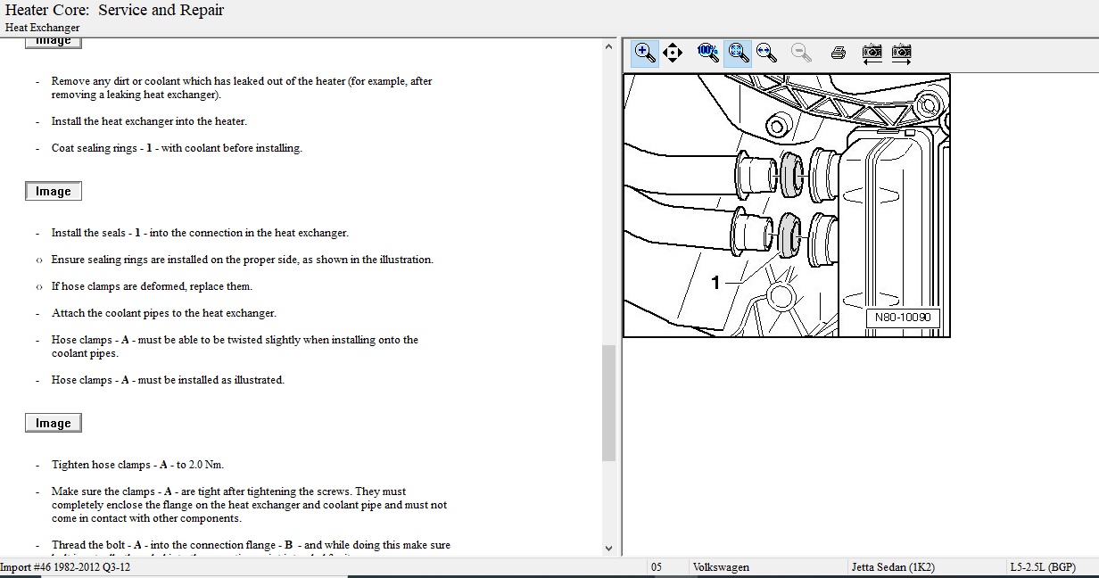

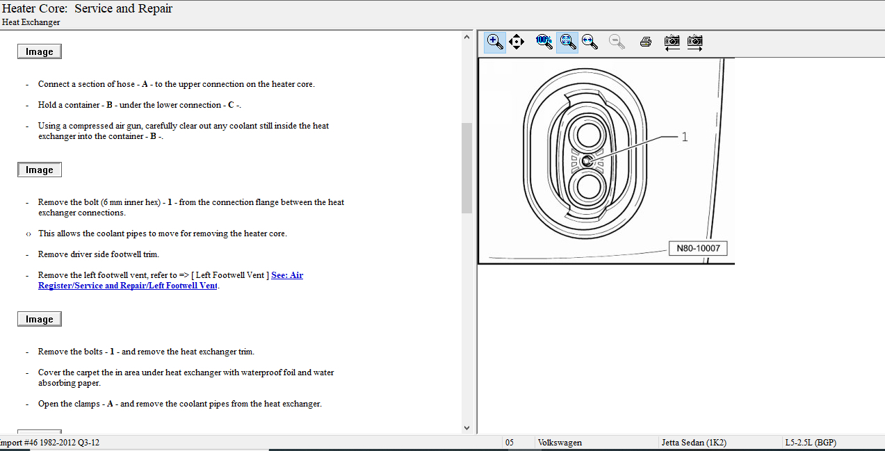

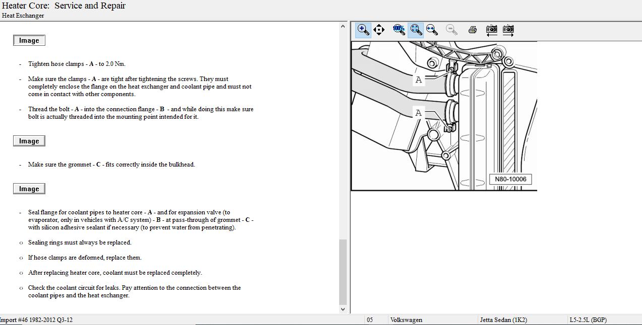

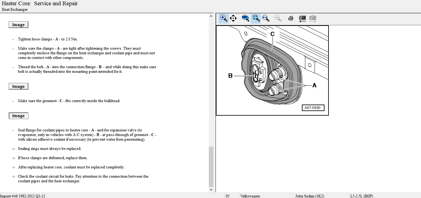

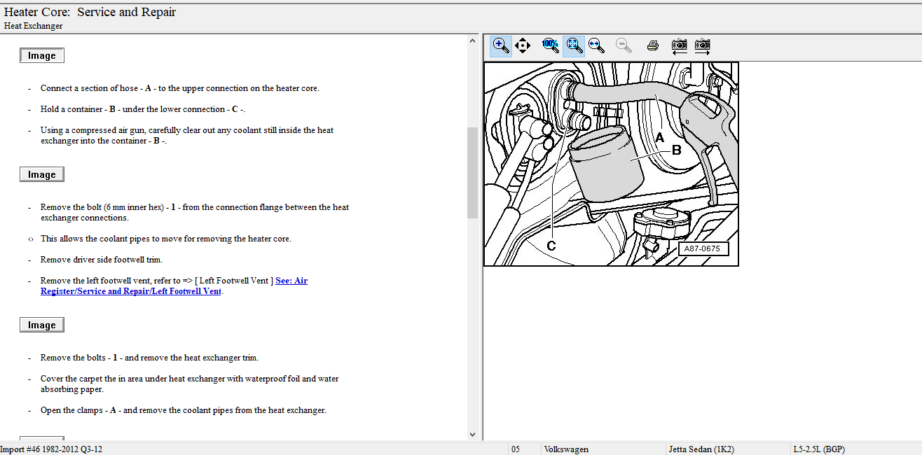

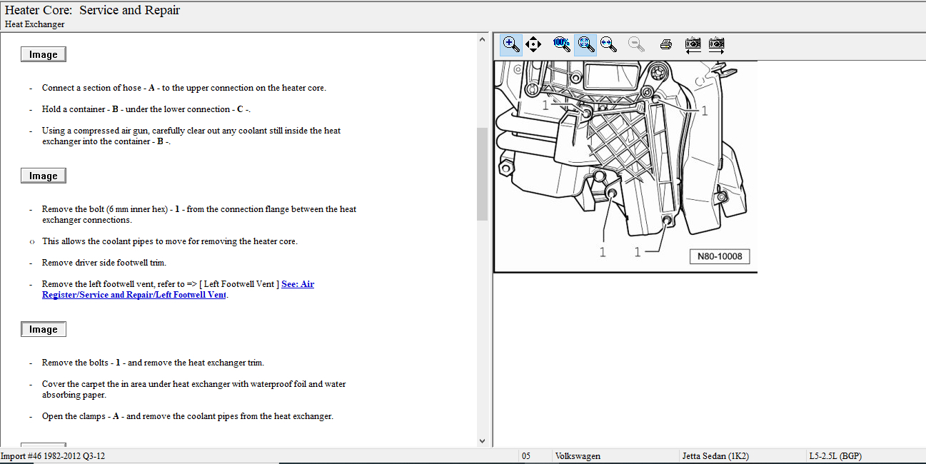

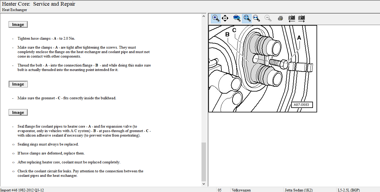

yes, it's possible from a leaky heater core, to make sure remove the surrounding carpets pressurize the system you must detect the leak because its present you can smell it.
i prefer to use liquid radiator sealant not the powder type, and use good known brand, it can seal only the small leaks. you can try.
https://www.2carpros.com/articles/replace-heater-core
Check our diagrams below how to replace heater.
let us know if you need more help.
