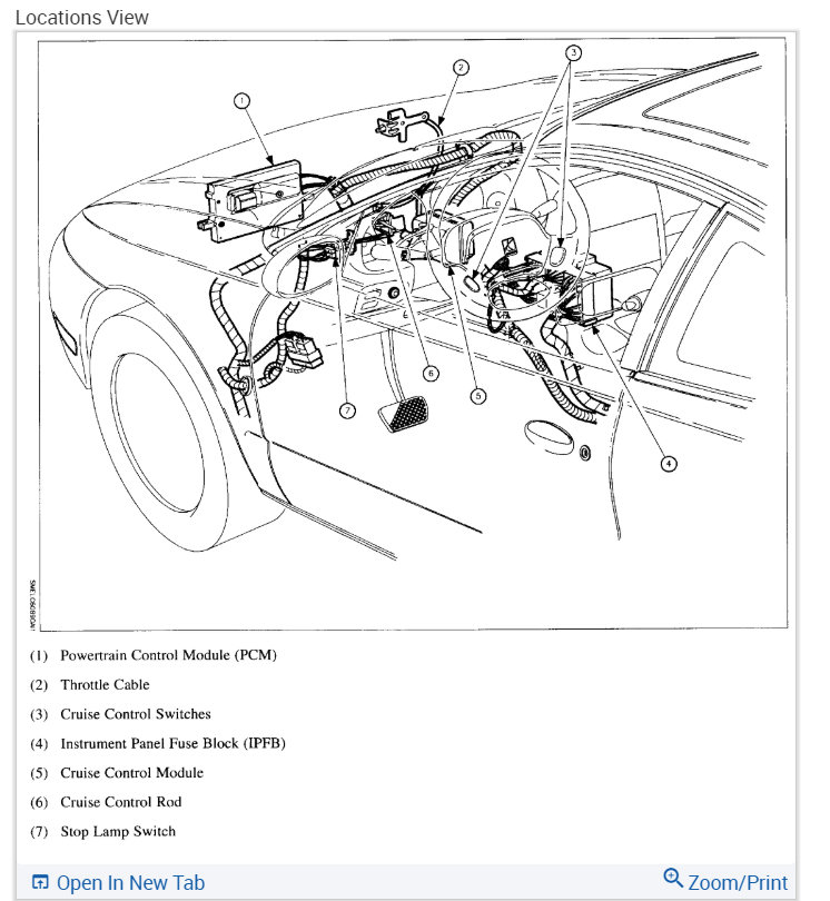

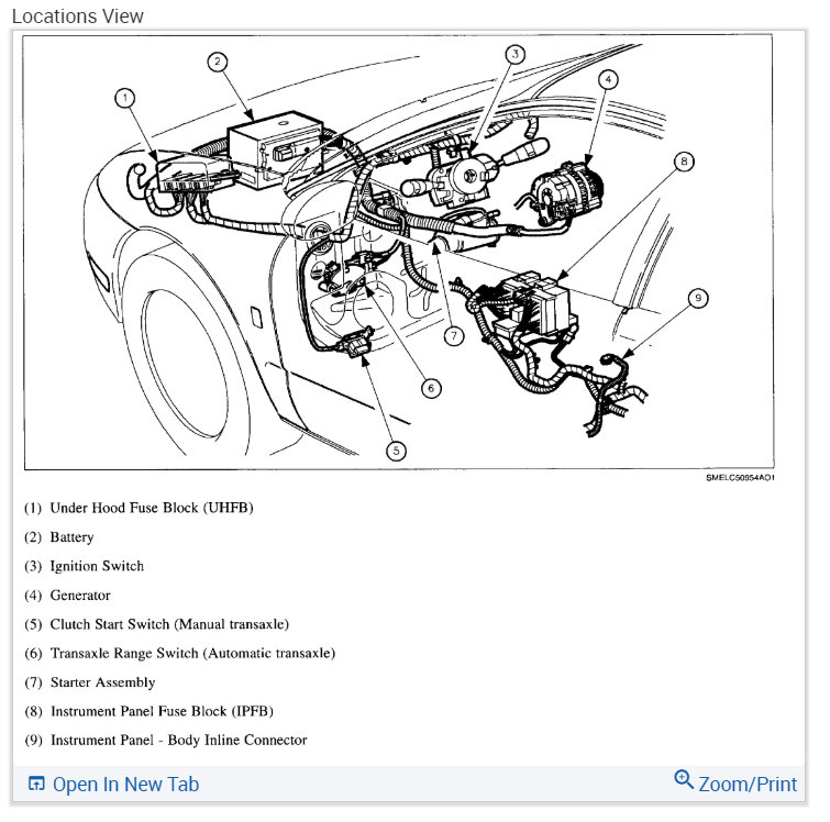

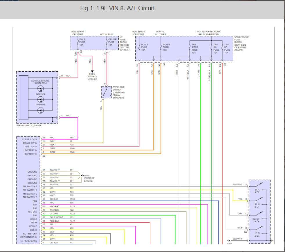

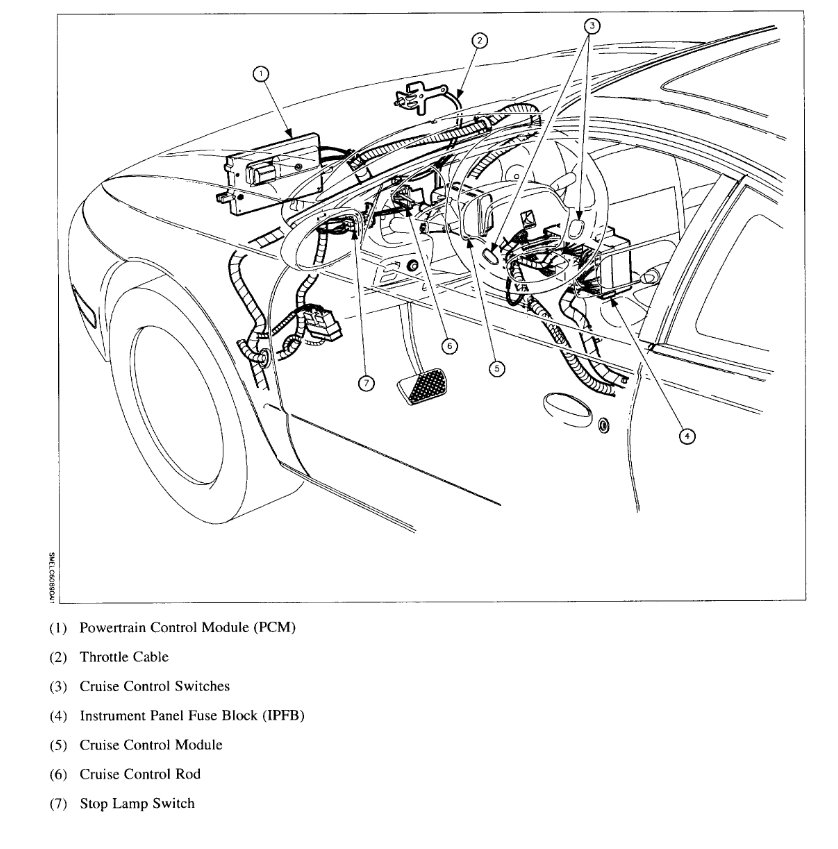

Hello Samuel,

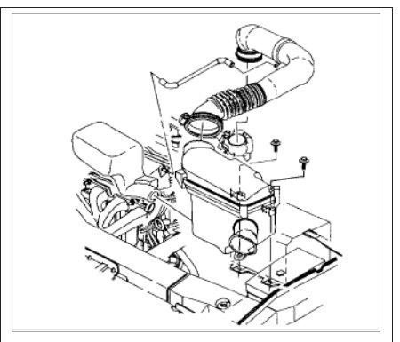

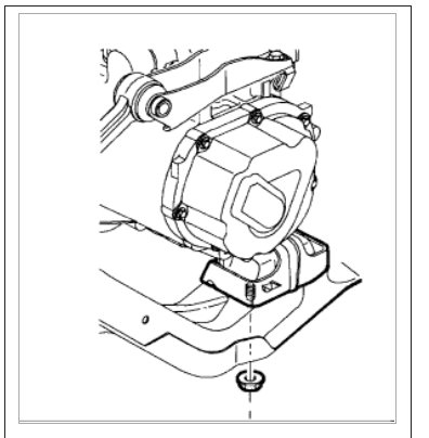

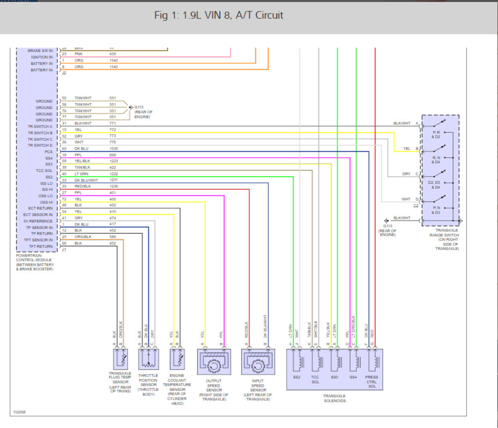

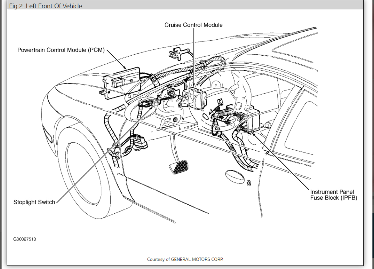

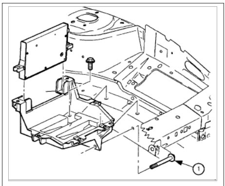

Let's test the transmission wiring to the ECM and if okay let's replace the ECM with used unit. Here are the wiring diagrams and the location of the ECM to be replaced:
Check for power at the fuses in the diagram as well. Check out the diagrams (below). Please let us know what you find. We are interested to see what it is.

I just checked all the wiring, the only thing out of the normal that I found is that the output speed sensor and the input speed sensor have a voltage of.452 volts, well below 5 volts. I'm going to check background the wiring to see if I find something out of the ordinary. But I would like to hear your opinion.

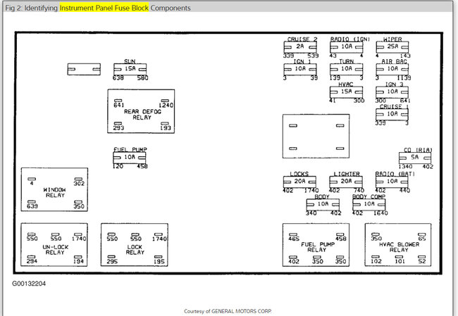

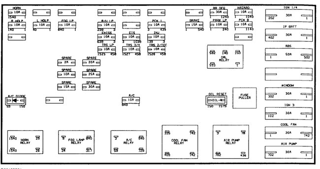

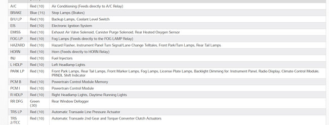

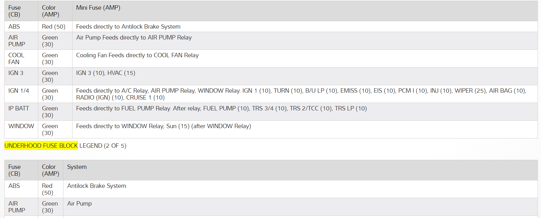

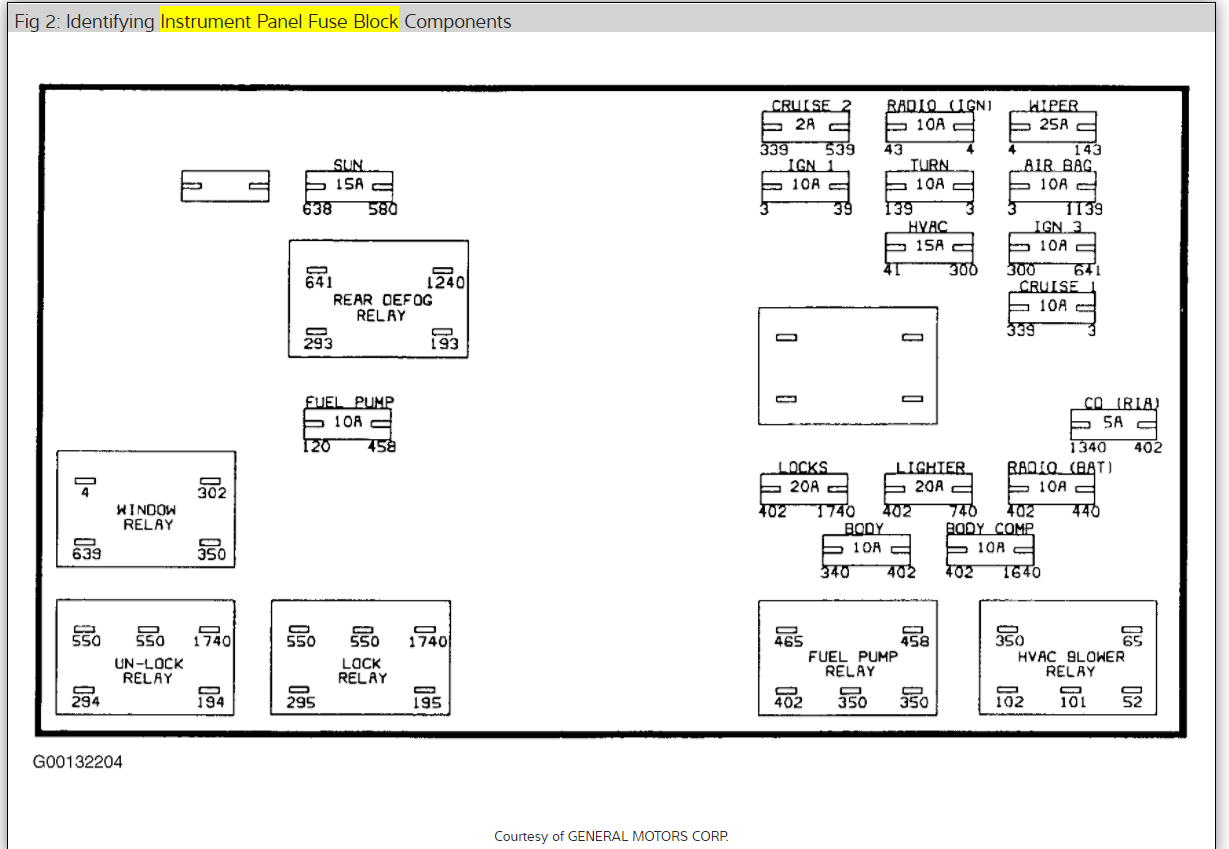

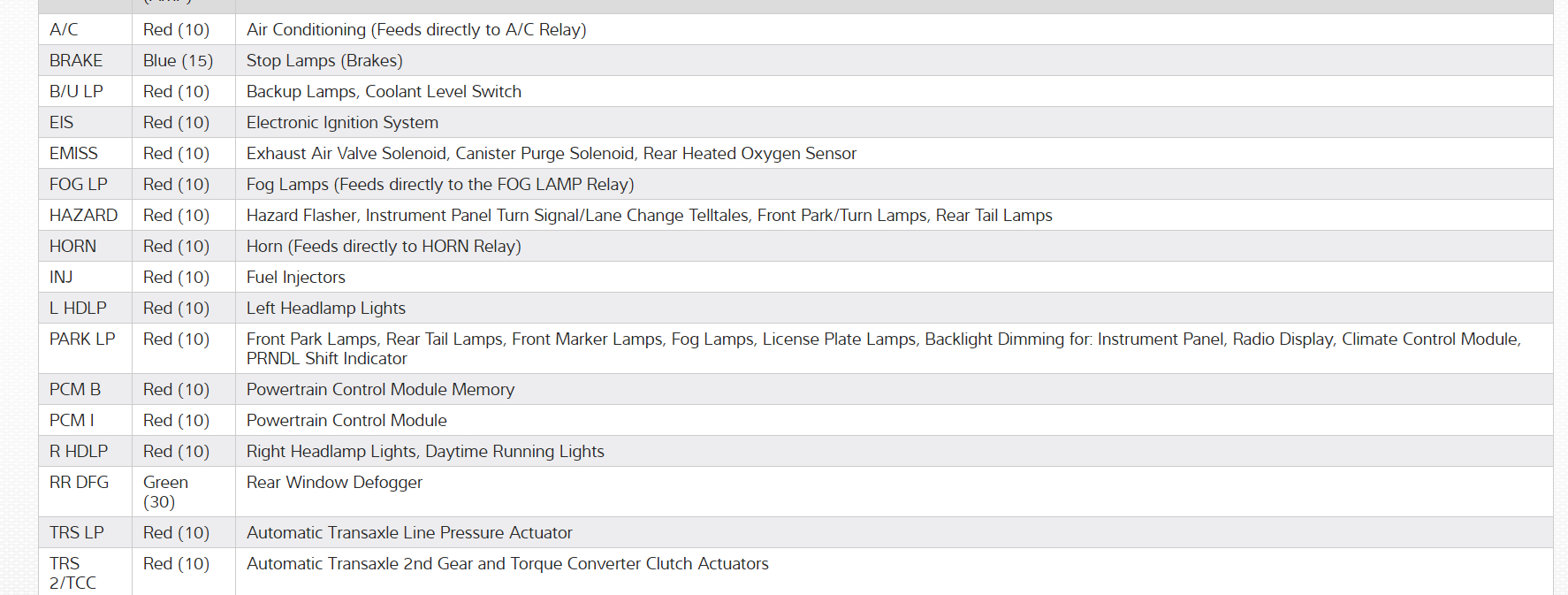

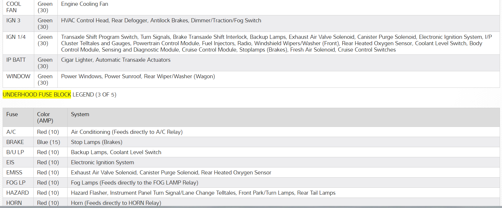

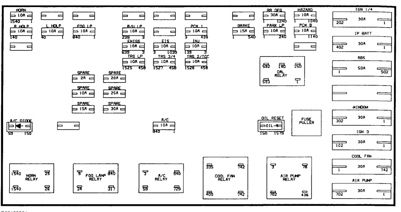

I would like to know if you have the owner's manual? I did not know there was a fuse box inside the car. I do not know what function each fuse has. I looked for the manual on the Internet but I found it.
Monday, January 28th, 2019 AT 4:23 PM
KEN L
  • MASTER CERTIFIED MECHANIC
  • 55,291 POSTS

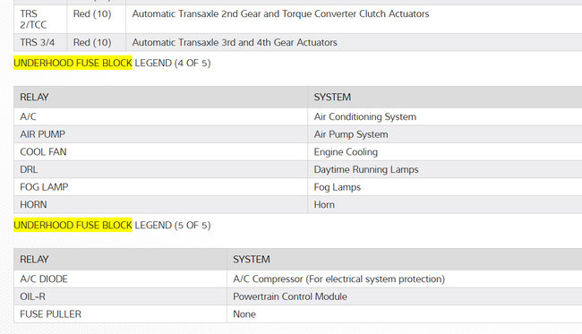

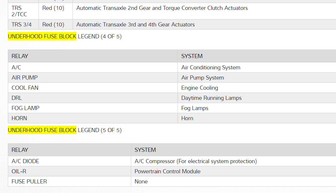

Yes, I have the fuse panel location below and the fuse identification. Here is a guide to help test for power at the fuse:

I checked the wiring again, from the PCM and that's where the 0.452 volts, voltage goes to the input and output sensors. So, if the computer sends the signal I can do?

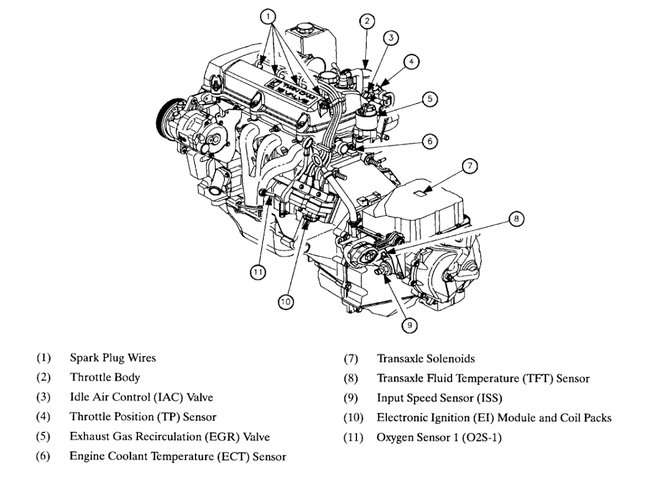

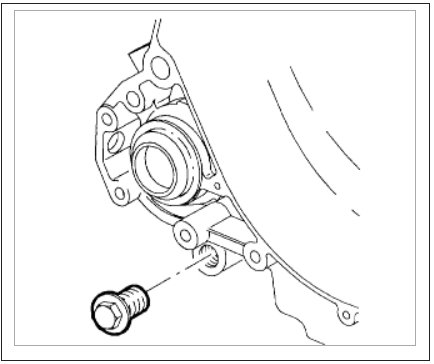

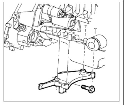

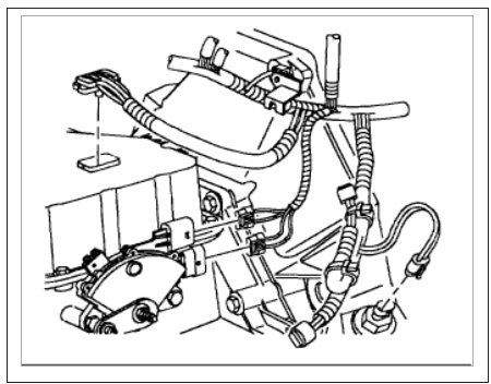

I have an idea. I remembered that a turbine (input) sensor can cause this issue. Here is its location. Check out the diagrams (below). Please let us know what you find.
Wednesday, January 30th, 2019 AT 10:12 AM
SAMUEL CASTELLANOS
  • 13 POSTS
Excuse me, but you did not tell me what number the sensor has in the diagram.
Wednesday, January 30th, 2019 AT 11:20 AM
KEN L
  • 55,291 POSTS
Oh sorry, the turbine sensor is the input speed sensor. Let me know.
Thursday, January 31st, 2019 AT 9:43 AM
SAMUEL CASTELLANOS
  • 13 POSTS
I still do not check the sensor, but I would like to ask you if for that reason the PCM does not send the proper voltage.

If you checked all wiring it sounds like the PCM is bad lets try a used or rebuilt unit to save some money. Here is the location. Check out the diagrams (below). Please let us know what happens.

I changed the PCM, I deleted the codes and the problem continues. The voltage that reaches the speed sensors is still 0.452 volts. Will you have any other idea?
