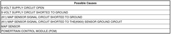

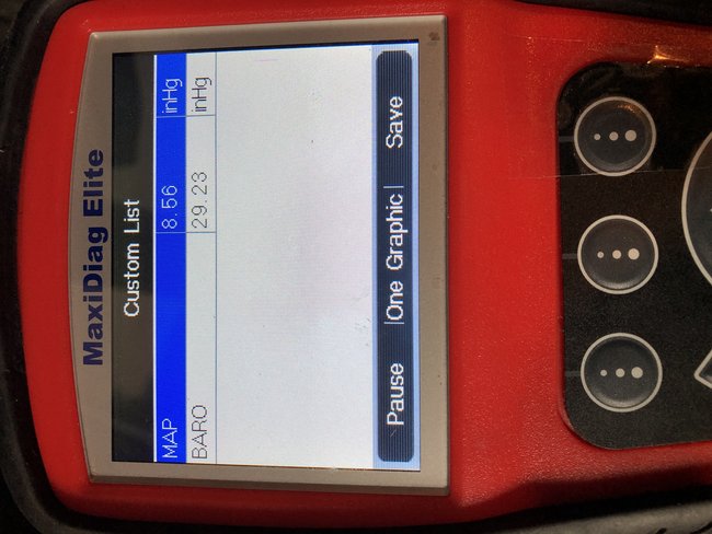

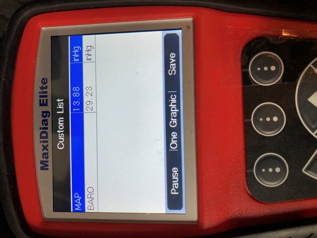

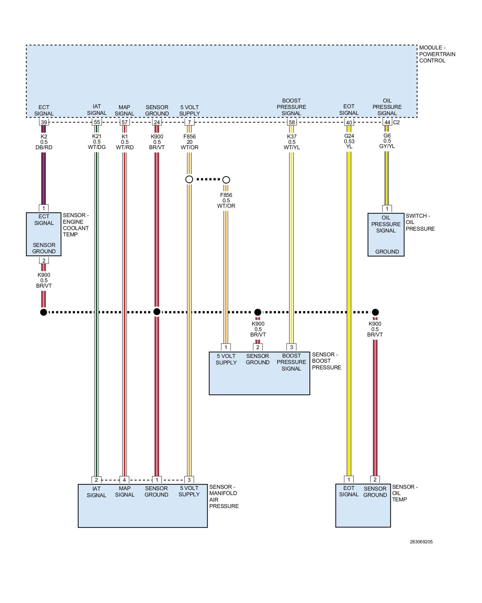

lol, am hoping it takes care of it, because all the numbers are okay as far as volts, and all am getting is that MAP sensor code all day long, even without starting the car and after the battery has been disconnected, and it's a common issue with these cars based on what I read. It better be the PCM.. crossing fingers.

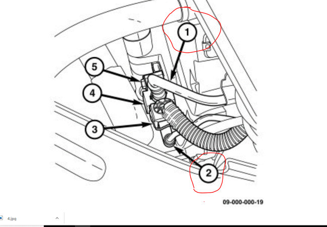

how can I check the turbo gate to see if there is any damage?
Oct 2, 2020 at 7:29 PM
  • CAR REPAIR CONTRIBUTOR
  • 110,193 POSTS
Naser,
I'm not sure I understand what you mean by gate. What harness has been cut and spliced?
Oct 4, 2020 at 4:56 PM
NASER NASER
  • 836 POSTS
no harness was cut. I just cut the plastic protector round the harness of the PCM when I was checking the wires, and I think they thought someone spliced it or patched it. the turbo waste gate.
Oct 4, 2020 at 5:28 PM
  • 110,193 POSTS
Naser, the only thing I have is wastegate solenoid removal and replacement.
I attached a pic of the solenoid below which should be mounted to the timing cover. Number 1 (wastegate hoses) number 2 (vacuum supply).
That's all I have related to the wastegate. Make sure there aren't any vacuum leaks.
