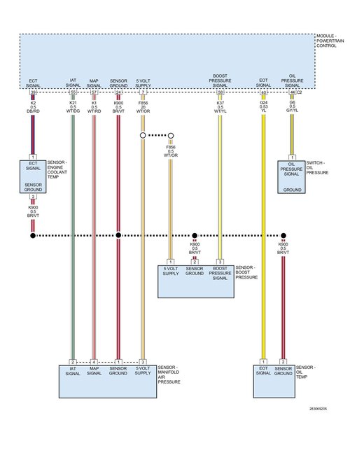

For a complete wiring diagram, refer to the Wiring Information.

thanks, I don't see any wiring schematics.

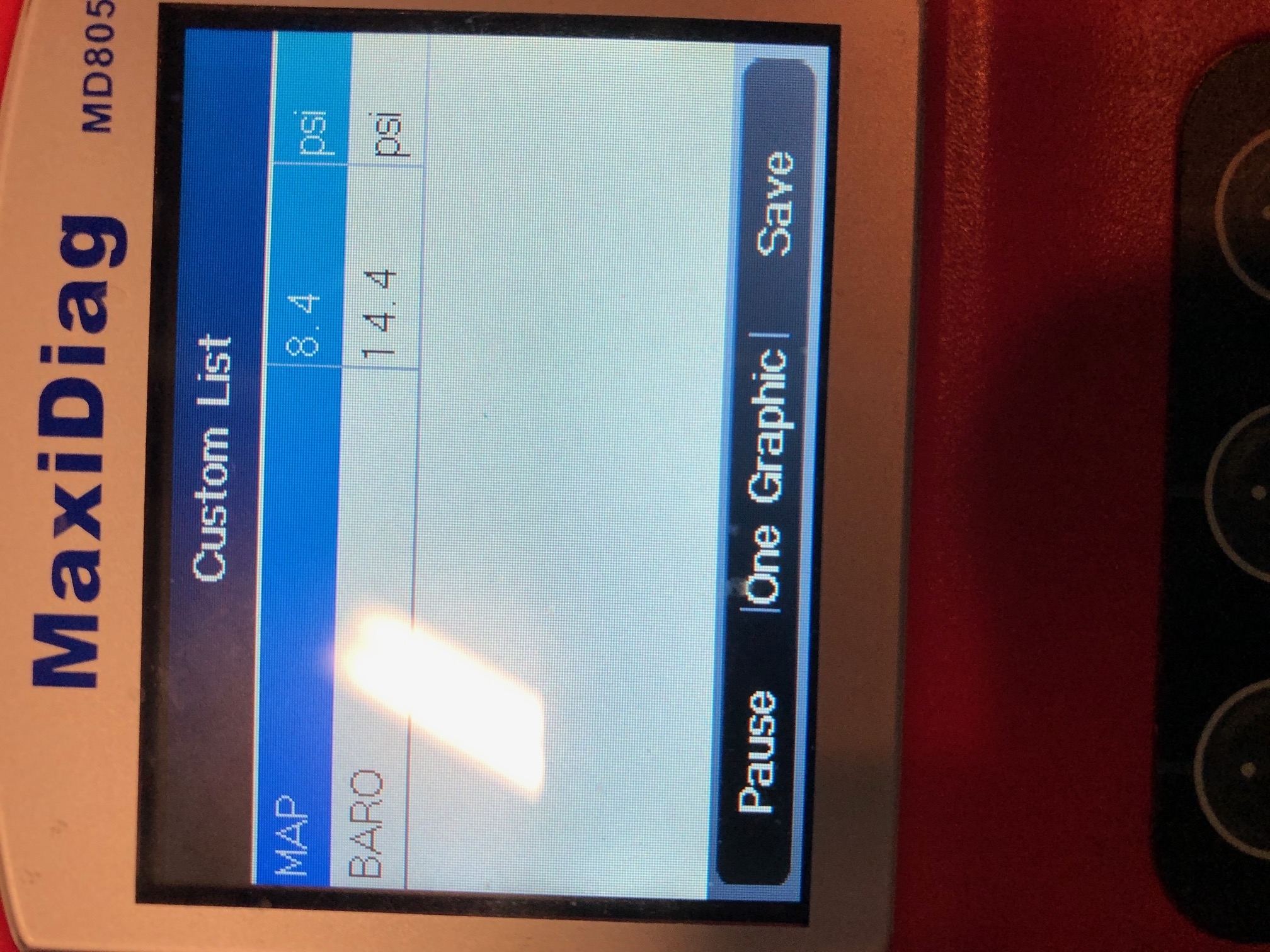

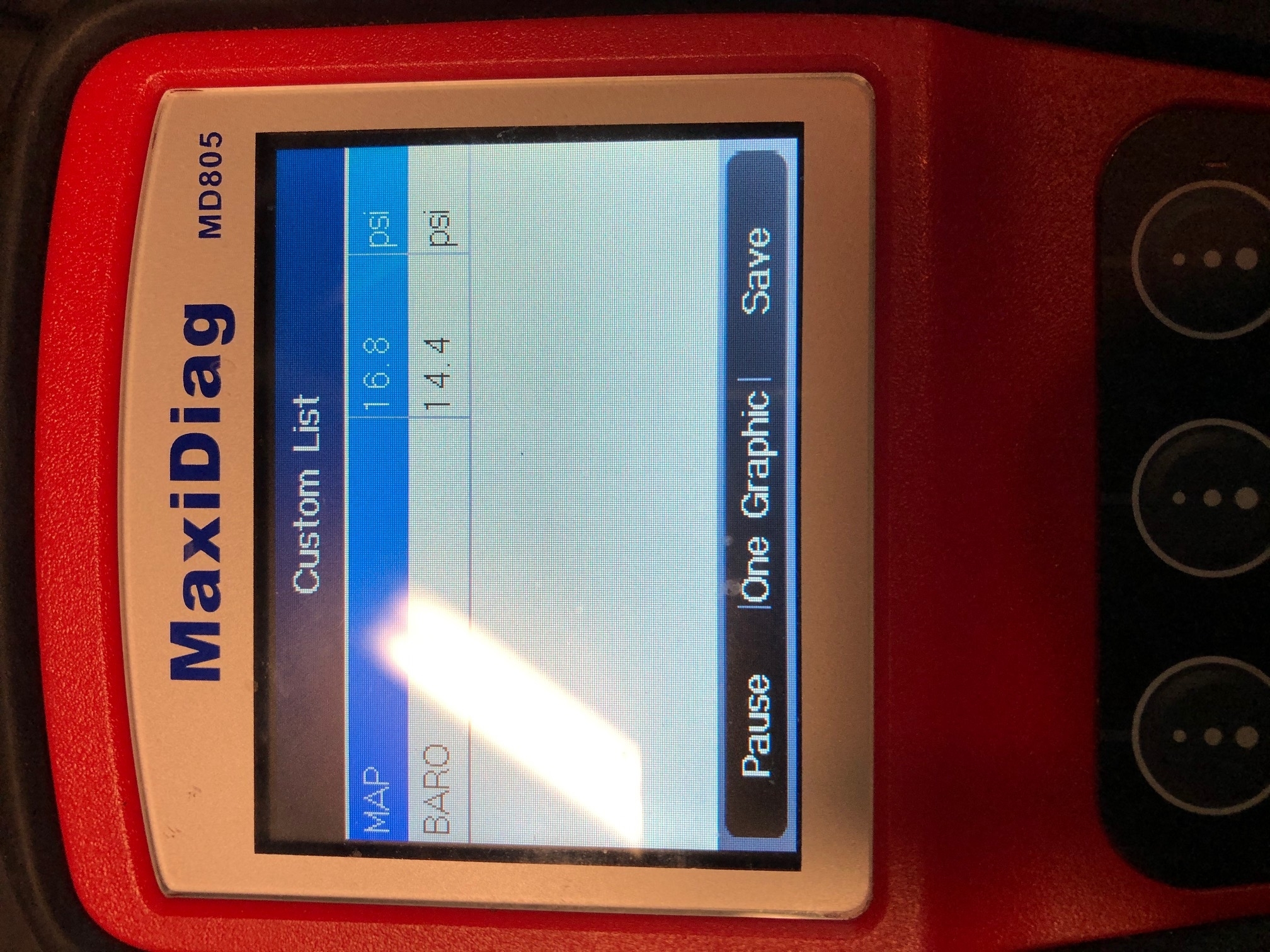

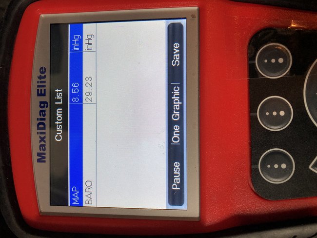

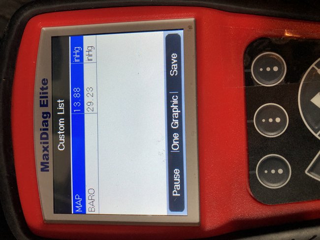

harness has signal and ground, and I have a 5 volt signal.. the first pic shows the values with ignition on, second with car running.. I deleted all codes before starting, immediately after starting the car check engine light is back with only one code; p0069.
Aug 23, 2020 at 3:28 PM
  • CAR REPAIR CONTRIBUTOR
  • 110,193 POSTS

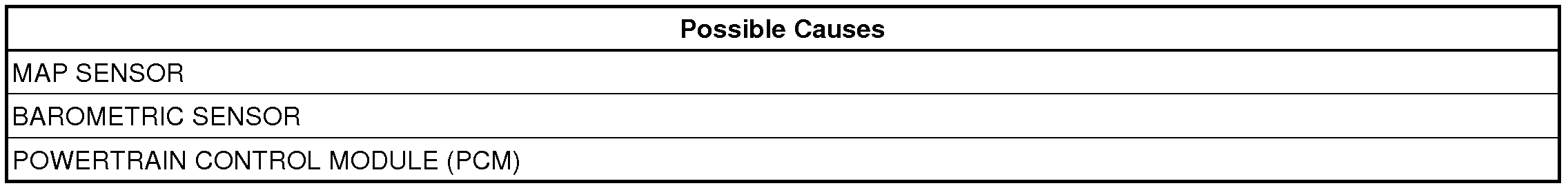

Either the MAP sensor is bad, the barometric pressure sensor, or the PCM is failing. Here are directions specific to P0069:
______________________________________-

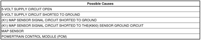

P0069-00-MANIFOLD PRESSURE/BAROMETRIC PRESSURE CORRELATION
- When Monitored:
Ignition on and during engine cranking with no Manifold Absolute Pressure (MAP) Sensor or Barometric Pressure Sensor electrical failures present.
- Set Condition:
The Power-train Control Module (PCM) performs the following rationality tests to check the Manifold Air Pressure Sensor and Barometric Pressure Sensor: At PCM power-up, the manifold pressure is compared with barometric pressure. If the two do not correlate and it cannot be determined which sensor is faulty, then this code is reported. One Trip Fault. Three good trips to turn off the MIL.
Pic 1

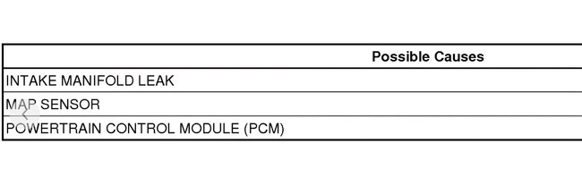

Always perform the Pre-Diagnostic Troubleshooting procedure before proceeding. See: Computers and Control Systems > Initial Inspection and Diagnostic Overview > PCM Pre-Diagnostic Troubleshooting Procedure.
Diagnostic Test
1. DTC IS ACTIVE
NOTE: Diagnose and repair any Crank Sensor DTC, Cam Sensor DTC, reference voltage DTC, air intake system restriction or exhaust system restriction before continuing with this test.
1. Turn the ignition on.
2. With the scan tool, select View DTCs and review the DTC environmental data.
Is the the DTC Active at this time?
- Go To 2
- Perform the INTERMITTENT CONDITION diagnostic procedure. See: Computers and Control Systems > Initial Inspection and Diagnostic Overview > PCM Intermittent Condition Test.
2. CHECKING THE MAP SENSOR OPERATION
NOTE: Diagnose and repair any MAP sensor or baro sensor DTCs before continuing with this test.
1. Perform the diagnostic procedure for CHECKING THE MAP SENSOR OPERATION. See: Manifold Pressure/Vacuum Sensor > Component Tests and General Diagnostics > Checking The MAP Sensor Operation.
Were any problems found?
- Repair as necessary.
- Perform the POWER-TRAIN VERIFICATION TEST. See: A L L Diagnostic Trouble Codes ( DTC ) > Verification Tests > Power-train Verification Test.
- Go To 3
3. POWER-TRAIN CONTROL MODULE (PCM)
1. Using the wiring diagram/schematic as a guide, inspect the wiring and connectors between the MAP Sensor and the Power-train Control Module (PCM).
2. Look for any chafed, pierced, pinched or partially broken wires.
3. Look for broken, bent, pushed out or corroded terminals. Verify that there is good pin to terminal contact in the MAP Sensor and Power-train Control Module harness connectors.
4. Perform any Technical Service Bulletins that may apply.
Were there any problems found?
- Replace and program the Power-train Control Module. See: Engine Control Module > Removal and Replacement.

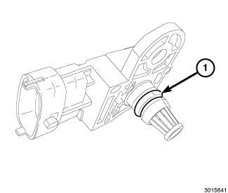

2. Remove the engine cover.
3. Remove the air cleaner body See: Air Cleaner Housing > Removal and Replacement > Air Cleaner Body - Removal.
Pic 1
4. Unlock and disconnect the wire harness connector (1) from the IAT/MAP sensor.
5. Remove the bolt and the IAT/MAP sensor from the intake manifold.
Pic 2
6. The IAT/MAP sensor O-ring (1) can be reused if not damaged.

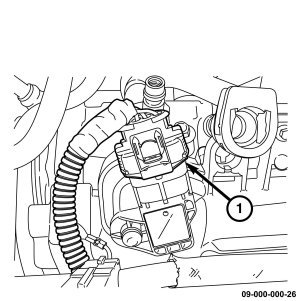

pic 4
3. Install the IAT/MAP sensor (1) into the intake manifold with the bolt (2) tightened to 9 Nm (80 in. lbs.).
4. Connect and lock the wire harness connector (3) to the sensor.

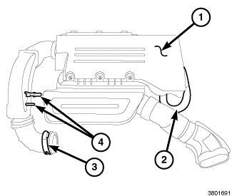

pic 5
5. Install the air cleaner body (1) See: Air Cleaner Housing > Removal and Replacement > Air Cleaner Body - Installation.
6. Connect the negative battery cable and tighten nut to 5 Nm (45 in. lbs.).

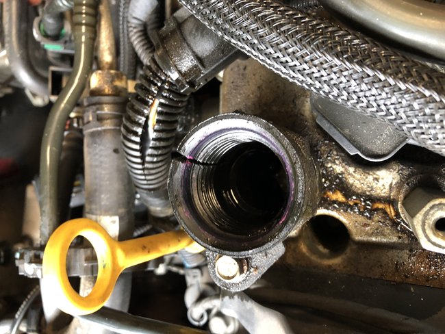

Notice this crack u think it would affect it?
Aug 24, 2020 at 10:57 AM
  • 110,193 POSTS
Is that the oil fill on top of the valve cover? If so, I don't think it would, but see if there is any air leaking around it. It's hard to tell if it leaks because the valve cover has a lot of oil on it.
Aug 24, 2020 at 2:09 PM
NASER NASER
  • 836 POSTS
I think all the oil round it is from oil leaking from it when car is running, engine also had almost 2 quarts of extra oil quarts in it, sucked that out, reset codes, didn't come back immediately and drove it around the block also didn't come back yet.very short drive, but still feels very strangled, not breathing right.
Not enough throttle, as if something is keeping throttle from opening.

Changed the MAP sensor same code, there is also some air i feel when i out my hand around the cracked oil filler cap.
Aug 28, 2020 at 3:34 PM
NASER NASER
  • 836 POSTS
what do you call that piece that the oil cap attaches to?
Aug 28, 2020 at 7:17 PM
  • 110,193 POSTS
Are you referring to the valve cover? That is where the oil cap attaches.
I hope all is well and the storm didn't cause you problems.
Aug 28, 2020 at 9:33 PM
NASER NASER
  • 836 POSTS
No, it's the oil filler cap extension/adapter, it's where the cap screws in, it's plastic.
Aug 28, 2020 at 10:02 PM
NASER NASER
  • 836 POSTS
No, storm passed and all is well. thanks
  • 110,193 POSTS
First, glad to hear you are well. That was a bad one (storm). As far as the oil filler neck, is there any way you could temporarily seal it to see if it makes a difference?
Aug 29, 2020 at 8:30 PM
NASER NASER
  • 836 POSTS
I tried with tape didn't work, tried with a towel it made some difference, but the throttle response is still very bad, not much response going up the driveway. i will have to do the p0107 testing.
Aug 29, 2020 at 8:32 PM

pic 1
Theory of Operation
The Manifold Absolute Pressure (MAP) Sensor and the Intake Air Temperature (IAT) Sensor are combined into one component. The PCM provides a common 5-Volt Supply and sensor ground that is shared by both sensors. Each of these sensors sends feedback to the Powertrain Control Module (PCM) on it's own signal circuit. The MAP Sensor is a transducer that varies resistance according to changes in altitude and atmospheric conditions. With the ignition on and the engine not running, the MAP Sensor provides the PCM with the Barometric Pressure reading. When the engine is running, the MAP Sensor signal supplies the PCM with the current air pressure within the Intake Manifold. The IAT Sensor signal supplies the PCM with the temperature of the air entering the Intake Manifold. This information is used by the PCM, along with other inputs to calculate fuel delivery, and timing needs.

pic 2

I went to put inside my garage to start on the p0107 testing and it has much better response, warm. do these pictures tell you anything? First one engine warm no throttle, second with throttle. Can you confirm to me that the res/white is the signal wire i should be checking and it should have a range of volts between 0 and 5v depending on the pressure? So far two days ago when i tested it it would only change between 0.50 and 0.80v.
Sep 5, 2020 at 8:37 AM
  • 110,193 POSTS
Naser, the pressures don't seem out of the ordinary. Have you checked to make sure nothing is disconnected at the turbo? I've seen air intakes break or come apart and cause a pressure variation as well.
If nothing is disconnected and based on your readings the map is good, I have a feeling it could be the PCM. Double check connections there as well.
Hope you are doing well.
Sep 5, 2020 at 6:27 PM
