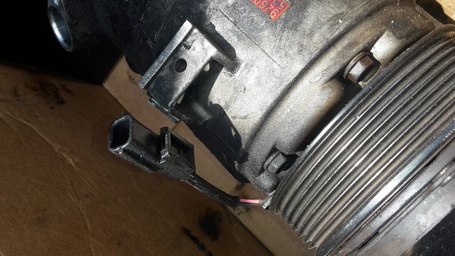

Hello, I found out it is the other wire coming from the car that hooks into the compressor. I am sending a picture so you can see somewhat I mean. Someone told me to get a pigtail but I do not know the name of it. Can you tell me the name of part I will need? I have a piece of tape on it but it keeps coming loose. Well, I tried add picture, but it would not work.

I tried again, and it uploaded. I wanted to know the name of part that hooks off into that part in the picture.

That wire that is unhooked goes to the AC clutch. With it disconnected the AC will not function. There should be a connector that plugs into it right in the area.

I know, I was asking what is the name of that connector that plugs into the AC clutch? It has a shortage in it.

There really is not a name for it. It is simply the AC clutch circuit. There would be a connector number but it is not a part number or usable to locate a part. Shorts are generally easy to locate. However, it might be easier to simply run a new wire if it has shorted, although I would rather find the problem as it could involve more than one wire shorting out.
