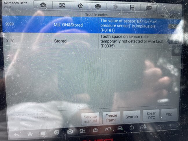

CODE P0193 all that was left?
STEVE W.
  • 15,608 POSTS

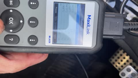

OK look at the PIDS 602 and 603. One is the pressure the system is calling for, looks like 6467? The other is the pressure the sensor sees, 4748. I would test it against a mechanical gauge, if the gauge matches the sensor then it's a bad pump if the gauge show the requested pressure then the sensor has an issue, probably something in the 5 volt feed as it shares it with the crank sensor which is what is throwing the tooth code. If you have a scope or a way to watch the 5 volts line connect at the crank sensor and see if it drops out if the wiring is moved or as it heats up. Because the pressure sensor uses that same 5 volts it could be what is actually causing the fuel issue if the voltage isn't steady.

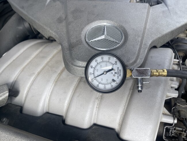

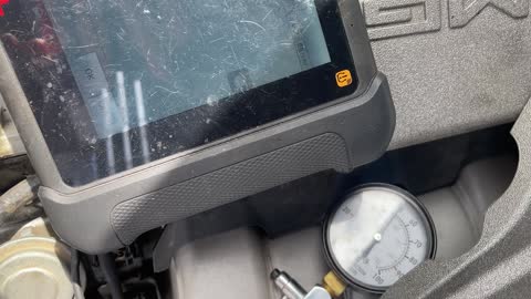

BHAMDOC1
  • 193 POSTS

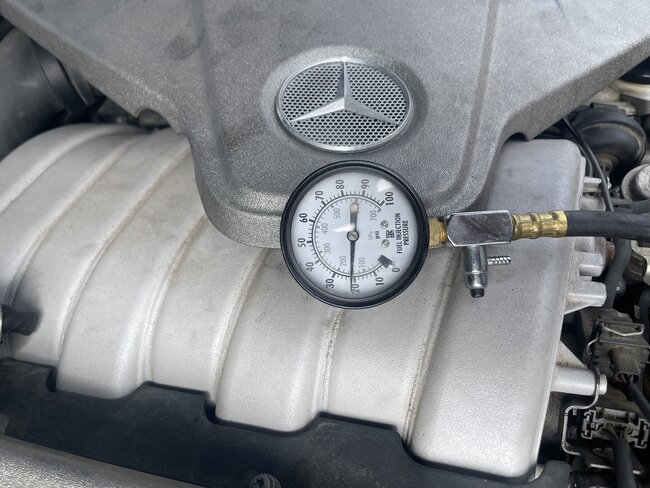

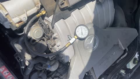

I checked the pressure. First reading is when ignition on, second one when started, Stayed around 40, 5 minutes later was around 35-38, when reved up goes to 40 again. After few minutes went to 32-34 and sometimes goes up to 38 or so. Now its hovering around 30. Will update again once it dies
Tuesday, February 17th, 2026 AT 9:34 AM
BHAMDOC1
  • 193 POSTS

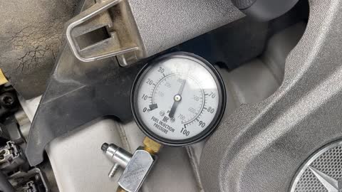

Hovering" around 28-35. Now it wont stall lol. I shut it off and started it back up gauge was at 52, then idles down to 34.
Tuesday, February 17th, 2026 AT 9:44 AM
BHAMDOC1
  • 193 POSTS
I left it xonnected and cane back an hour after and found it at 50 psi with everything off, so the injectors are not leaking. But am not sure what is the range for the fuel pressure while running. I doubt the 30s is the right range and may indicate a weak pump
Tuesday, February 17th, 2026 AT 10:53 AM
BHAMDOC1
  • 193 POSTS
Cane back an hour after to see where the pressure is and was holding at 59 when off
Tuesday, February 17th, 2026 AT 11:03 AM
BHAMDOC1
  • 193 POSTS
Cane back an hour after to see where the pressure is and was holding at 50 when off. Now running and holding at 50
Tuesday, February 17th, 2026 AT 11:32 AM
BHAMDOC1
  • 193 POSTS
Still idling and pressure at 50. Started it 3 times and its fine. Not sure. Now check engine light went off on its own ugh

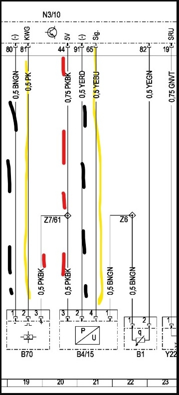

I would expect 50 to be about normal, but I would also look at the 5 volt signal to the pressure sensor. If it were lower than 5 volts the sensor would read wrong and tell the ECU the wrong info and give you the wrong pressures. Might be worth it to find the pump power feeds and test them without the control module adjusting them.
Tuesday, February 17th, 2026 AT 3:10 PM
BHAMDOC1
  • 193 POSTS
I rechecked the harness to the fuel pressure sensor and it reads 4.87v
Wednesday, February 18th, 2026 AT 7:24 AM
STEVE W.
  • 15,608 POSTS
That should be OK, the question is does it stay at that voltage or does it drop out while the engine is running and cause the issues you are seeing with the crank code and fuel pressure sensor because they share that 5 volt feed.
Wednesday, February 18th, 2026 AT 11:02 AM
BHAMDOC1
  • 193 POSTS
I guess ill need to find a way to probe it while running right? And not disconnect ot and measure it while running. Isn't it supposed to vary based on fuel needs and ecm pulses? Or it should be constant?
Wednesday, February 18th, 2026 AT 11:40 AM
STEVE W.
  • 15,608 POSTS
The 5 volts stays constant. The system controls the pumps via a PWM signal. The sensors however get a solid 5 volts on the pink and black and a ground. They only share the 5 volts. If it is dropping out or even just dropping lower it will change the signal back to the ECU.
